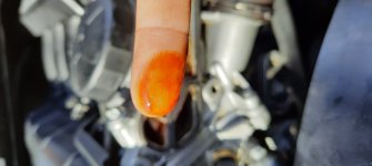

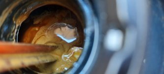

So the other morning i checked my water level on my car and i saw oil mixed with the water.
First thing that came to my mind is the Head gasket.But i realized that driving back from
Cape Town(i stay about 200km outside cape town),the car never got hot or overheated.

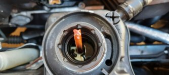

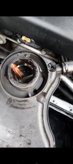

Anyone had the same problem?so i replaced my oil cooler which was the easiest.i checked
the oil by the oil filter housing and that was ok.i still need to flush and test cooling system.
