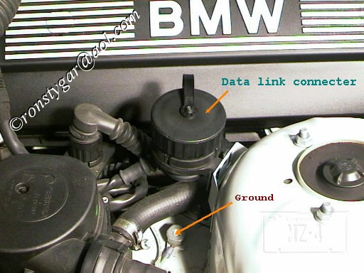

Not quite correct dude. E46 is OBDII onwards, my 95 328 has a mixture of OBDII and ADS, I just spent the evening stuffing round with the computer, and the DME is OBDII.
I have daignosed E36 M's with the round 20 pin connector using OBDII.
The confusion I think is coming in here whereby one assumes that the round 20 pin port found on most of the older BMW's, including older E46's are ADS, this is wrong, and very far from the truth.
The E36 had some OBDII compatible cars, early E46/E39's are all OBDII, EVEN WITH the round connector, this is not an assumption, This is fact....
Or, have i got the question wrong here completly ?
