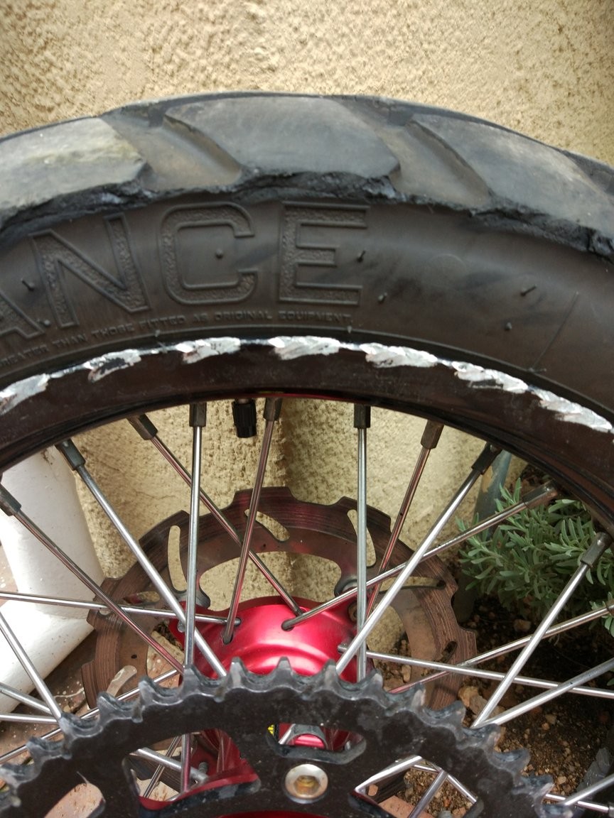

I’ve wanted to attempt this DIY for quite some time, and I am excited to share with everyone. Although this DIY was done with Motorcycle rims, the principals remain the same If someone would want to attempt it with car rims.
Objective:
For this project I wanted to do a quality, lasting job, but with minimal resources and basic tools. The objective was to refurb the wheels, ie removing any curb rash and scratches, and repainting. Finishing up I wanted to fit a new set of rubber and balance.

• Removing the tyre from the rim. Make sure the tyre is warm (leave it out in the sun for an hour or so) and don’t forget to use soap as per the Youtube videos. Also Rim protectors are essential.

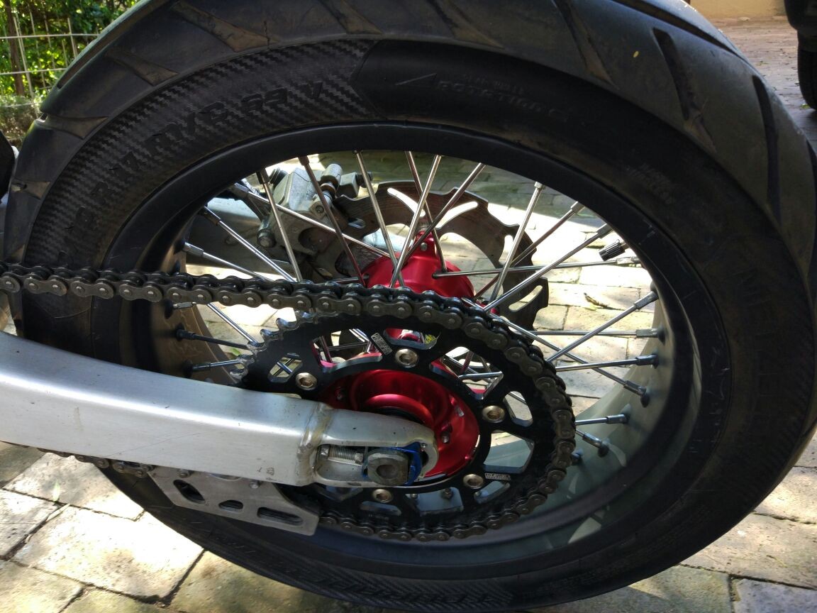

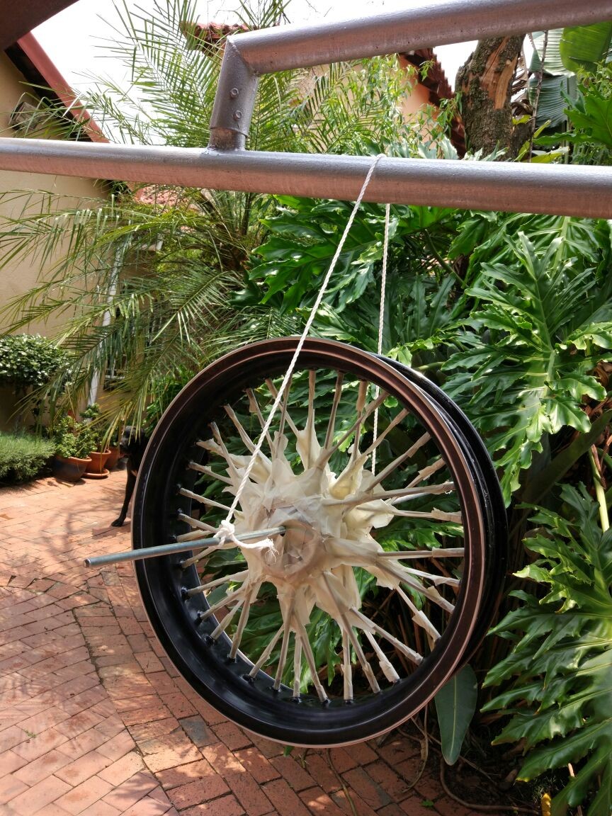

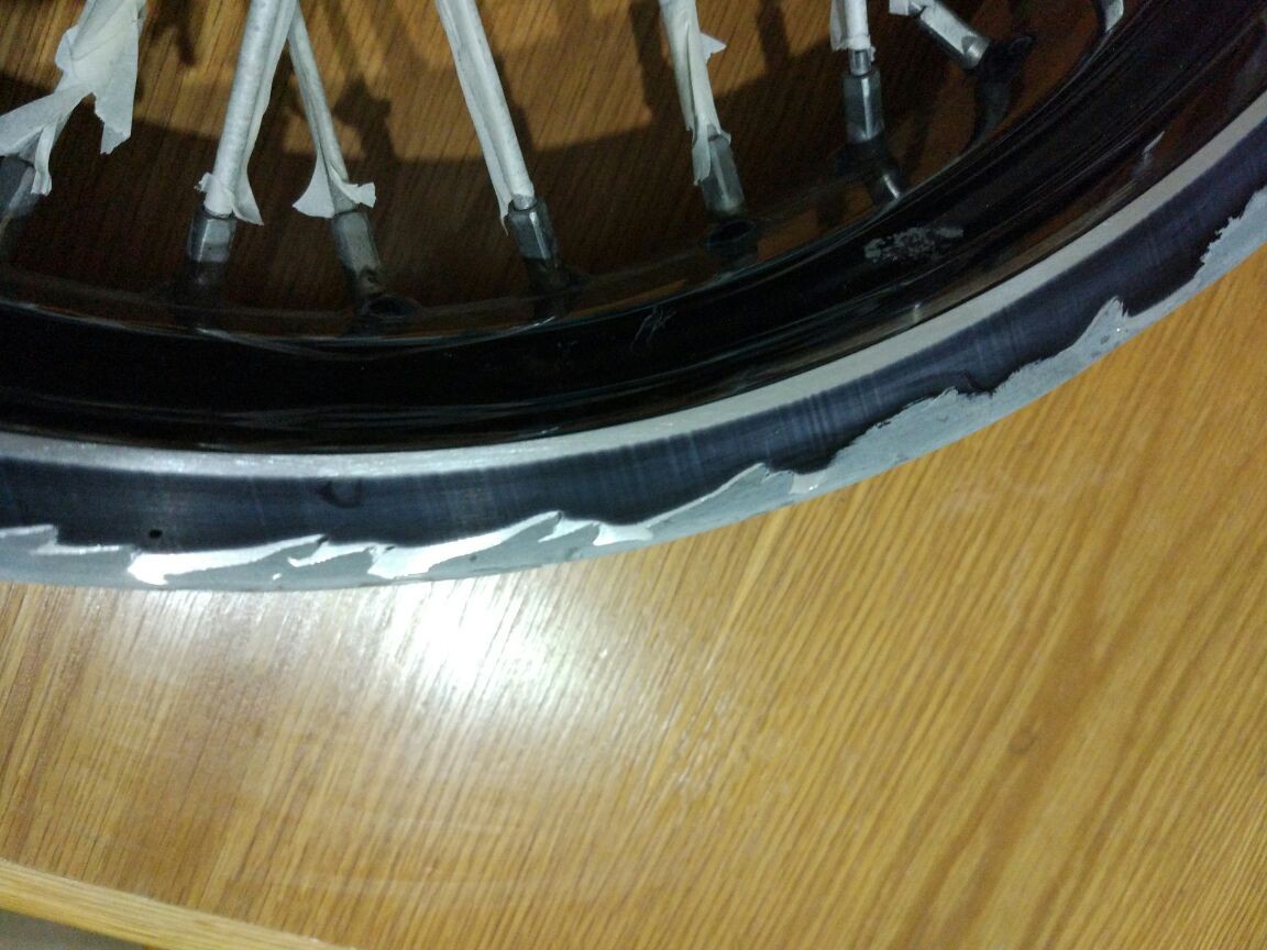

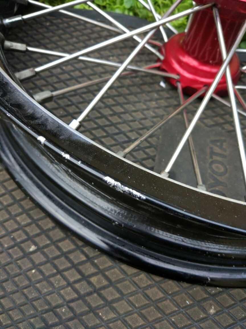

• Sand down curb rash and scratches. My front wheel wasn’t in such a bad shape and all of the damage could be removed with sanding. The rear rim was really badly damaged due to the chain slapping the rim (not being tension properly by the previous owner). I used the steel putty to touch up the damage and sand it down.

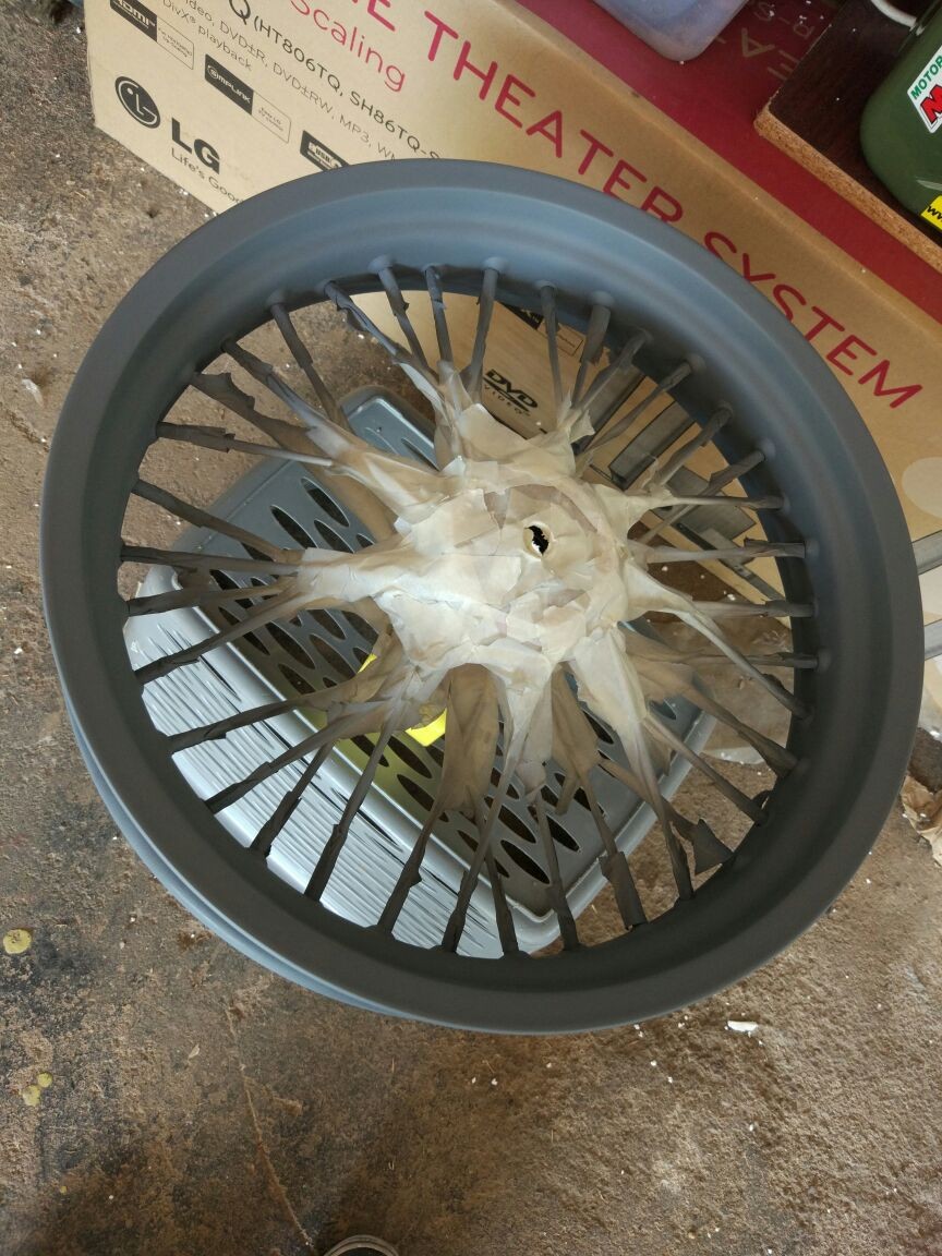

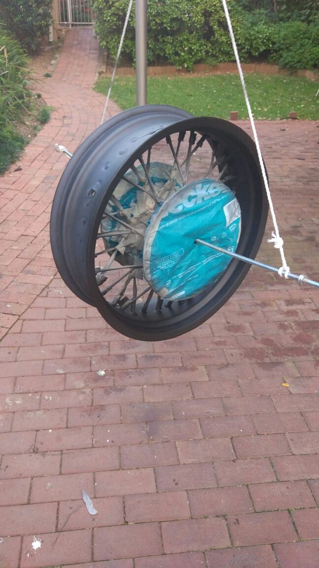

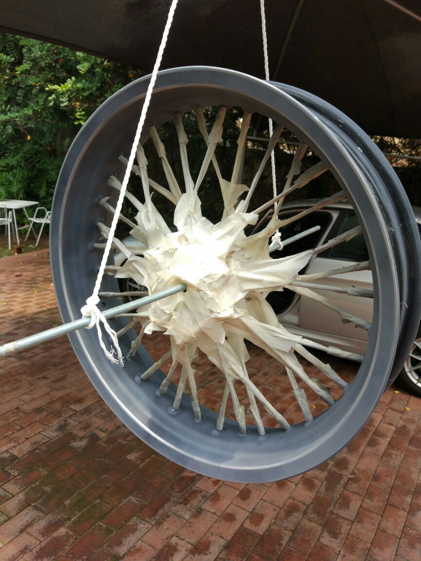

• Clean, Mask and Prime. This is a time consuming job, but essential to get a good finish. I removed the balancing weights and cleaned the rim with the acetone prior to prime. After this I used a piece of rod and rope to hang the rim up (felt this was the best way to paint, without anything touching the rim). Apply light coats, and allow enough time to dry between coats.
• Paint: Clean with acetone, and start applying light coats, with enough time to dry between coats.

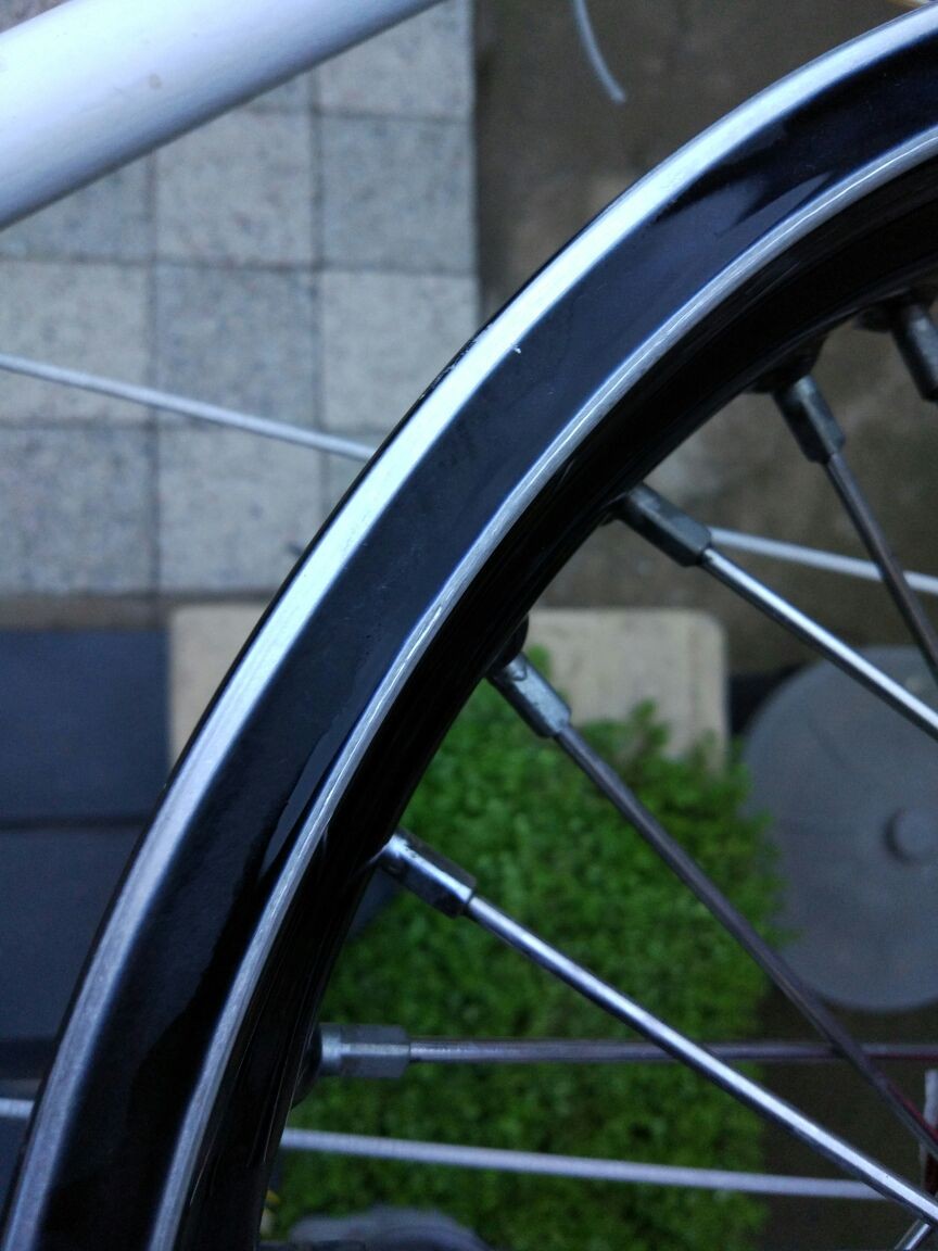

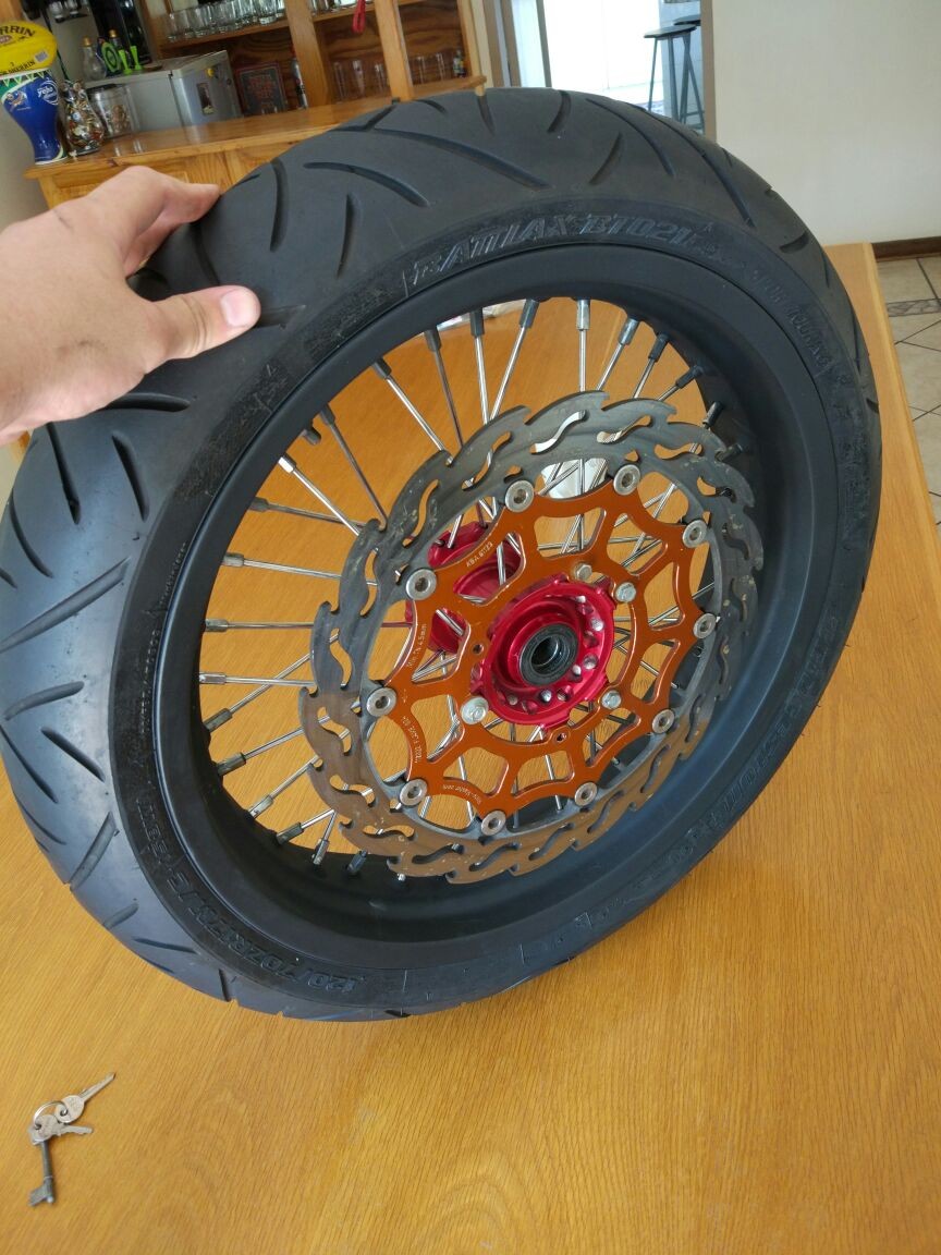

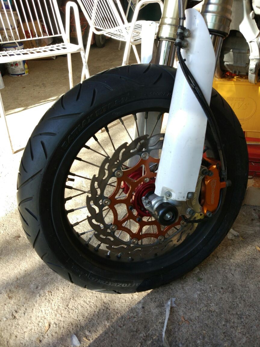

• Fit new tires and balance. I re-used the old weights

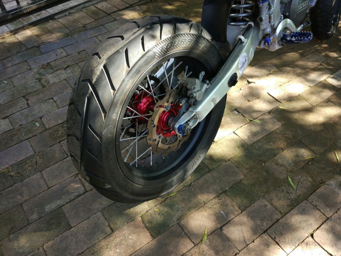

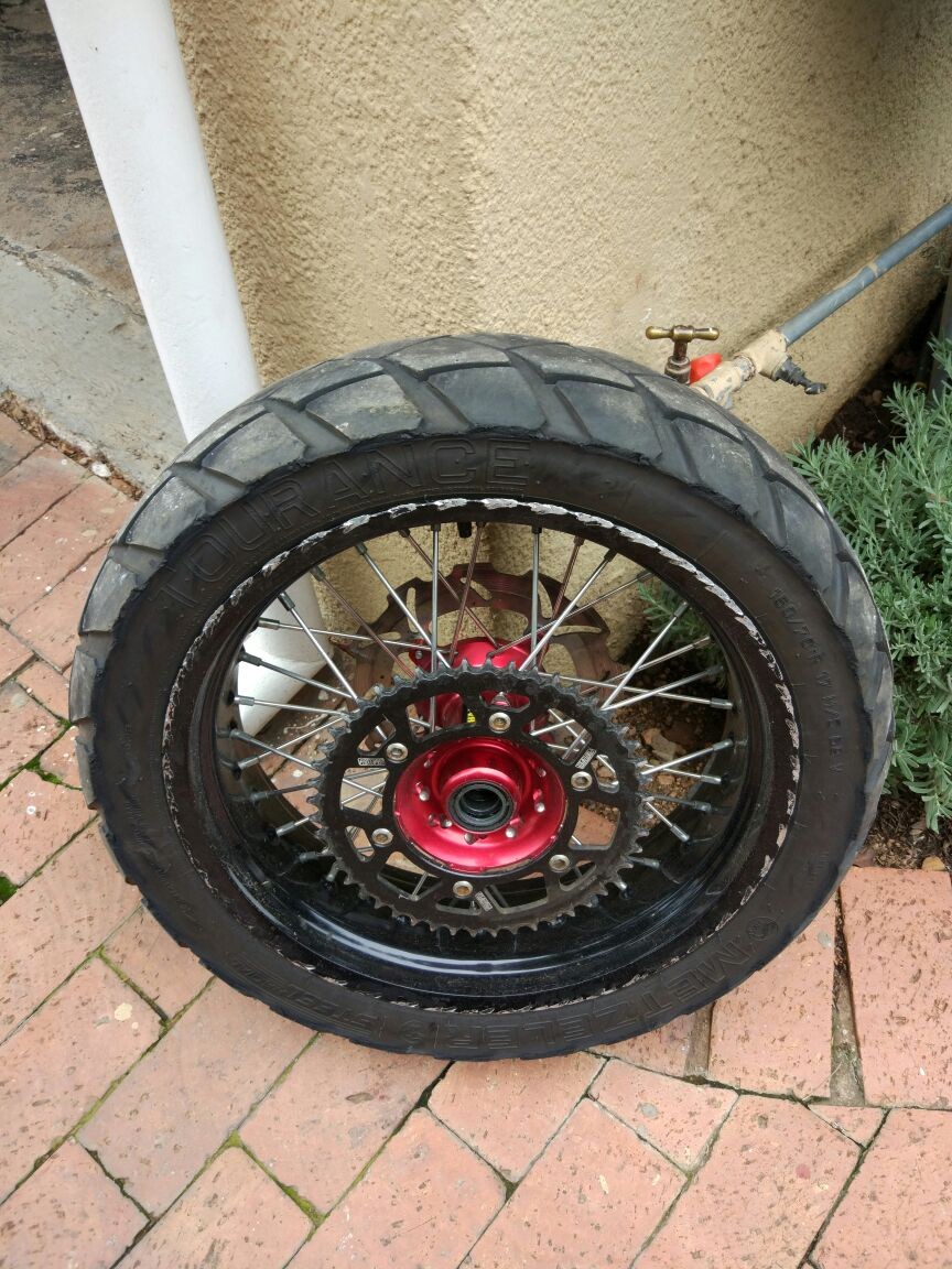

BEFORE & AFTER PICS: (Please keep in mind I still need to wash the bike and rims, In some pics the matte finish looks scratched, I can assure you its just dirty, Ill add some more pics once this is done)
Rear:
Front:
Other Random pics of Project in progress, sanding, masking, priming, etc:

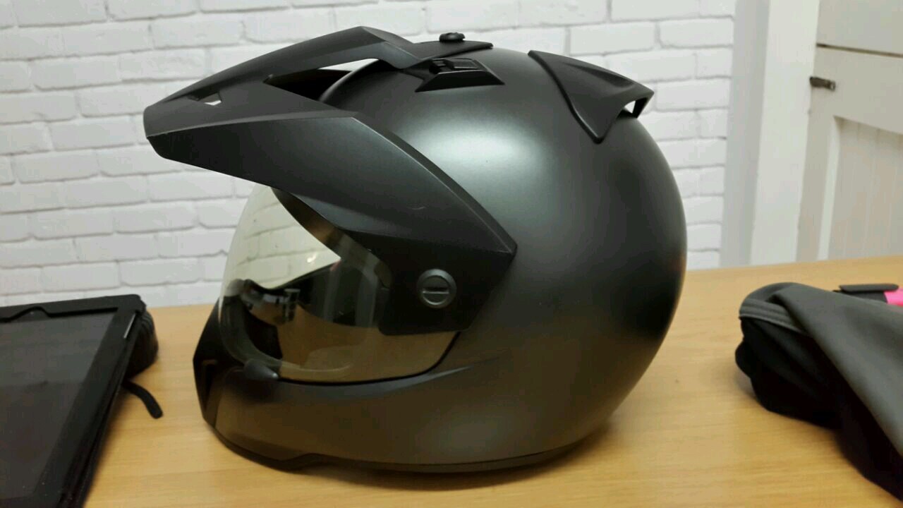

The helmet was in pretty bad shape, the inners were moldy and to replace them would be too expensive, so I sold it on Gumtree. I really like the MX/Enduro type helmet, so I got a white helmet to compliment the "Yamaha blue/white look"
BMW Carbon Helmet, looks good on the outside, but really needed attention on the inside.
Replacement helmet
