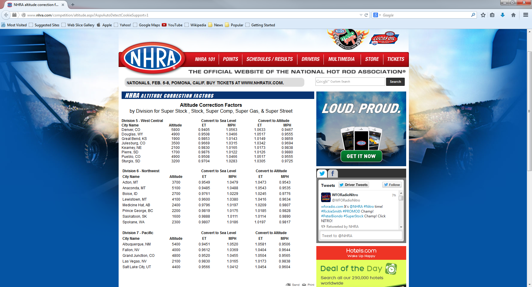

So the NHRA know a little about drag racing. Just a little. Been doing this for what 60 years at different locations all over the USA. They have many divisions, leagues, etc. In order to neutralise the effect of running at different altitudes they have designed a correction factor for the times & exit speeds. Remember I Sherwin did not do this. Little men in white coats with multiple PhD's did this. IF anyone doesn't agree with it, I suggest you mail the NHRA and put in a strongly worded disagreement.
http://www.nhra.com/competition/altitude.aspx?AspxAutoDetectCookieSupport=1
Johannesburg is between 5500-6000ft above sea-level depending where you are. Tarlton is actually just on 6000ft. So we shall use Denver Colorado as our reference:
Division 5 - West Central
Convert to Sea Level
Convert to Altitude
City Name Denver, CO
Altitude
5800
To convert to sea-level you mutiply
Also to note:
Supercharged, turbocharged, or nitrous-oxide Comp Eliminator vehicles (i.e. AA/A, AA/AM, AA/AT, BB/A, BB/AM, BB/AT, CC/A, CC/AT, DD/AT, AA/AF, BB/AF, H/D, and I/D) use half factor.
Ok so the best N54 we have run to date up here ran 12.2 @ 191 with s/w & DP's. That's it. Let's use the NHRA factor to compensate that to sea-level.
To get sea-level ET you multiply ET by 0.9405. But you use a half factor for FI cars. So that's 0.97025
12.2 x .97025 = 11.837
To get sea-level exit speed you multiply trap by 1.0563. But you use a half factor for FI cars. So that's 1.02815.
191km/h x 1.02815 = 196.37km/h
11.837 @ 197.37 is the corrected time for a car with DP & software and it ran on runflats.

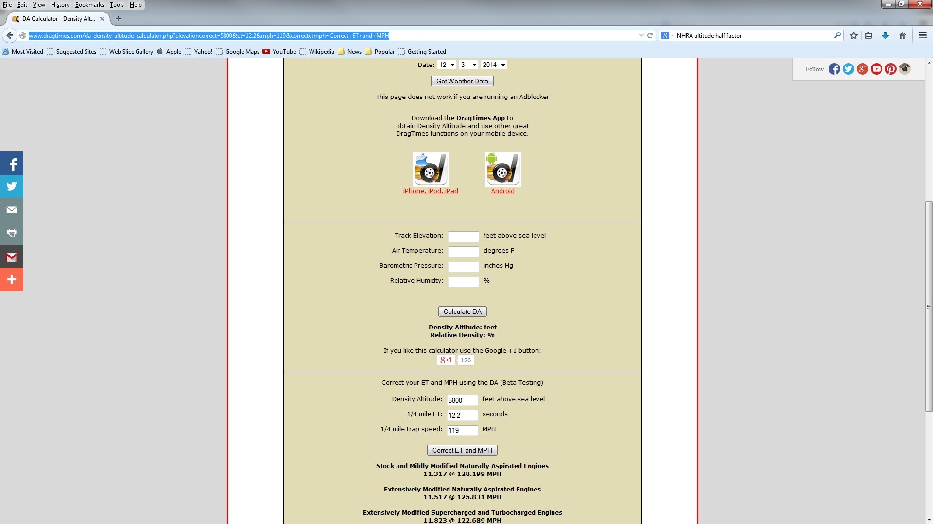

Drag times has a calculator where you enter the DA & it calculates the corrected ET for this and even has different times for NA & FI cars. Here's what it corrects:
http://www.dragtimes.com/da-density...=12.2&mph=119&correctetmph=Correct+ET+and+MPH
Also 11.8 @ 196.
So Dean, Kish & other guys that want to compare times. Just be sure to factor in that there is a half a second & 4-5km/h difference in sea-level to altitude for the N54. And that's not the world according to Sherwin. That's from the NHRA.
Thank you for your time.
