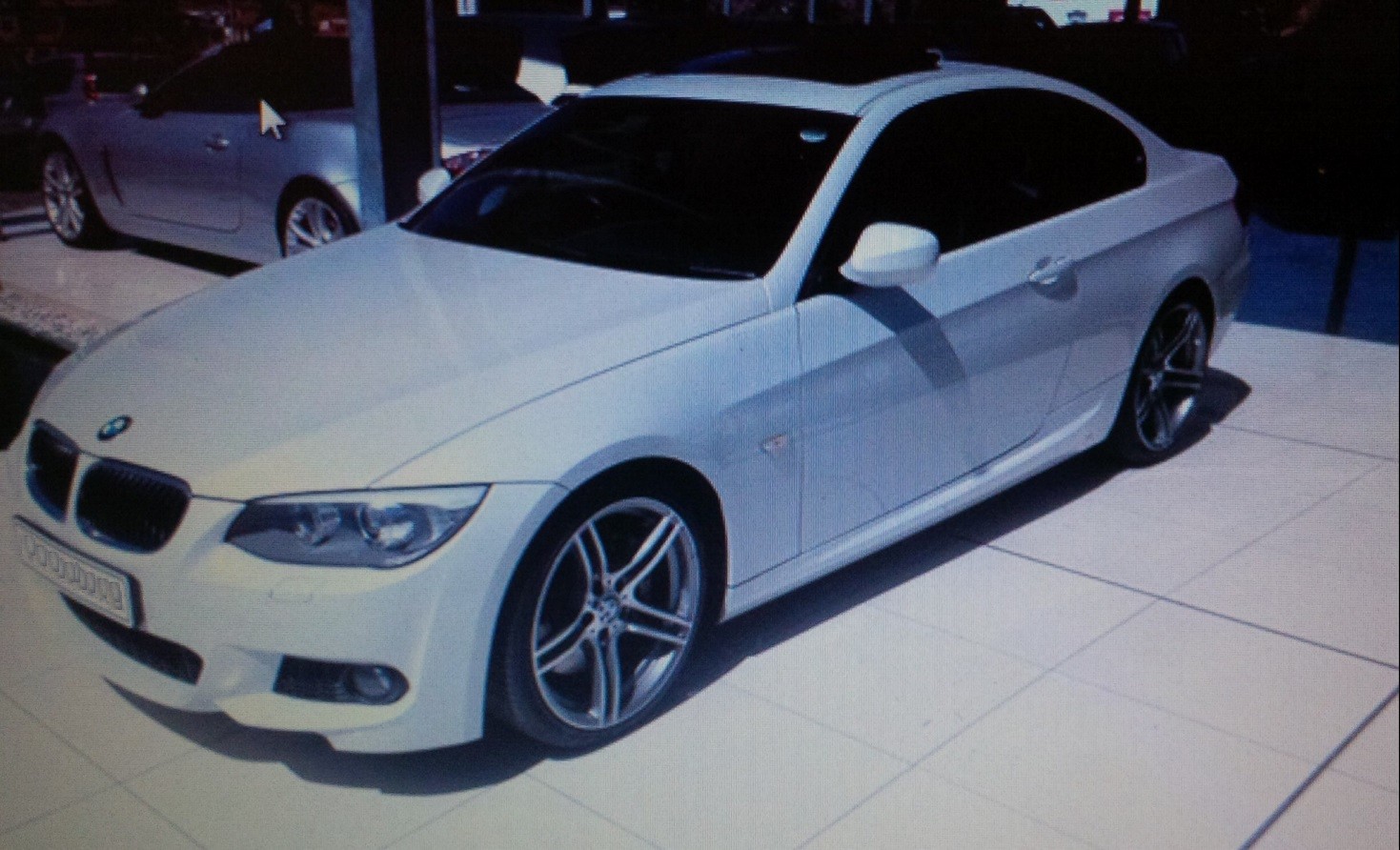

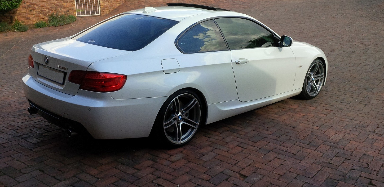

as requested here is a pic of my car.
mineral white :blowheart:
