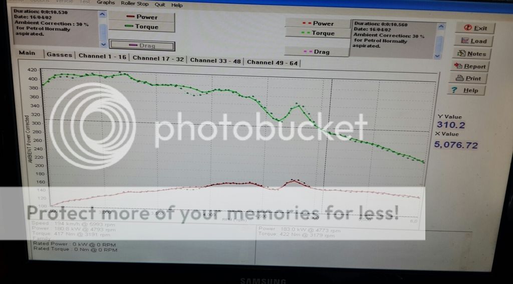

Stock Run at KAR:
Car ran 183kw and 422NM
As you can see on the dyno sheet power dips around 4.5k RPM.
I installed JB4 and intake and did another run on the dyno it managed 208kw cant remember the nm. This was on base settings and pump fuel.
With the JB installed the power curve shudders and not consistent. MAP 5.
No Errors comes up on the JB unit.
I took the car to BMW and they cant find any issues on the HPFP.
Im a noob with JB4 and will get assistance from a tuner when im ready.
BMW says this dyno graph is normal. I doubt thats the case.
Before i start messing around with the JB4 i want to resolve the power delivery issue.
What im looking at doing is a carbon clean.
Car is due for service in 4k km so im going to try and get the plugs changed.
Anything else you guys suggest i check or is this graph OK.

Post a log Karsh... Also any errors you getting on the jb unit

I've heard that Map5 is not a dyno friendly map. Rather use map 1.
Use Map 2 if you have down pipes installed.
Like Kish said do some logging and post them up.
Also is your JB4 unit a new or second hand?
What are your user adjustment settings?

Hey bud. Im not really worried about the unit. The dyno graph above was when the car was stock. Everything was removed.
JB unit was bought new.
User adjustment settings what i got off the JB4 support thread on this forum.
Car has no downpipes.

i think you're taking the right course of action by doing the carbon clean first as i think you'll have lots of built up carbon now as it has been documented..then do dyne & take it from there. then maybe try adding NF or something just to see if it makes a diff
