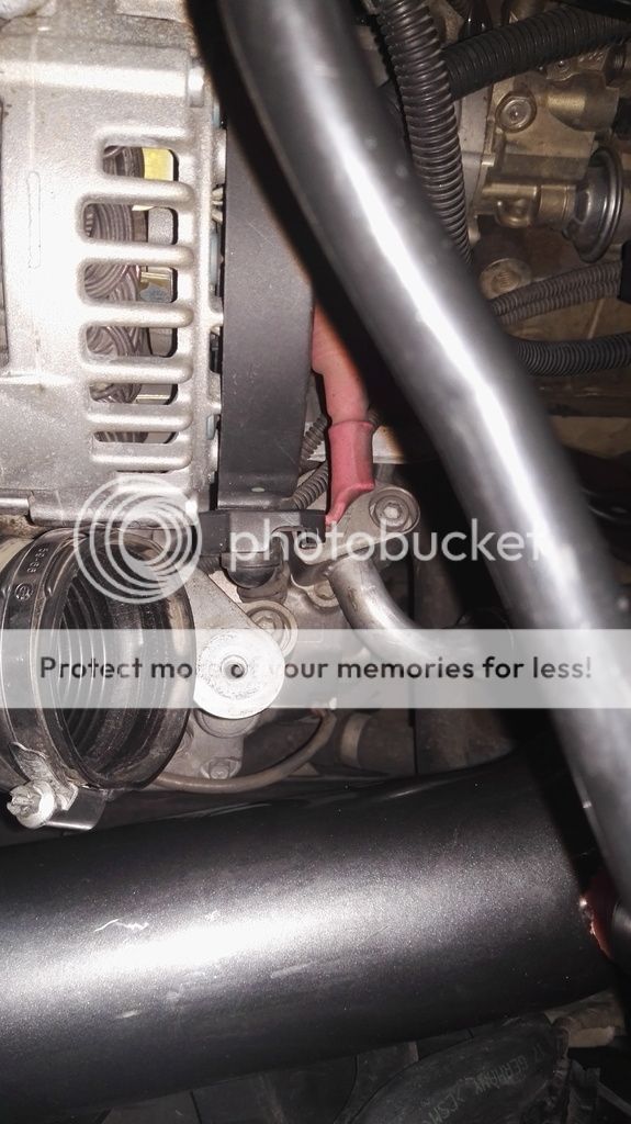

It's your alternator that's failed... Do not drive the car as the water pump is electric and will not function if there is no electricity...
Now that you say you installed a charge pipe, it makes me wonder if you didn't accidentally short the alternator output onto the body or similar as the output pole is immensely close to the charge pipe.

Think you might be onto something! When I installed my charge pipe the 1st time I also got a bit close to the alternator and noticed a huge spark jump across.

@Kish2604 , I had a look at the wiring by the alternator and it seems to be good. I don't think I shorted it but I could be wrong. Will this cause the alternator to fail? I also noticed the alternator was extremely hot. Thanks in advance

Any current spike to the alternator can cause damage to the electrics inside... it could just be your bad luck that it went at the same time as well...
Edit: the N54 alternator has a one way clutch built into the pulley allowing it to freewheel on overrun, that bearing could also have failed and the heat killed the internals.

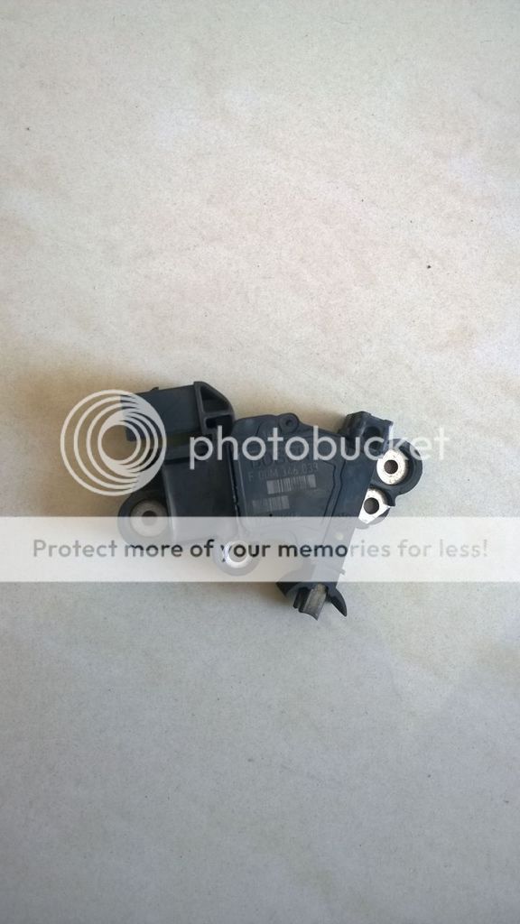

Had the alternator repaired. The voltage regulator and the diodes were changed. So far over a month now and no issues. Costed me about R3000 incl labour.
Update:
So we decided to swap out the voltage regulator for a new one to see if that will work. It's a Bosch part but it was really hard to find. Bosch themselves didn't have stock with most places giving me a 15 day waiting period. Managed to get the part from Motorlec for R900. The stealers wanted over R2000. It was a simple DIY job to replace the VR without having to remove the alternator. Been driving the car for about 4 days now and everything seems to be fine
