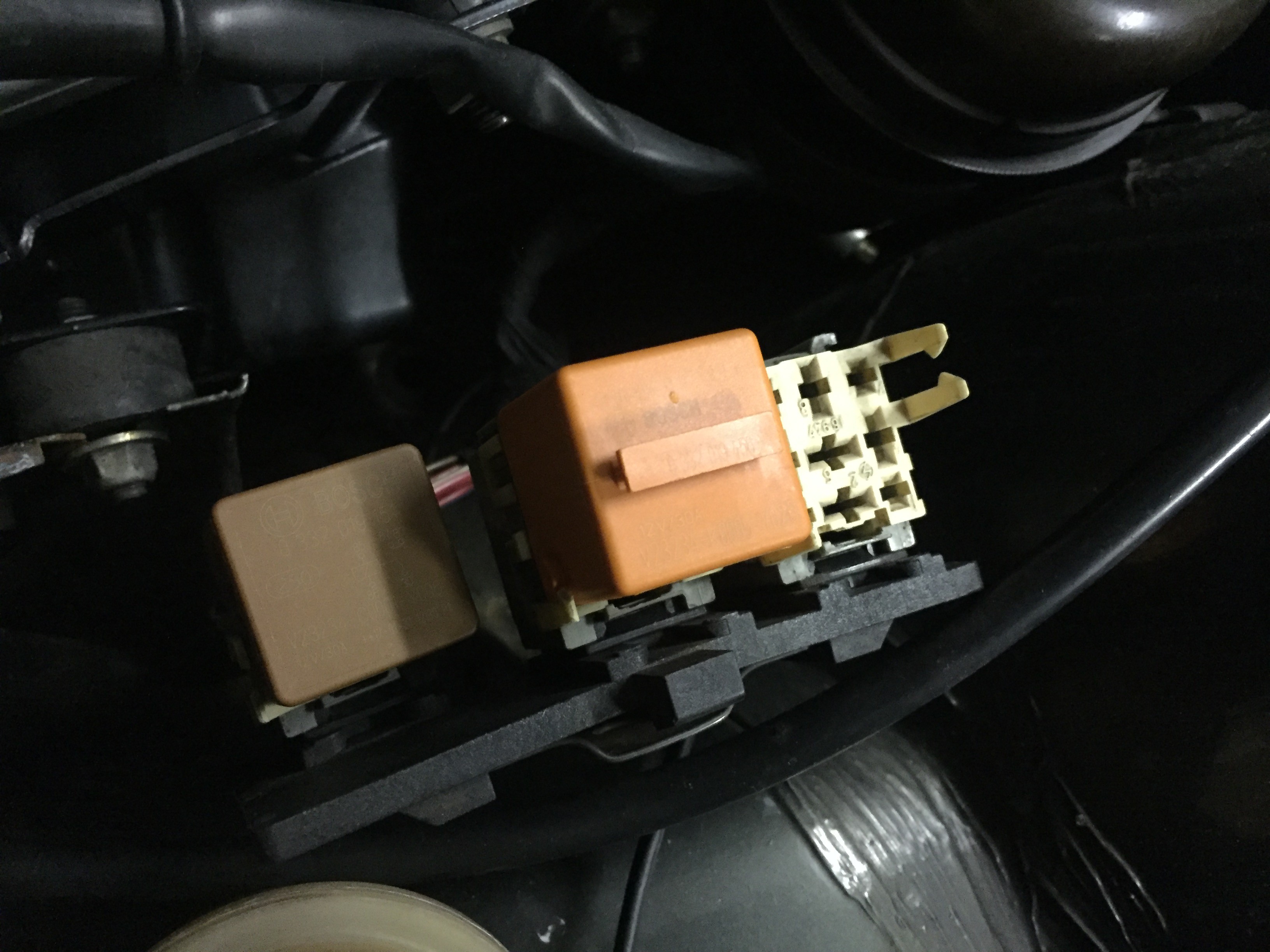

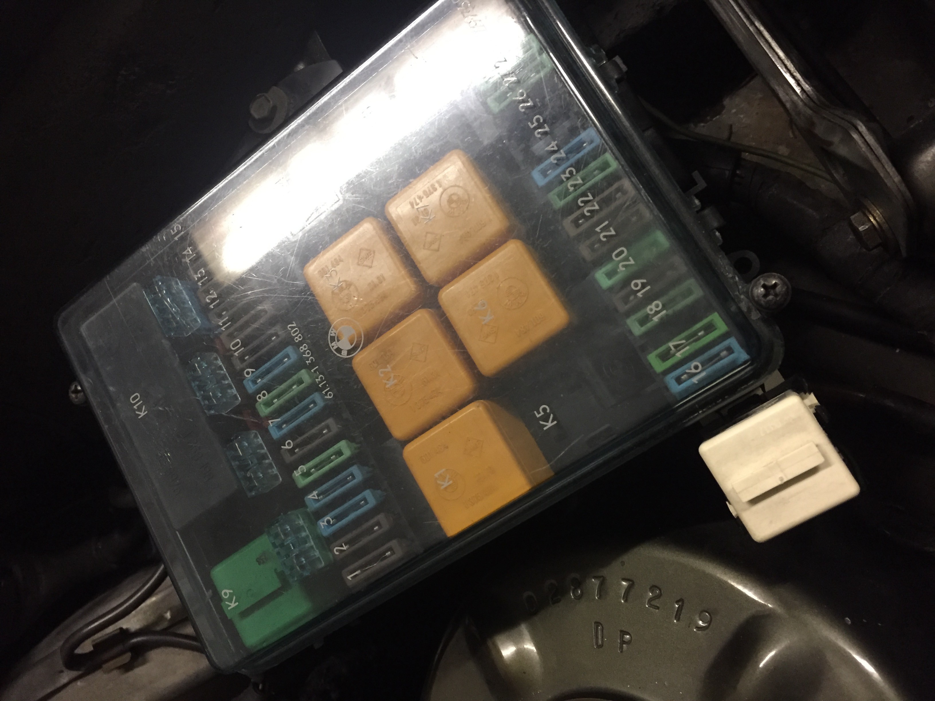

I replaced that relay with a new relay (just because well I didn't know what condition the original relay was in and I guess 30 years , the relay wasn't that expensive so I replaced it) , The old relay was a silver/grey metal square relay , the new one is a plastic brown relay . Thing is , on the side of the fuse box , there is another relay and some people tell me that that is also a DME relay , it was Identical to the one that is next to the fuel pump relay , BMW replaced that one some time ago , the original was also a silver grey/ metal box relay but the new one that they replaced it with (then) was white plastic .
I have no idea what relay that is on the side of the fuse box , how can this car have two DME relays? I have attached pictures of the relays . Also It cant be for any special electrics , the car is stock standard and kind of bare , Besides the extra button computer on the dash it does not even have electric windows lol
