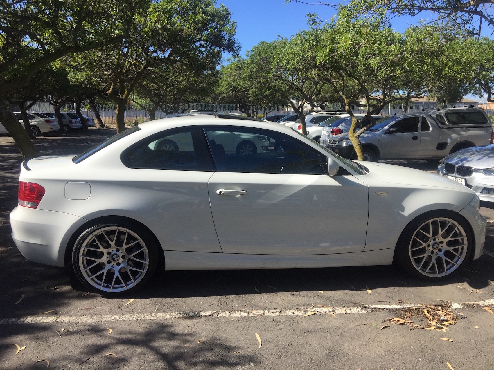

What offsets are you running on those wheels? Looks fantastic!
Shot dude.
Not actually sure hey. I'm assuming I can only check that with the wheel off?
Yes, it should be written on the inside of the wheel... "ET" and a number...
I need to change my tyres to narrower ones so will check then.
Also, how in the world did you manage to find a manual 235i ?? :)
245 at the rear should help, assuming rear offset isn’t too aggressive.

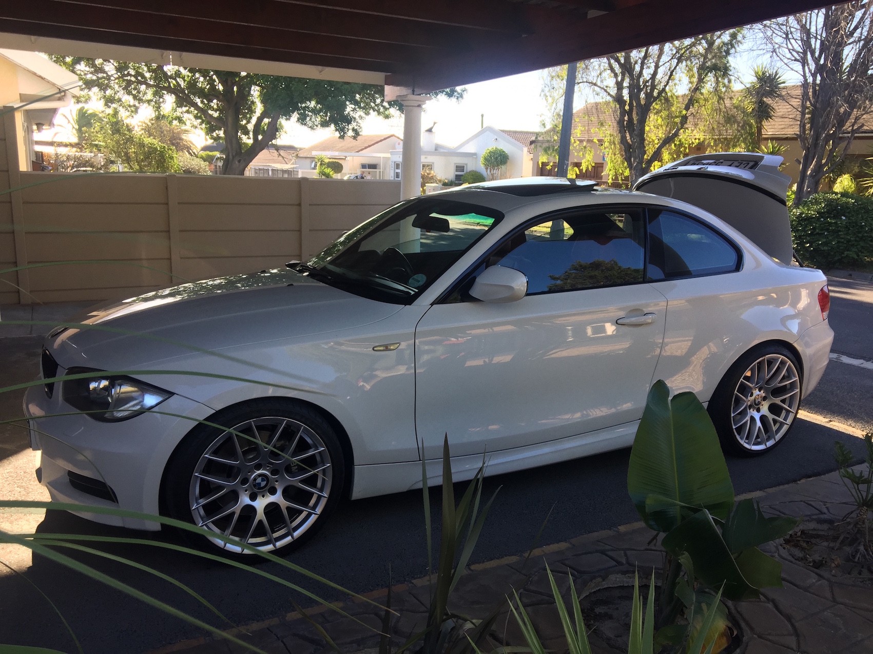

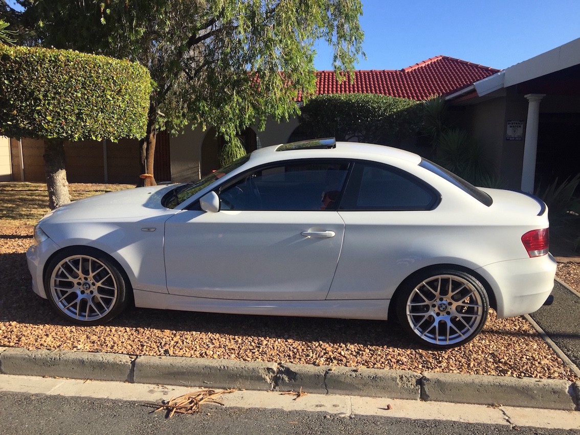

Wheel update:
18inch 193's
8J in the front with 225/40's
8.5J at the rear with 255/35's
DSC
YOU CAN GO 9 J FRONT AND 10 J rear , providing the offset are 1er ofsets.
I do not think the problem is your ofset and not tire size . I have ran rear 265 and no problems .
can you confirm what ofset wheels ?
Congrats lovely ride .

Thanks, these are the standard 193 offsets, not exactly sure what they are.

Thanks. I specifically wanted staggered wheels with runflats, which this set is.
But yeah, I liked the other wheels as well but wanted the narrow wide stance.

Nice :smilebounce:
You can run a 9J on the front as long as the ET is 40 or maybe 38.
I'm going to guess they were 30 but you'd have to check if it's rubbing on the outside or inside of the wheel well.
Here is what the stock specs are:
Tires: 225/40R18 / 255/35R18 Rims: 9Jx18 ET40 / 9.5Jx18 ET35
Tires: 225/40R18 / 255/35R18 Rims: 9Jx18 ET40 / 8.5Jx18 ET40
Tires: 225/40R18 Rims: 9Jx18 ET40
Tires: 225/35R19 / 255/30R19 Rims: 8Jx19 ET40 / 9Jx19 ET46
These are OEM specs so there is a little wiggle room :thumbs:
