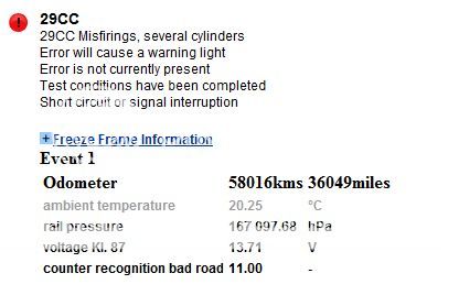

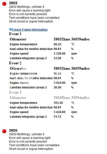

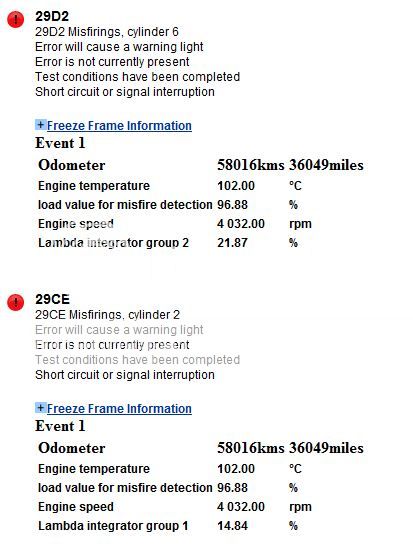

Had a spare coil pack at home so swapped it between cylinders, but misfire codes still appeared in multiple cylinders (see below)?

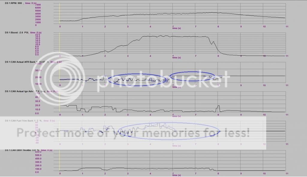

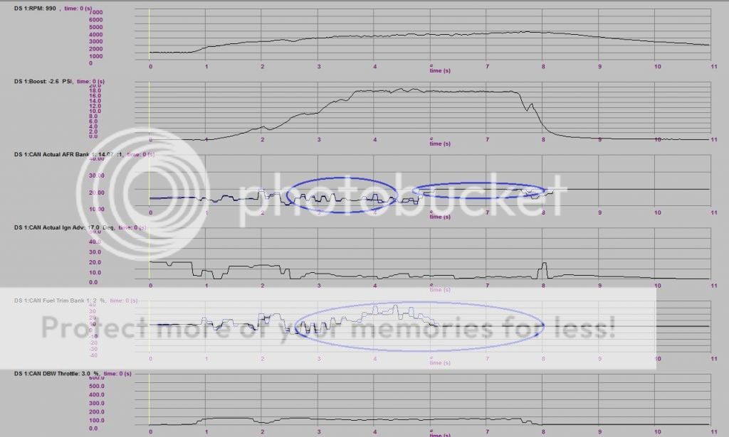

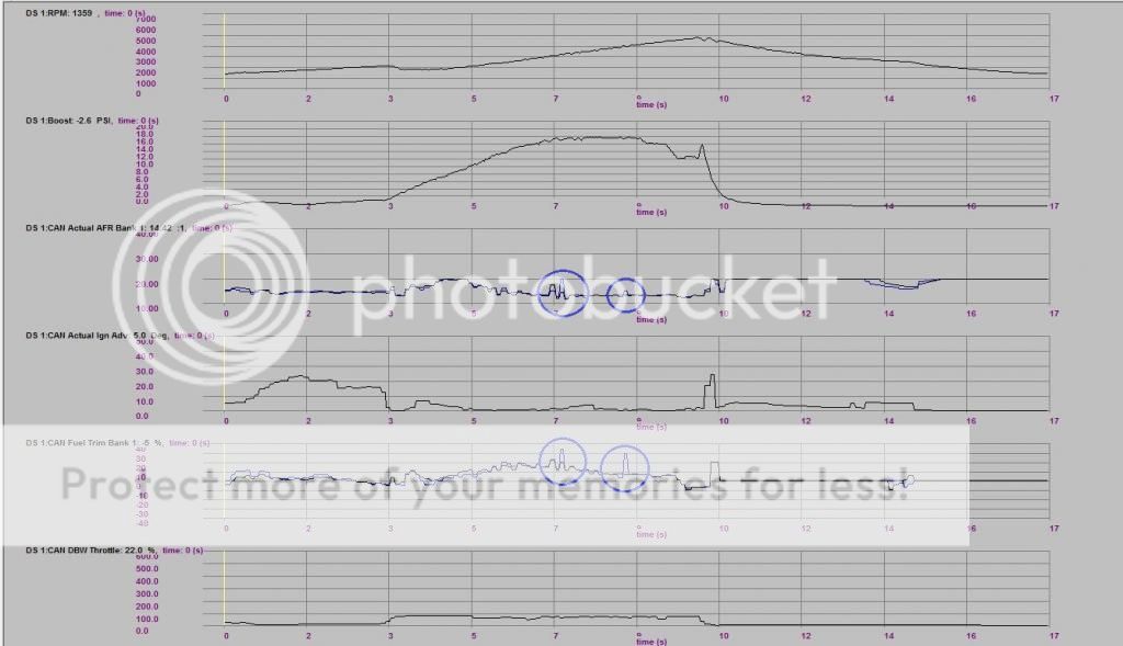

Logged the car on several runs (logs below), didn’t even reach higher rpm’s on some of them as it was misfiring so badly. Seems AFR’s oscillate/jump to lean when misfires occur (have highlighted with a ring in the below logs), even flat line at 20 when misfires persist?
