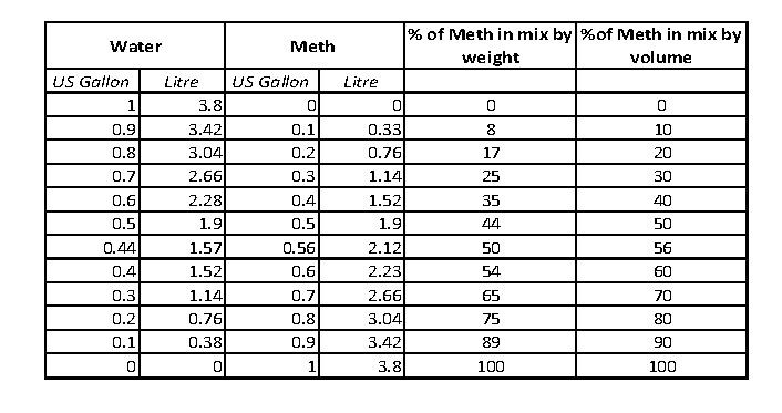

Hi Gents
While on the www I found the below meth/water ratios guide, since a lot of meth tanks are in US Gallon sizes the below table helps convert to liters with the ratios mix as well.
Hope this helps, if anyone has a eth/fuel mix to octane increase please share
Example
25L 95 octane fuel plus 5L Eth = xx Octane increase
