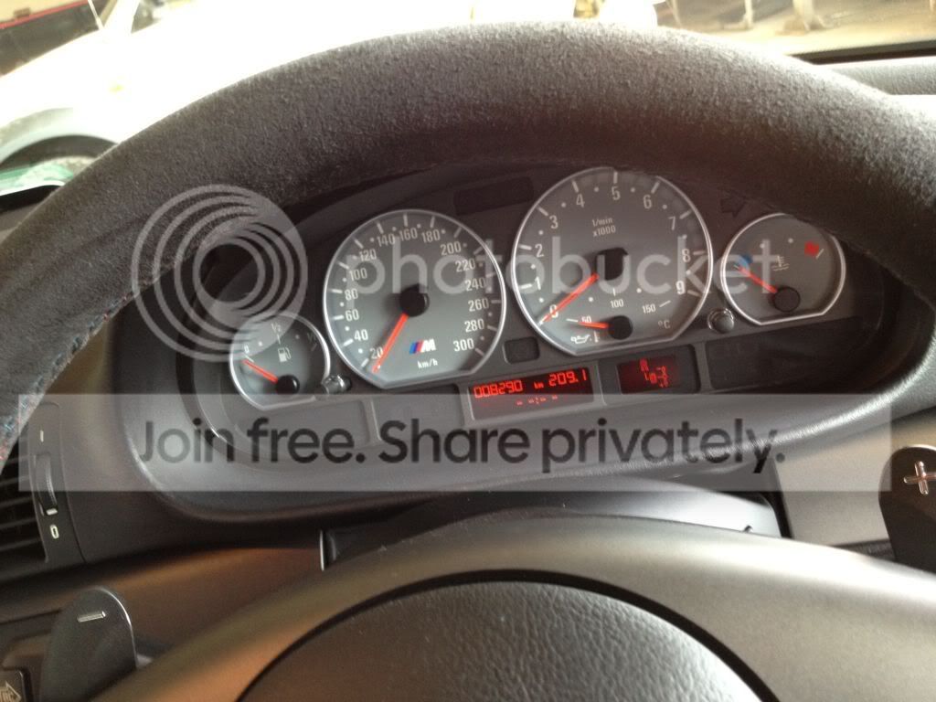

Oil temp in the same "ring" as where the tachometer is. The water temp is on the right side on it's own "ring". If it is the oil temp you are speaking of, mine does the same thing.
that mileage !! :thumbs::thumbs:
