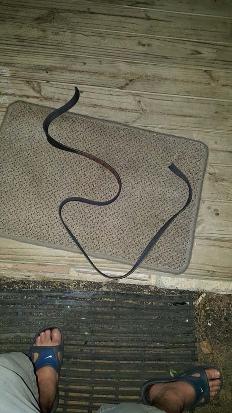

so, on inspection we found the belt snapped.

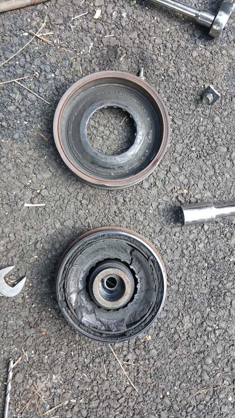

then checked all pulleys etc and found the Crank pulley has torn its outer half from the inner half.
Now I need
so .
Obviously the waterpump (driven from the SC wasnt turning)> :(

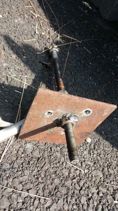

And here's my Bush tool I fabricated... lol... but it WORKED!

@fluffy, crank pulley failure is fairly common on these cars. Surprising that your water pump failed along with the pulley and belt since it is driven off of the SC and not by the belt.

well... with the crank pulley seperating totally.... the belt was not turning ANYTHING... so the waterpump was not turning...
Enzio
Hi, correct - perhaps I misunderstood your previous post where mention what you need to replace. The water pump did not fail, it just stopped turning.
