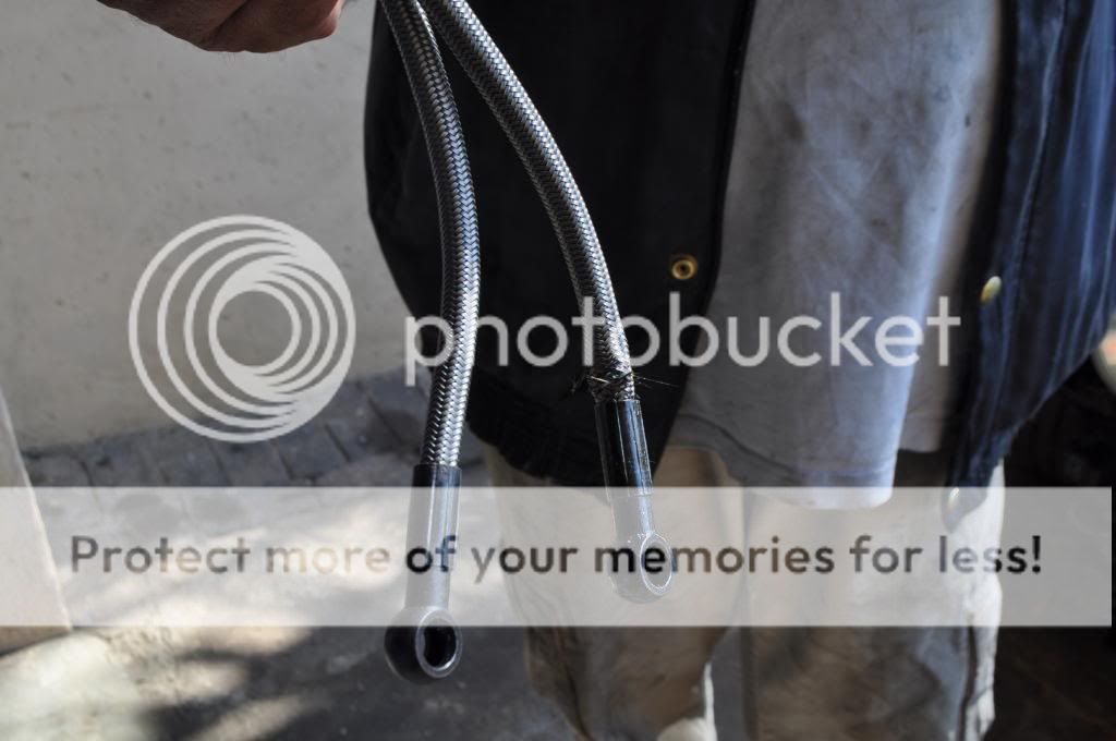

I think this will be the 5th power steering hose that we will be changing on an e46.
BMW should be ashamed of the lack of quality on this part.

This is the vanos pressure hose assembly which burst due to its incorrect placement in Cape Town some 2 years ago.
Needles to say 5.5liters of very expensive oil met the road and teh car was put on a low bed.
Hose has been replaced and teh car was filled with oil and is purring like a kitten again....well maybe not a kitten but certainly purring

calypso said:
Peter, my PS hose sweats abit, but doesnt drip or leak.
Worth changing?
It will sweat now and all of a sudden it will drip.........
I would in your shoes.

calypso said:
Does the hose explode or to crimping just crap. I wonder if it can just be recrimped.
Massive heat from the motor and PS fluid is somewhat corrosive to the rubber iirc? Also a S54 only part so running improvements probably not that big a concern for BMW since it was such a small series of cars with that engine.

Peter@AEW
The quality of the rubber is poor so the fluid just oozes out from the walls..
The crimps hold and no leaks from them.
