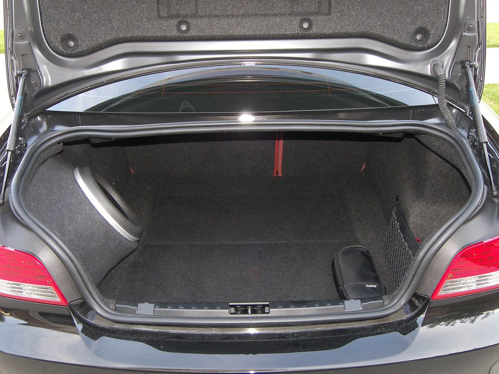

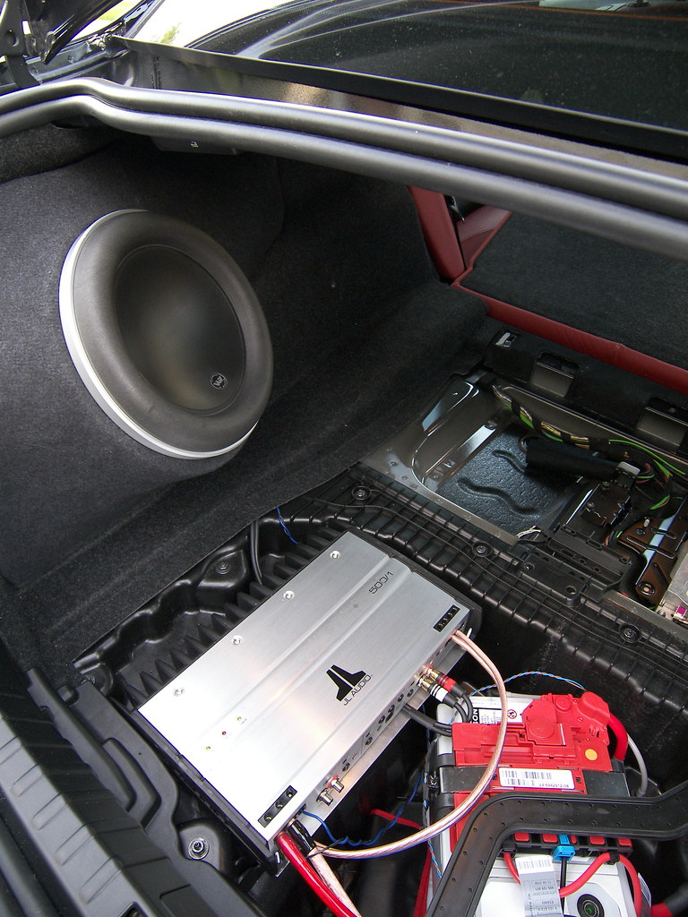

So i've been looking at this subwoofer+amp setup for a while on 1Addicts, and it seems like an awesome setup! So OEM which is what I love.. Also takes up like NO boot space as it's installed in the little side section on the left of the boot..

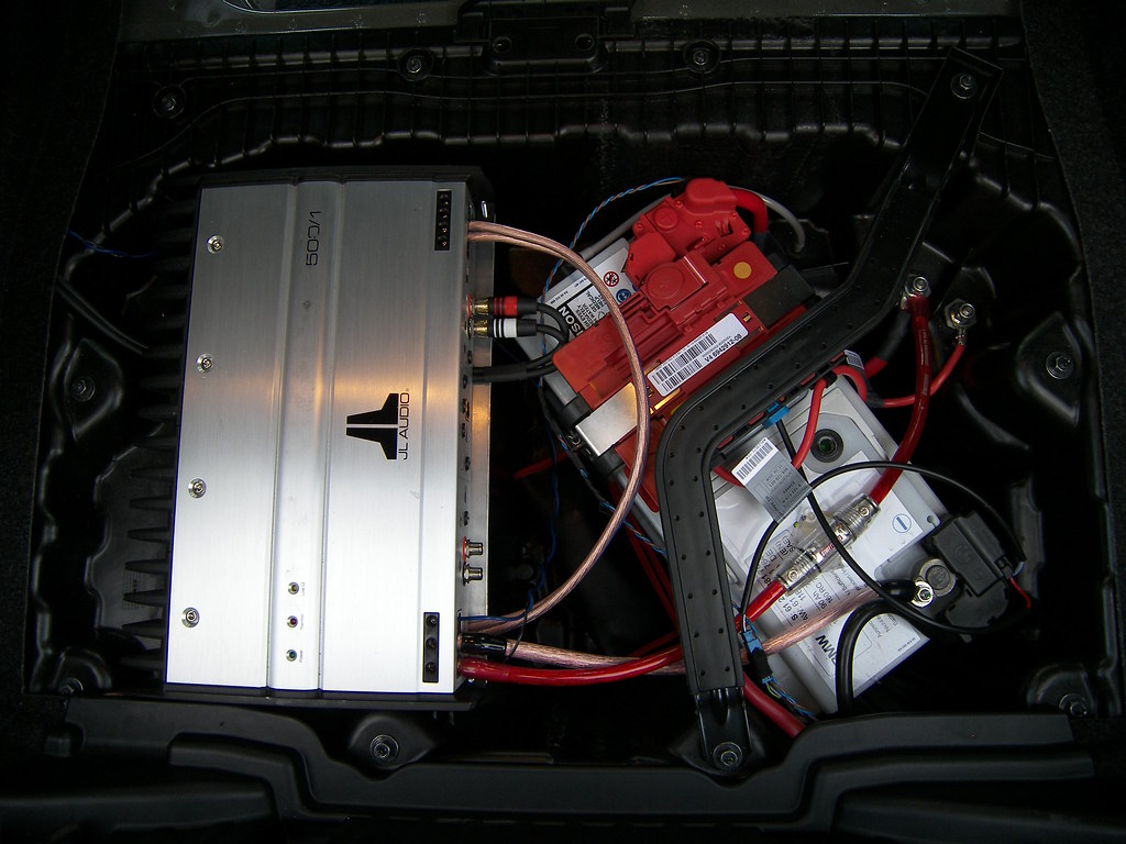

Amp fits under the boot lining where the battery is (so practically a few cm of wiring needed too :) )

Here are some pics of the setup:

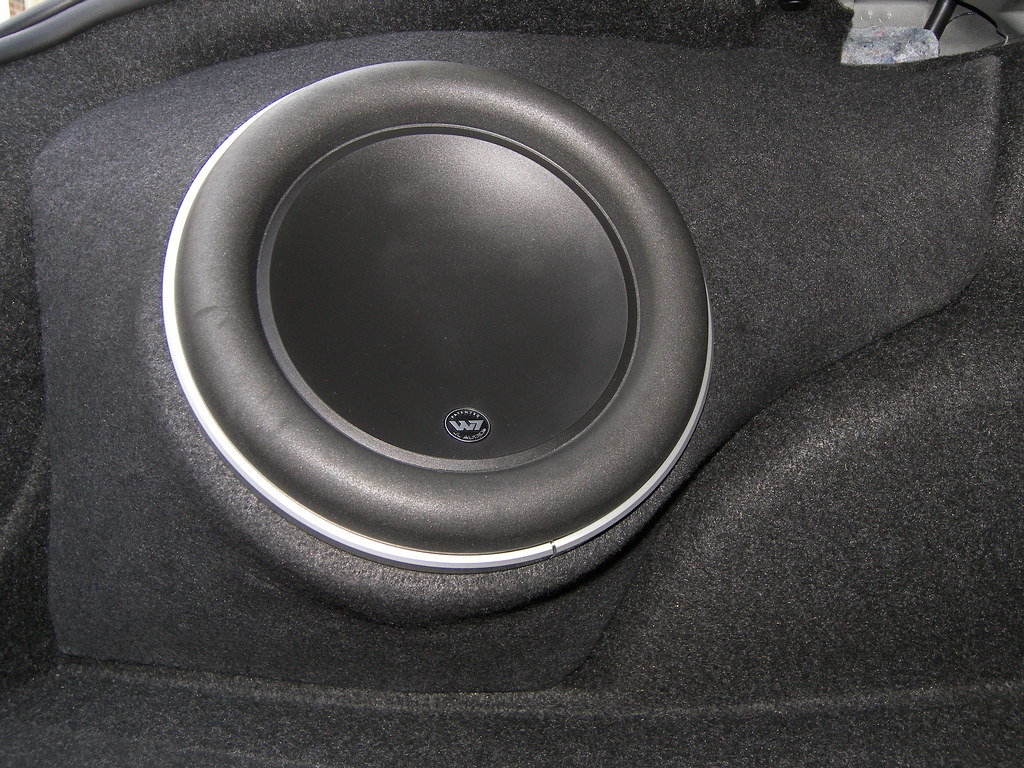

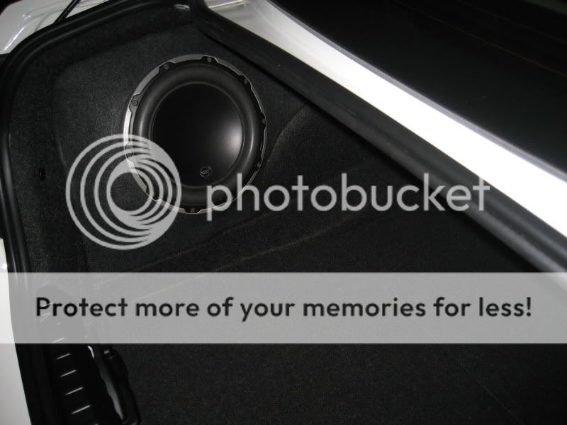

W6 Sub:

So what I want to do is have the exact setup above (amp and all), but have the W6 sub instead of the W7 (as the W7 protrudes a bit).

does the amp not get hot when it's covered like that?
