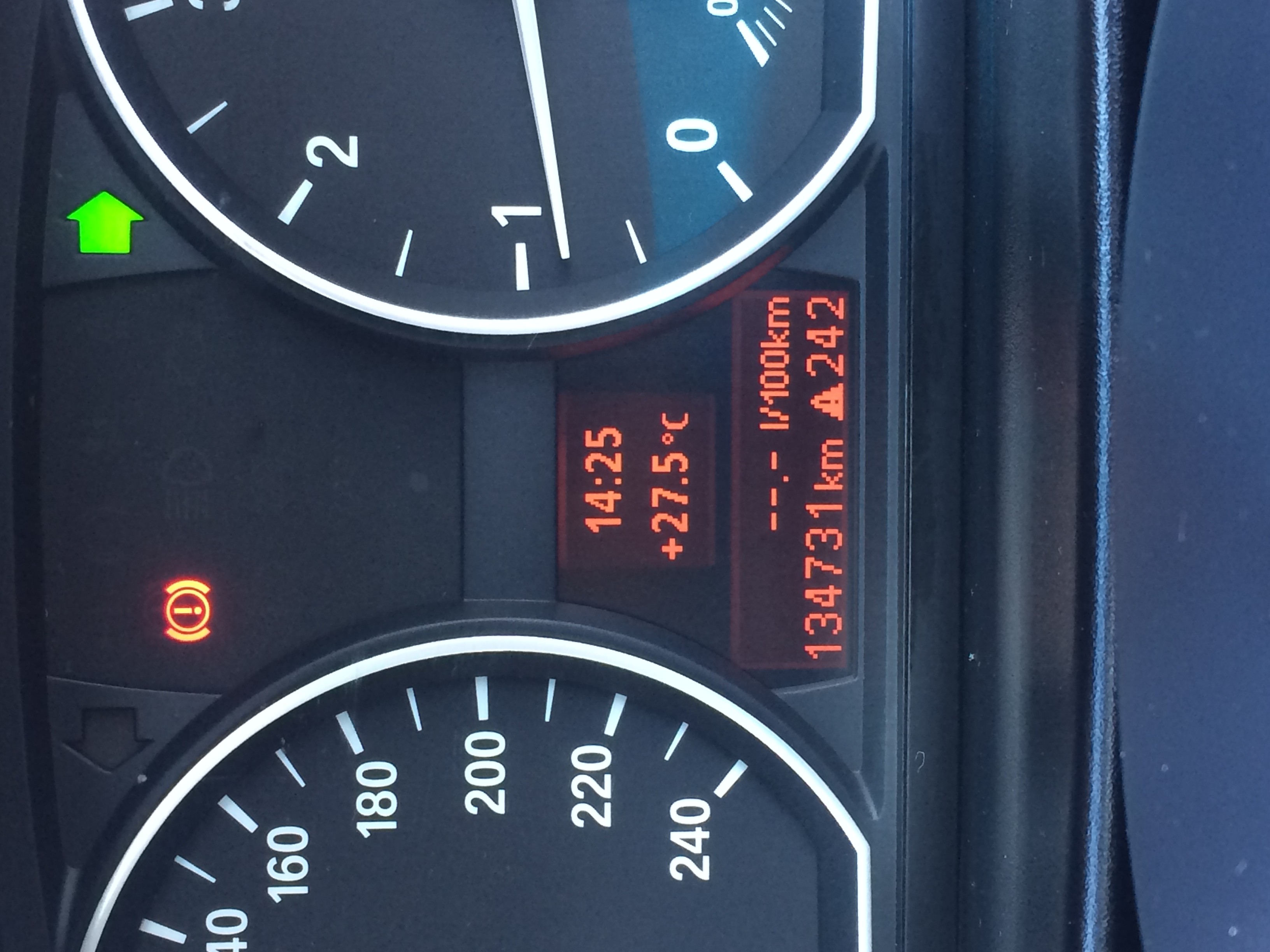

Hi guys. I recently acquired myself a 120i.
Lately I noticed the outside temperature shows -44. That's obviously not right.
Is it a DIY fix or does it warrant a trip to the agents. Thanks guys

that temperature is the default setting if the temperature probe is not connected, or missing all toegether, check in the ducting close to your front brakes for the probe

Hi guys so today I checked under the fender loner and found the sensor and plug missing. So I shorted the wires to check and the obc reads +50. So where can I get a sensor and plug from. Or is it just agents. Thanks guys

Override69
Thanks guys. Got a plug from the dealers. Connected it and mounted the sensor and it's working fine. Thanks everyone
