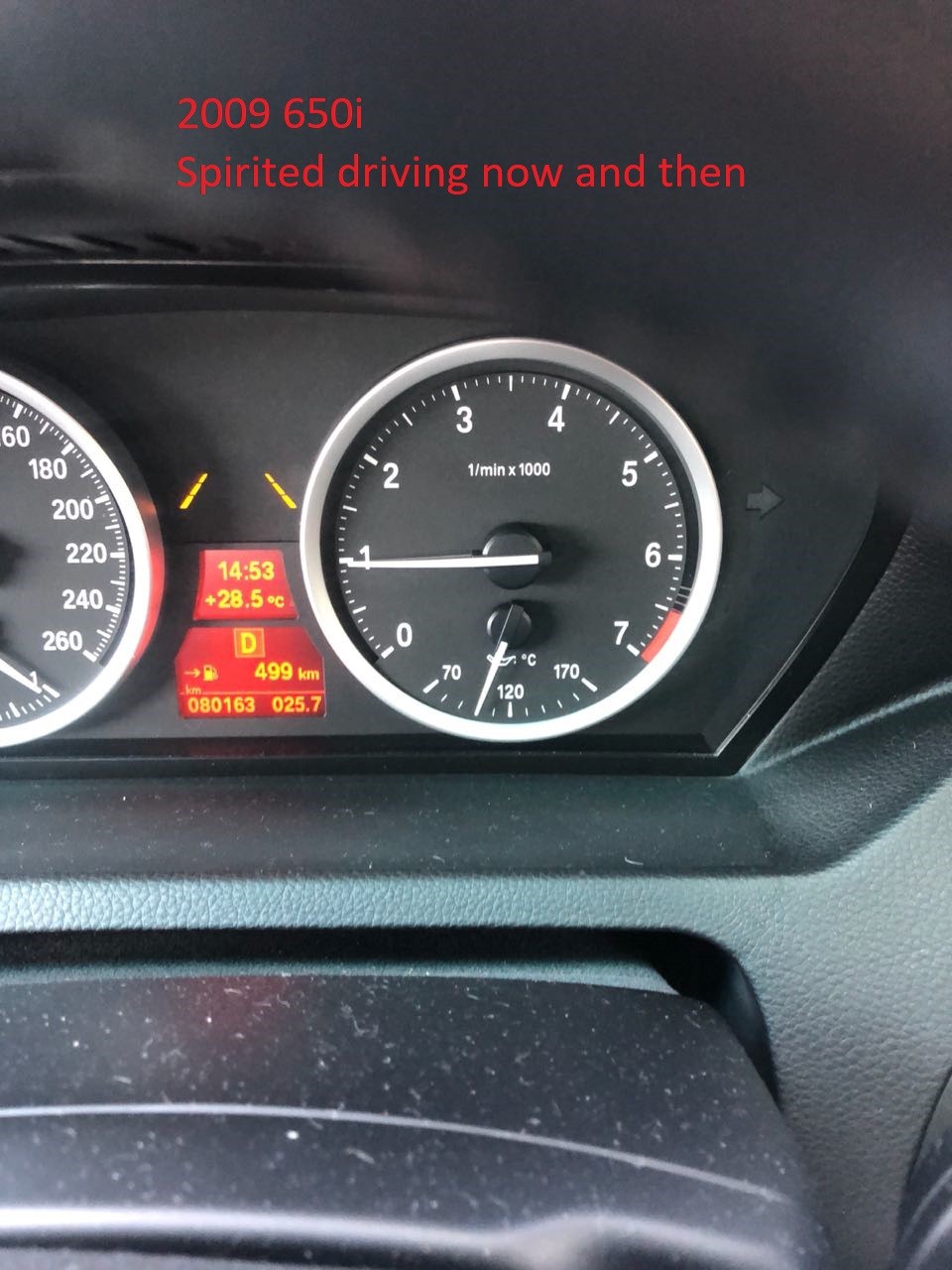

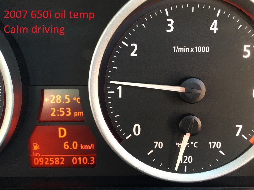

So my issue is the oil temp. I have a 2007 650i and my mother happens to have a 2009 650i. Same N62 engines. Her 650i is behaving how mine used to. Oil temp hovers quite stably at 98-102C. Mine is very erratic, jumping around alot as in the attached video.
Yesterday after fetching the car from the mechanics, driving very calmly never going over about 3800rpm in about 28.5C ambient temp in PTA, the car's oil temp would hover around 108-110C while the 2009 650i driving the same route right in front of me would be hovering at a stable 98-102C while driving a bit harder here and there and slowing down so I could catch up, never going over about 102C.

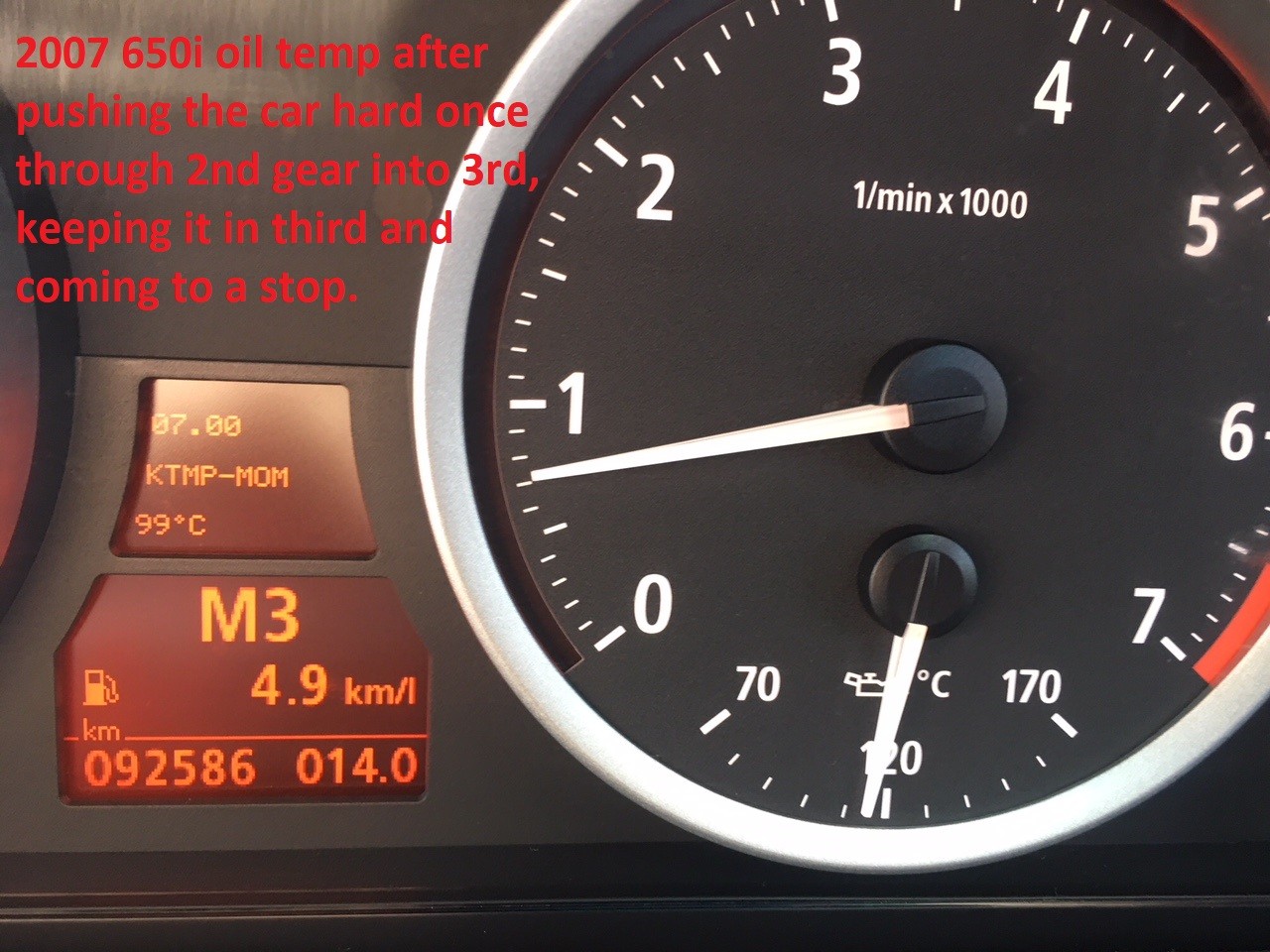

I drove a bit harder when getting closer to home and my 2007 650's oil temp would reach about 115C and the 2009 650 would stay at 102-105 MAX.
That's exactly how mine used to be.
