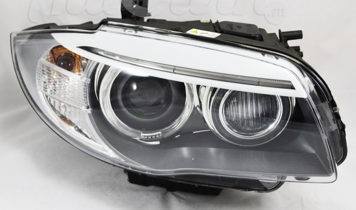

But, the amount of hacking needed to make the LED bulbs work, is more than I am willing to risk. Here's my thought, I will swap out the current halogen housing for the 1 series HID/Xenon housing, and install the LED bulb in there as they would fit without hacking. Straight swap, and no extra modules or coding needed.
My concern is the auto-leveling feature, I don't care about it. As long as I can still electronically adjust the lights from inside the car I'm happy. Can it be done? or by changing to the HID/Xenon headlight housing do I automatically lose the ability to adjust height manually?
I'd appreciate input from anyone who has done the retrofit to HID'Xenons
What I have
What I want, but with the LED bulbs.

I am struggling to understand what you mean by going the LED route.
The second pic you posted is a OEM light, and it does use HID/xenon technology.
You are going to be spending lots of money and effort for little gains, just go out and by a set of DEPO angel eye lights.

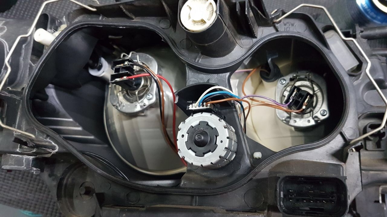

My bad, now I understand. I am unsure about the levelling aspect as the motor attaches to the Halogen trim at the back.
Here is a pic of the halogen setup, if the xenon setup has the same motor thenit should work.

If your car has auto-levelling for the headlights now, you will have to re-code the light control module (LCM) to enable manual adjustment of the headlights. If your LCM does not have the little reostat on the switch, manual adjustment is not possible although auto-levelling will only work if the new headlights also have the adjustment motor inside (as most should do).
If your headlights can be manually adjusted now (most halogens work this way), you can just fit the xenon headlights and the manual adjustment will still work, assuming the adjustment motors inside the replacement headlights still work fine.

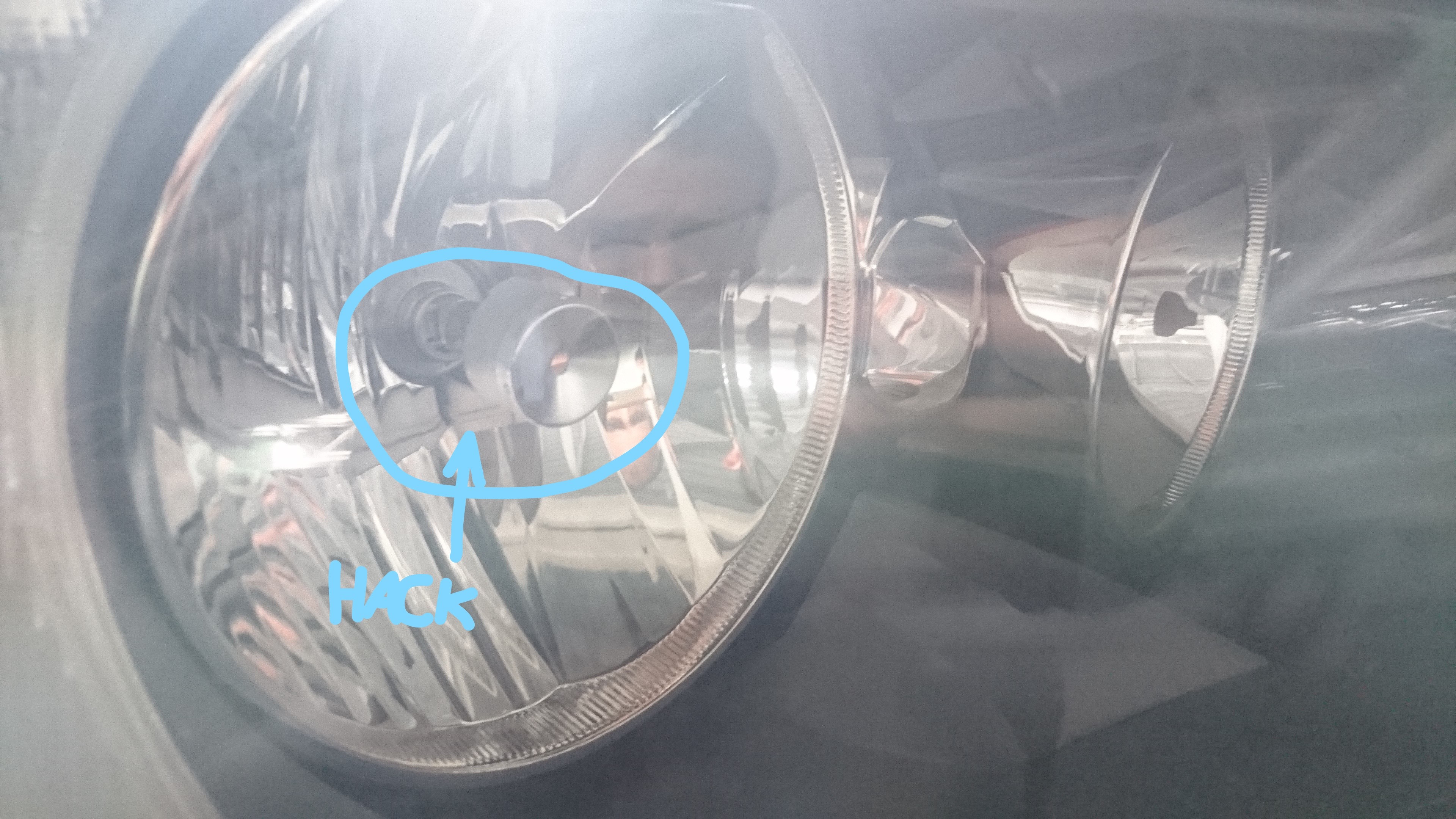

3. The LED bulb won't fit in the current housing due to its length (According to manfacturer)

The bits I was recommended to remove, by the LED Manufacturer, to perform optimally, and more importantly fit properly.

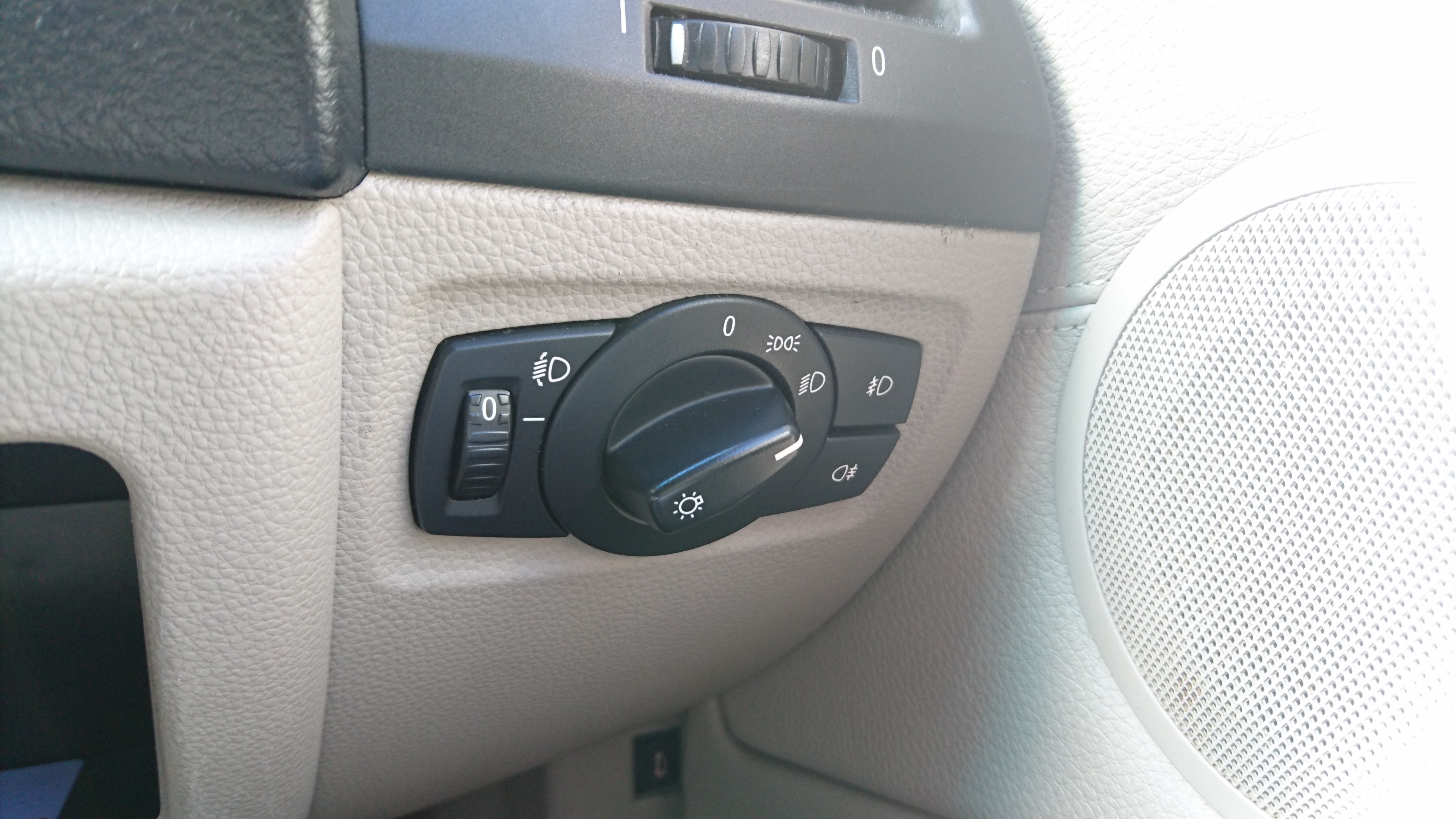

My actual switch
osiris
As far as I know, if you have that adjuster then you do not have auto adjustable headlights.
