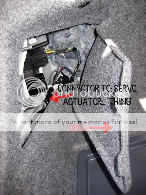

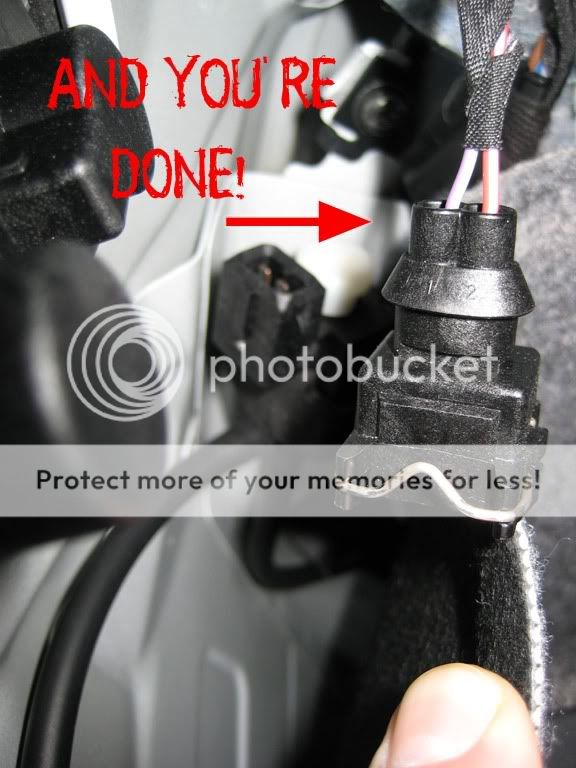

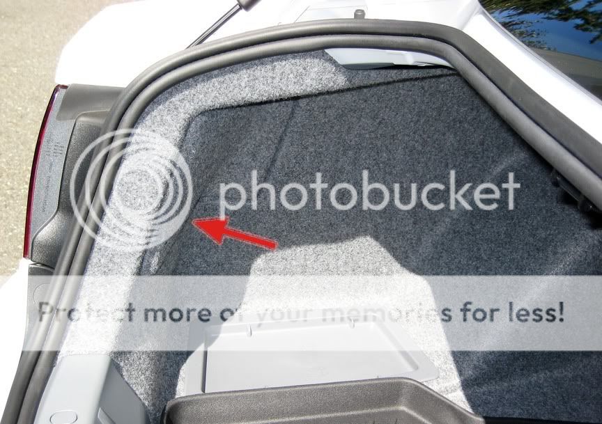

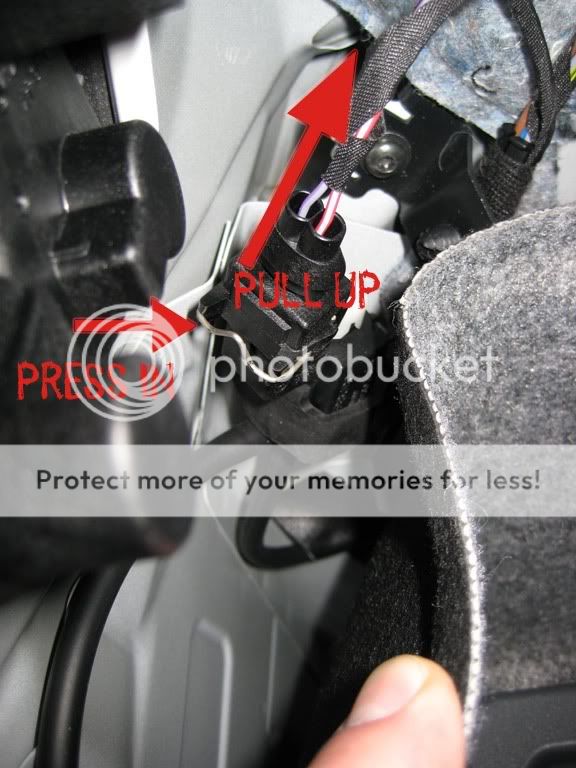

But if you want ALL the noise just unplug the actuator in the boot & clear code before a service

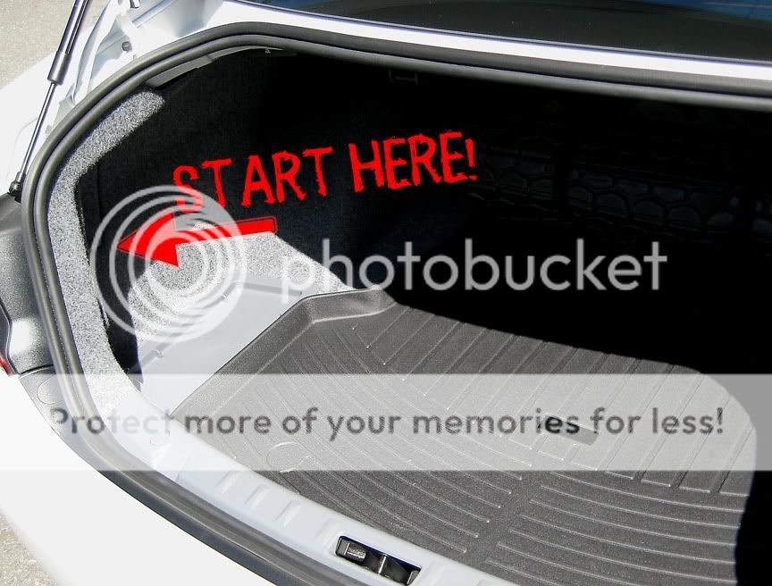

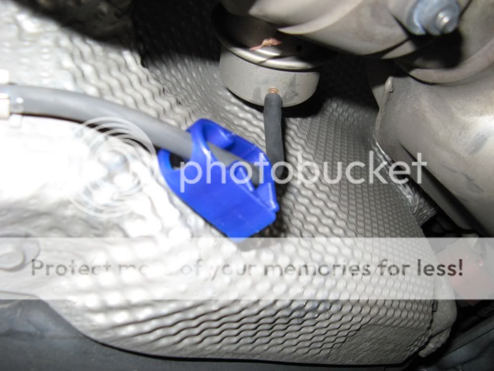

@ Scouse...i was just teasing you...this is, what it is all about:

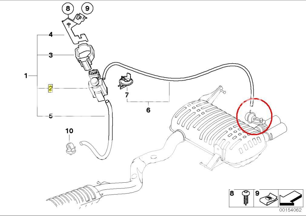

Here is a diagramme of the exhaust and where the tube connects to the exhaust valve:

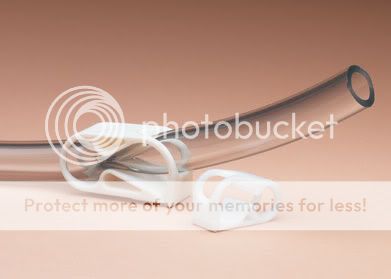

Here are examples of clamps that can be used:
But i prefer this method to get all the sound. But it throws a code to say the actuator exhaust valve/flap is open. Which must be deleted before a service. Please note none of these pictures were taken by me and i do not assume responsibility for any faulty install; as usual:

Wow, thanks Twinz, thats a very well presented pictorial
Now it makes lots of sense :clap:
