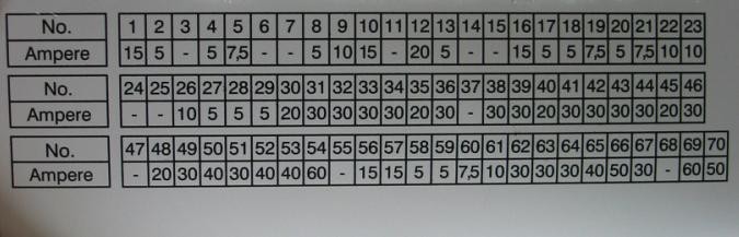

Rayzor
Here you go

Hi Ashie,
I've had this issue quite a number times on my car. The fuse number you're looking for is number 30, the 20 Amp fuse.
Ashie
Thanks for all the help. I will check fuse number 30. i do have the fuse diagram but it does not show any symbol for the cigarette lighter fuse
Blankman
I just fixed mine last night. In my case it was #8 fuse.
Followed this:

Andy1GP
Bandile said:
Ashie said:
I use my cigarette lighter as a charger and it has stopped working. I looked at the fuse chart in the glove box compartment, but it does not indicate which fuse is used for the cigarette lighter. Does anyone know which fuse I need to look at
Hi Ashie,
Changed mine last week. This is for most E90's. Bottom right location. Fuse costs R5 at autozone.
