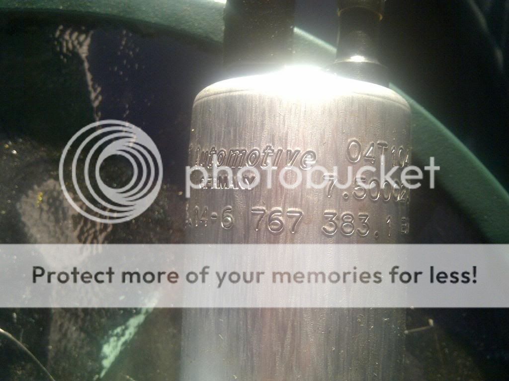

It's the E53. I'm convienced its the same. Can you tell me what the part number or are there any distinctive numbers on the pump that you have Andy?
Andy1GP
Let me check Rowen
Part number on my pump 16.14-6 767 383.1
Can't seem to find it on RealOEM? Still looking around

Thanks Andy, it the pump in the tank thats actually faulty. I've tried G -Drive and they dont stock this pump.
Guys, who else can i try for the fuel pump that sits inside teh tank for an E53 X5 3.0D... It's getting rather urgent now. If all else fails I will have to go to the dealers :cry:
Hotclutch
Do you know what make the stock pump is? Is it a Bosch? I am guessing that agents are going to quote you to replace the pump and the housing it's in. Try to get the pump out of it's housing, if it's a Bosch go to Diesel Electric.
