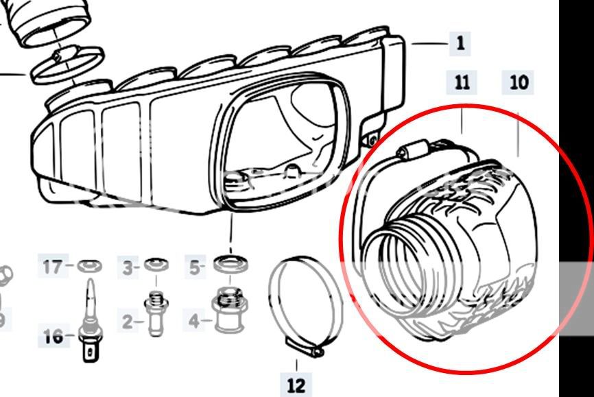

Then a little voice says to her, “biatch, what kinda of a mechie are you bru, why have you not opened your bonnet yet? So I open my bonnet and my eye almost immediately falls on the intake manifold boot, which has been “sucked†in completely! :dropjaw:
Nay it is torn! I will not be able to drive without replacing this! Placed an order for a replacement, but it will not be here for a fairly long while. Glued it and put it back. :bawling: hate shortcuts like these!
