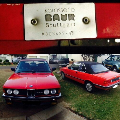

Just to give you some background on the car, there were only 4595 units produced worldwide. Each one is stamped with a number from 1 to 4595. Mine is no 3429 of 4595.

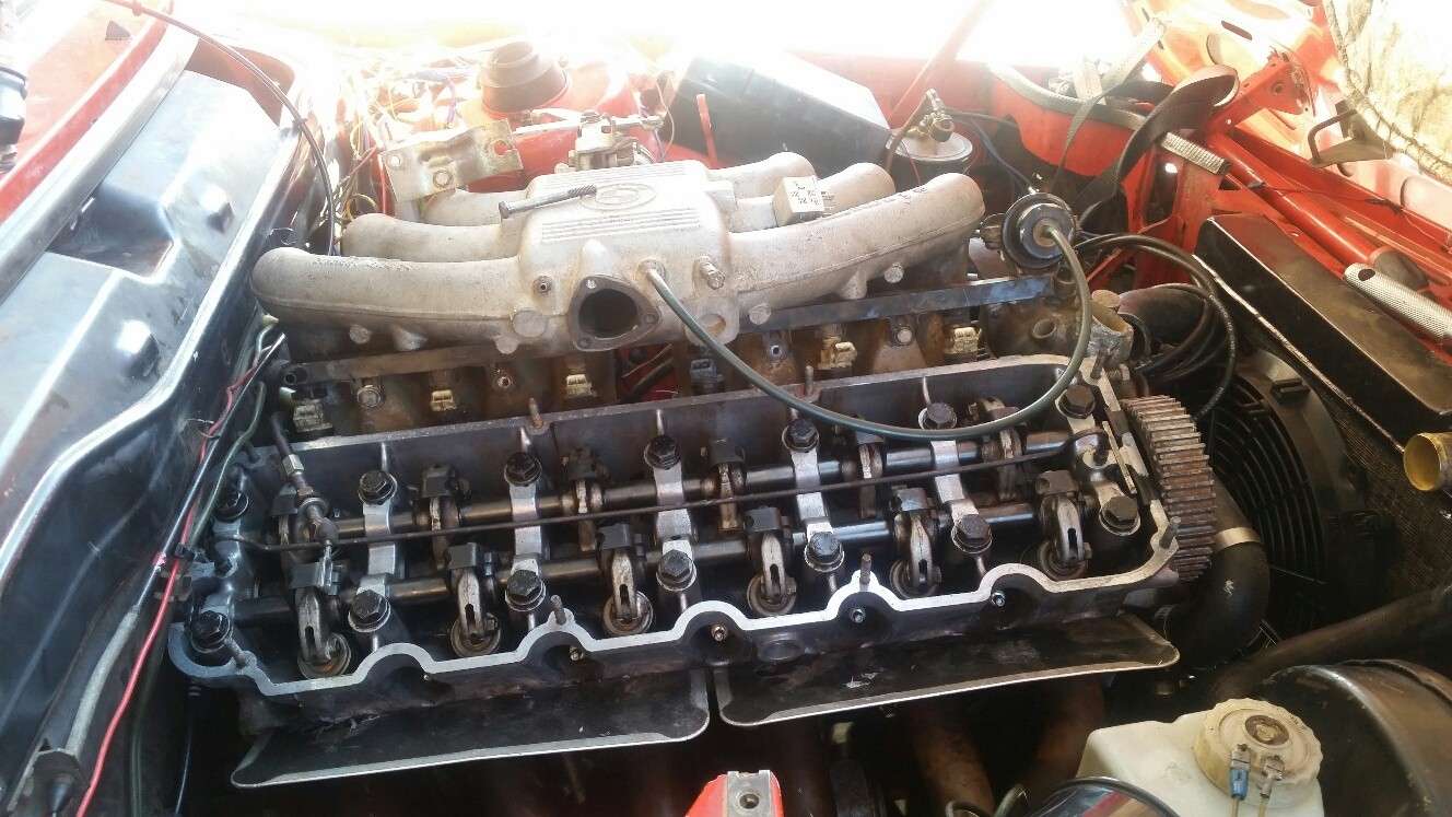

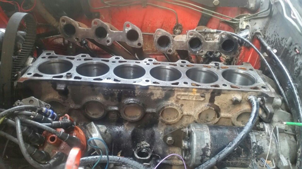

The car was smoking slightly and using a bit of oil as indicated by him so I decided to send the car in for an engine overhaul

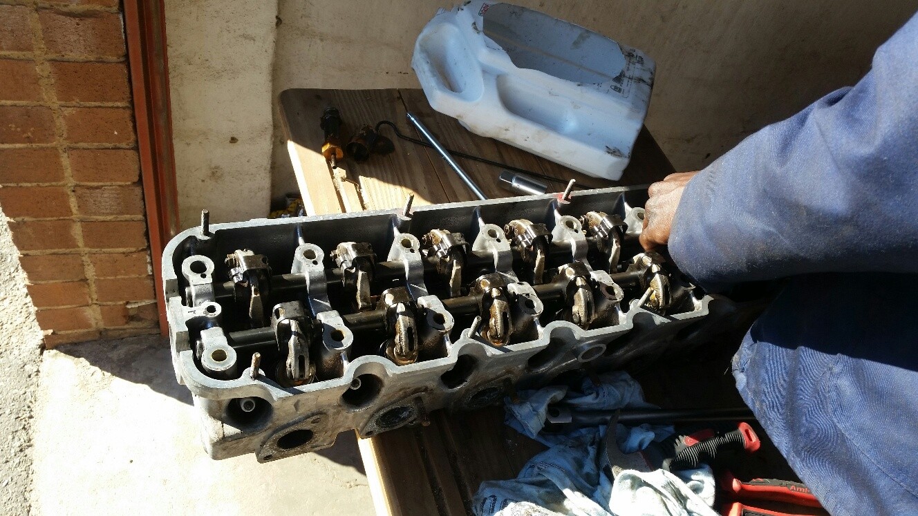

The engine overhaul then started. The head was removed and treated to new valves, guides, valve stem seals the works. Blocked was in good nik, did a light honing and new rings and bearings.

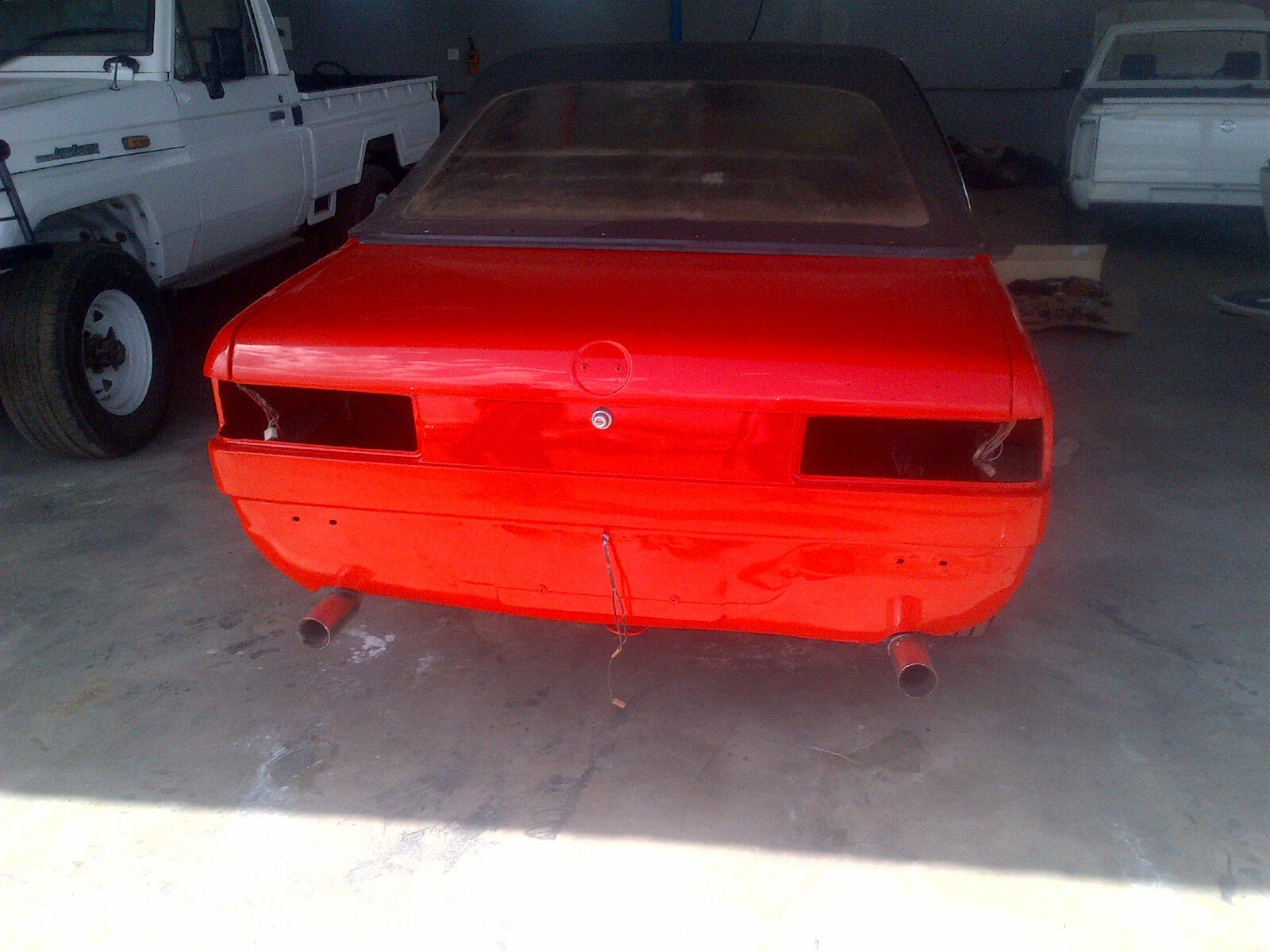

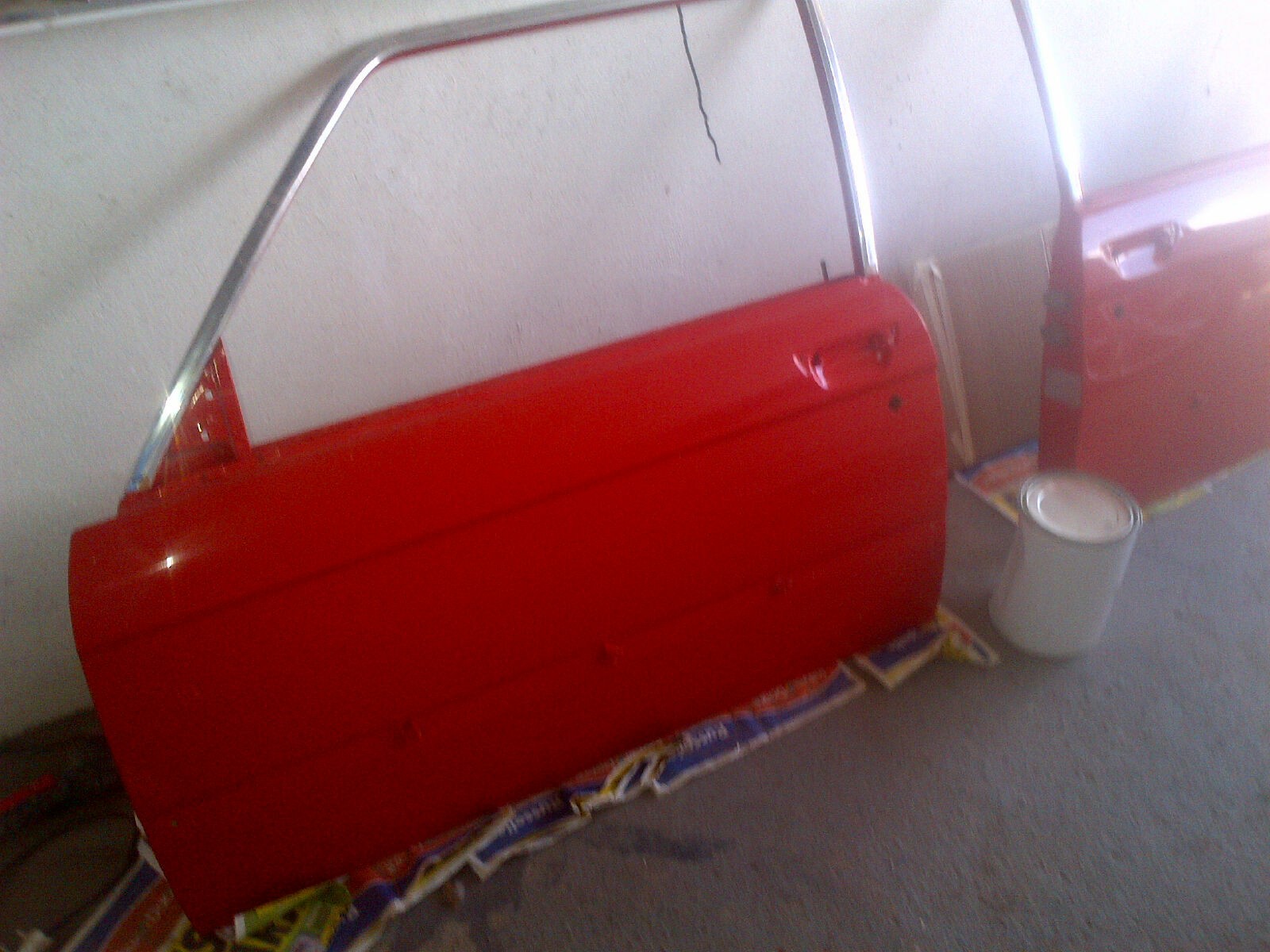

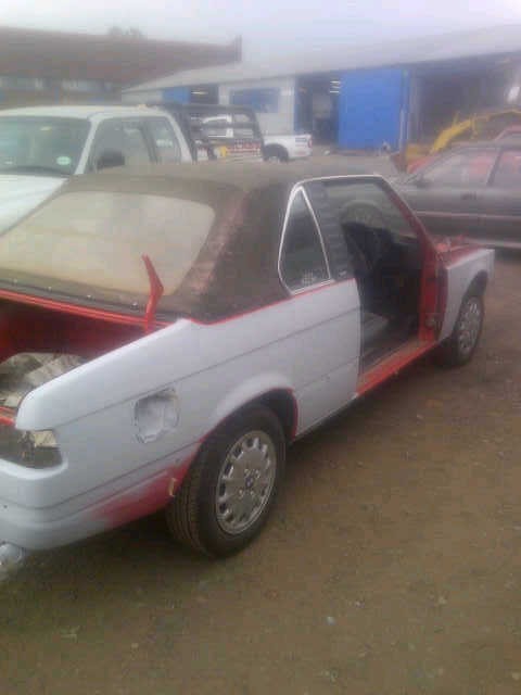

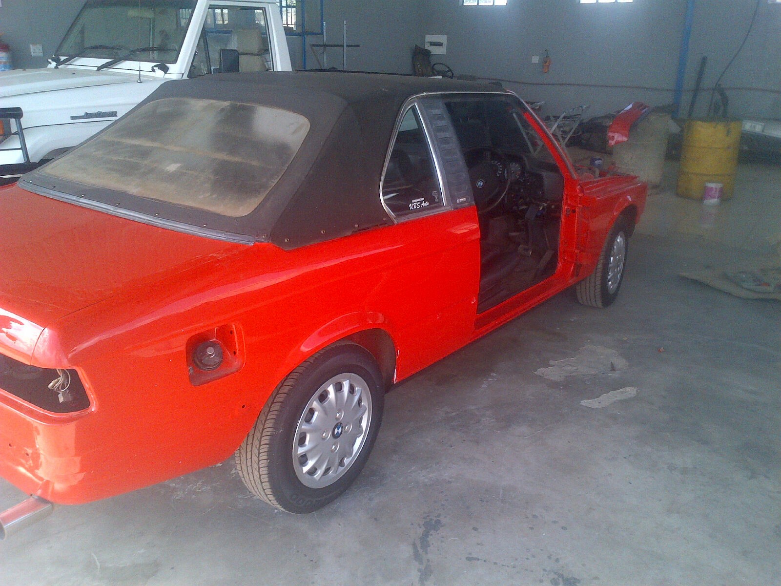

So with the car now running well from a mechanical point of view, I decided to treat it to a blow over. I am all for originality and decided to stick with the BMW henna red. The doors, boot lid and bonnet were stripped off the car to allow for better preparation. There were some fine dents here and there that needed to the straightened out. I was also very nervous of the original beadings getting damaged with stripping the car for the respray. But I must say the guys did a great job and took the utmost car in stripping the car.
Some process pics of the car ungoing body prep for the respray

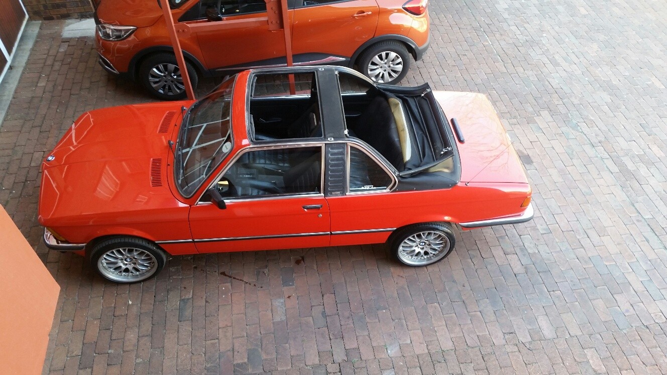

The roof is in fair condition but I will probably have it redone some time.

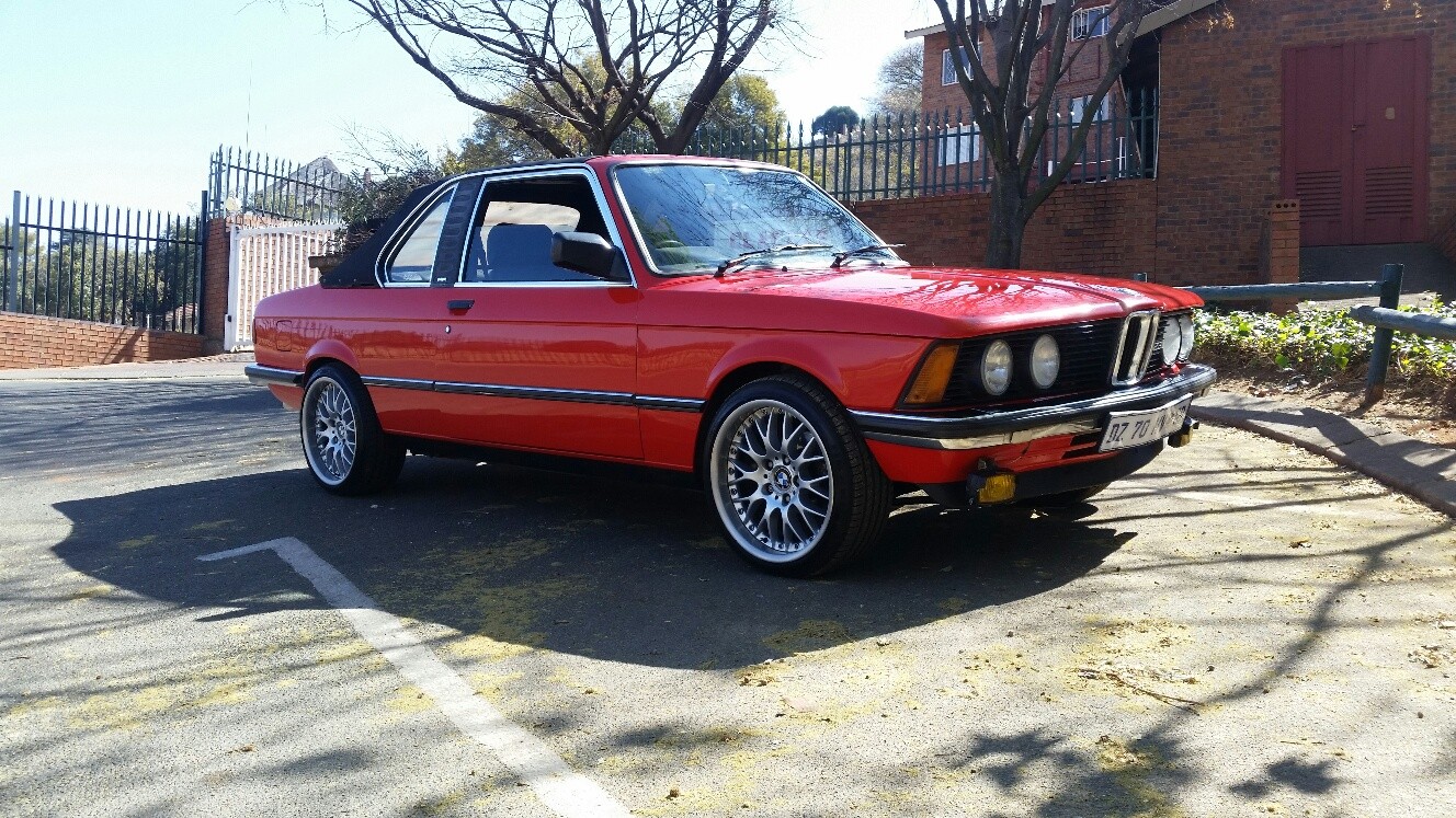

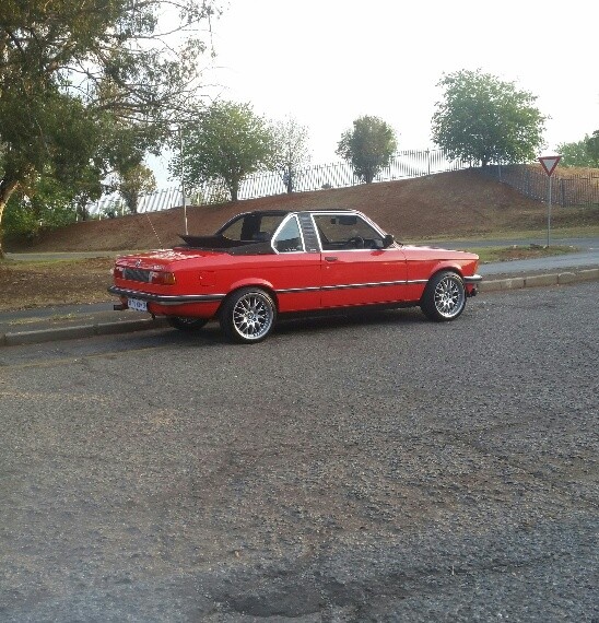

Now to decide on a wheel to finish the car off. I came across a set of BMW style 42 wheels. I always liked this wheel and wanted to give the Baur an original BMW look. Had some adapters made and fitted them on. The front has quite a bit of wheel poke. These will do for now till I can get my hands on a nice set of 16 inch Mahle or 16 inch Alpina. This is the end product
