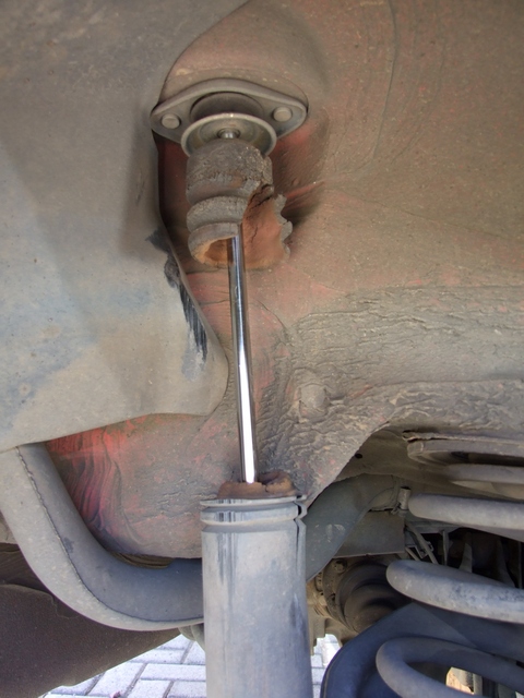

I had the shocks tested at two places but I have my reservations about the tests too. The shocks are branded BMW (Sachs) so they were probably last replaced at a BMW dealership. I recall from the service book and receipts I got that the car was last serviced at BMW at either around 100k or 150k km, meaning the shocks have done at least 80k km. Or the full 230k km... I'll need to check the receipts.
It seems that the shock on the right side scrubbed the inside of the fender well lining (or whatever that part is called) at some time:

That's just a plastic cover but what on earth happened to the bump stop?
You need to replace those unless you want serious bottoming out on the shock or better still, body damage if the shock pushes through the metal housing of the car. Based on the amount of shock travel, those vrot bump stops could be adding to the poor unpredictable handling.

Now this could be an optical illusion from camera lens, but looks like the shaft going into the strut is at a slight angle. Saver to replace these...

Hi,
Dont know what roads you are driving on, but these shocks have clearly had it. When you have such severe travel that the bumps stops are destroyed, there is a problem. (Is the car being overloaded?)
Bald spots on the tyres are usually an indication of bad shocks. If the wheel is out of round even slightly, you'll get uneven wear due to eccentric rotation.
Unprdictable handling= bad shocks (usually)
Our cars are essentially sports cars. They are not really designed for the kind of lifespans that we put them through down here.
The dry african conditions are also a problem for suspension bushes. Dust is a major problem that the Europeans dont have. They usually fail before the expected life span.
Treat your car to a full suspension rebuild. I can garentee that you will be amazed at the results, even in stock form. :=):

Thanks for all the replies. I've only recently acquired the car so I don't know what roads/driving style it has been subjected to. However, going through the service receipts it seems that the rear shocks have done about 143k km so I guess it (and the rubber bump stop) is just failing due to age. Seems new shocks are in order.

Replaced the shocks, shock mountings and bump stops today and the handling is much better. Thanks for all the replies.
