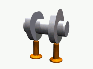

In the most basic sense the cams (camshafts) are shafts mounted at the top of the cylinders to open and close the right values (inlet or exhaust) are the time.
Camshaft:

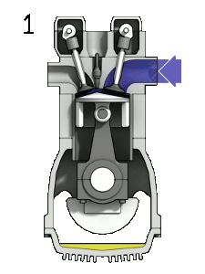

And in a four stroke engine:
The camshafts are the two lobe like things at the top of the engine that open and close the inlet and outlet valves. They are normally driven by either belts or chains (in the case of BMW) from the crankshaft.
Images poached from wikipedia
What the cam sensor does is to sense the position of the camshaft and this allows the timing to be varied slightly (the sensor only does the measurement, but this give actuators the necessary info to change the timing).
