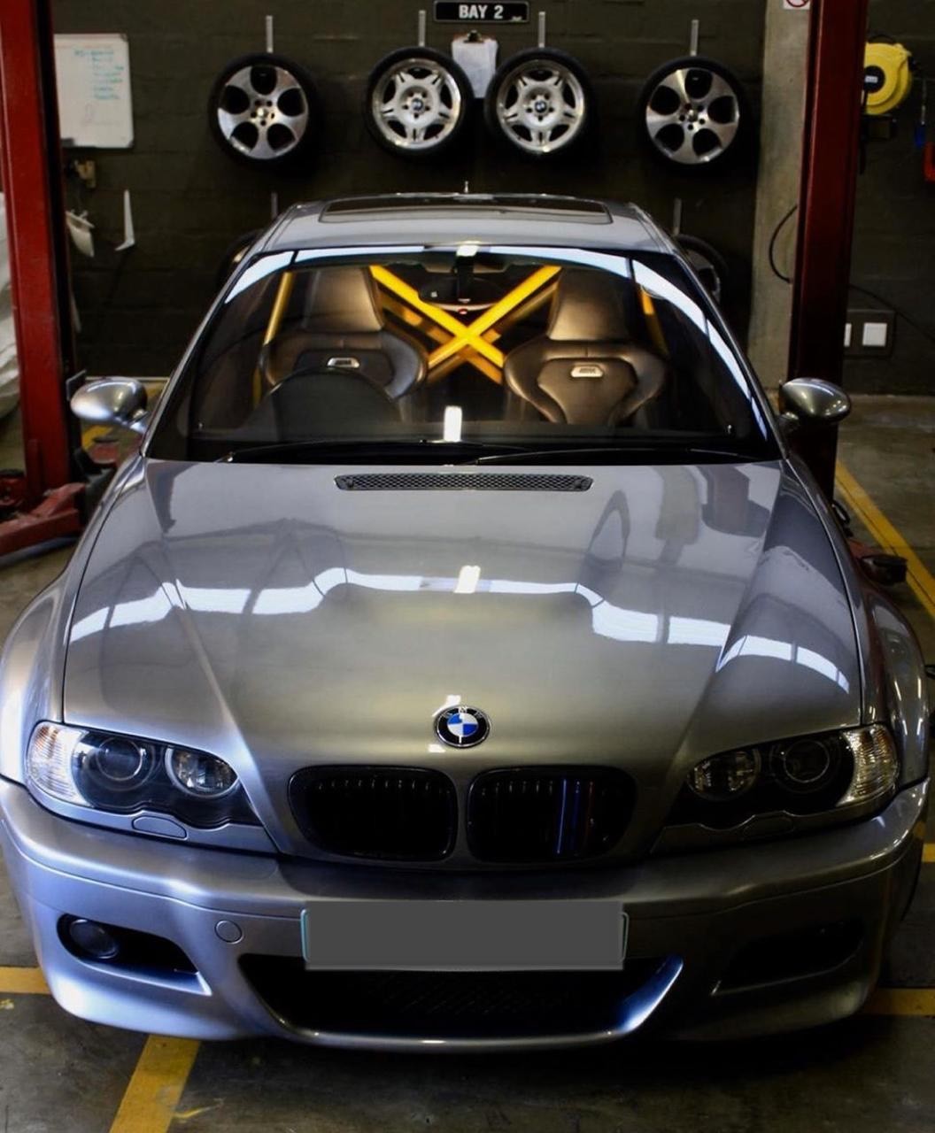

Chrism135i
theres a guy in Durban who has done this to his 46 m3 ill post a pic shortly
Iry-gp
Thats what i want to do as well, But cant seem to get any assistance from anyone that can do this for me. Dont mind attempting to DIY this but i need to know Pin outs diagram for the seat modules.
