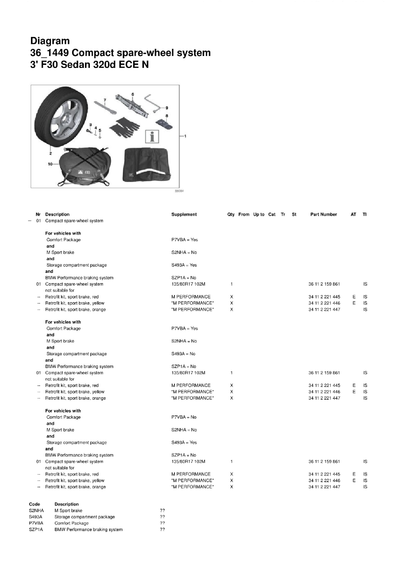

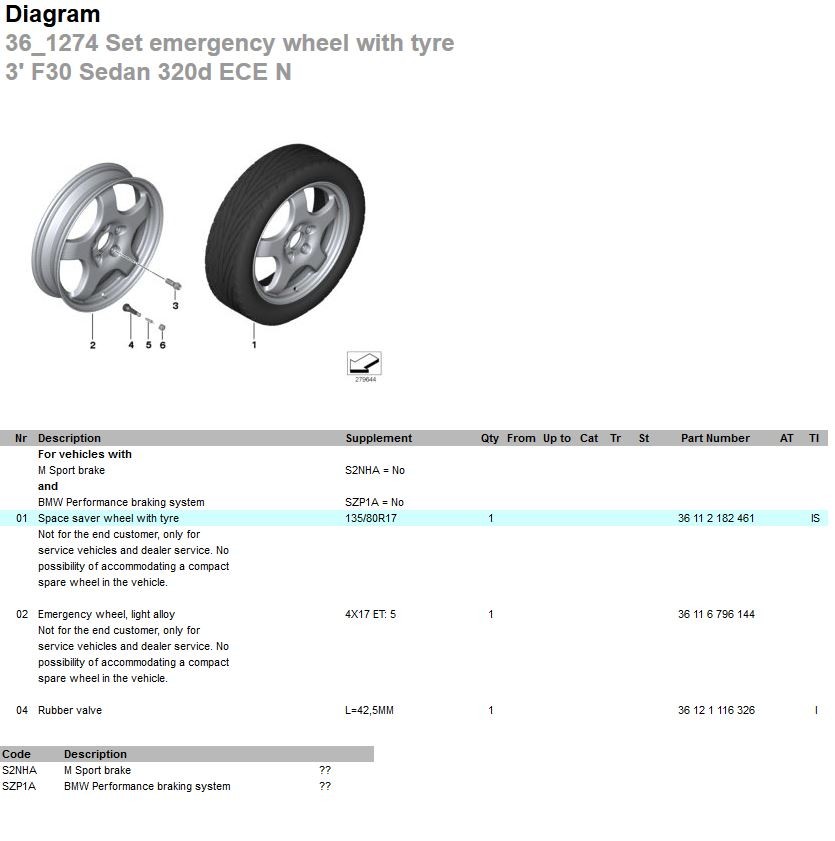

JG_RSA
There is a space saver wheel / kit on the system for the F30.
It doesn't seem to be compatible with cars with the M-Sport brakes though.
Perhaps your car has those and that's why the dealer said that it wasn't available for your car.
