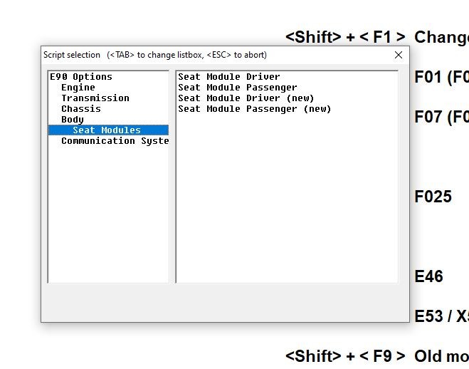

Could be a few things causing this. A reset can be done with INPA, but it could also be wiring or the switches in the driver door itself. My wife's E87 had the same issue. After trying INPA, replacing the switches panel in the driver door solved it for me.

@rudolphc83 how would one go about this inpa reset? My e90 has similar issue, but with the power mirrors.. they adjust with the seat memory setting and the two different keys used, but not with the switch. Replaced the switch with a working one, no difference..

It's been a while since I did that. If memory serves, you can reset the seat modules independently, that should do the trick I think. Three should be a module on your INPA specifically for that. Not sure if there is a module for the mirrors specifically though. Also depends on your version of INPA.
