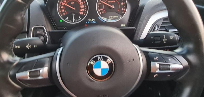

Howitz! Fairly new here. Just trying to find out if there are any local guys supplying, installation and coding of cruise control module?
My 2 series only has the L/M.

Using you VIN verify the parts required and then from there its not that hard. Some installation, coding and you done.
incredimills
Did it on my 2, can be done in 15min without removing the steering wheel and using Bimmercode. Had a post on my intro post showing the coding

U can do the coding with either BimmerCode or Esys.
Drop me a message if you need any assistance.. Can do this either way
