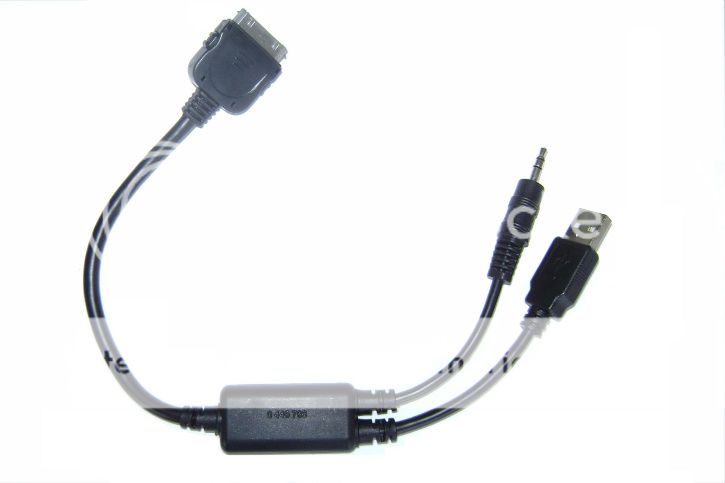

No you wont be able to stream. You also wont be able to plug in an ipod using the standard white cable, you will need a Y cable from bmw. (Quite expensive from a dealer, can be found online for less, but be careful, it has a special decoder inside so it must be bmw compatible) This also means the decoding to analogue takes place in your ipod, instead of by the H/U, reducing sound quality.
Y cable:

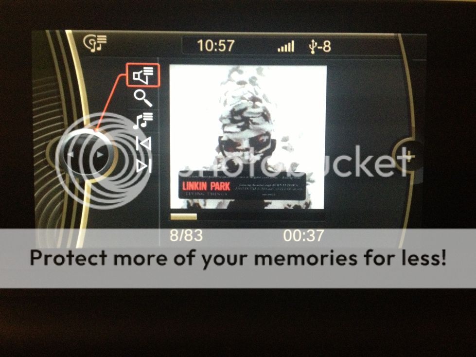

My car has option 6NK, extended bluetooth. So I can fit a cradle to my car to charge my phone and use the external aerial. I can stream music from my phone and I can plug in my ipod directly using its white cable, I get album art on my idrive.
Album art.
