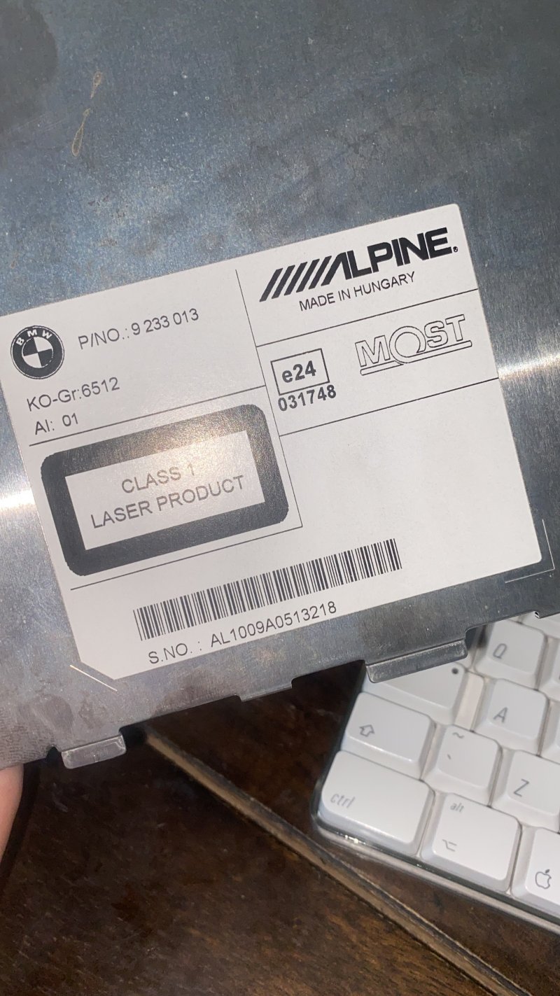

throwfirewoodatme
Ya it's OEM, it's an Alpine and it has this 2GB SD card in there. When I read it, there are files there for maps and speech and vehicle profile. Curious, but true!

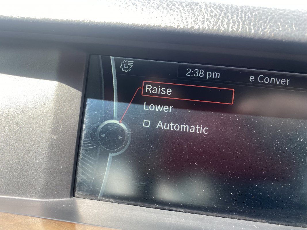

C492497
And if you remove the card, it boots to all features even ones not on this car, including Rolls Royce options.

throwfirewoodatme
Right! Solved. Bought a head unit from a breaker, removed the SD card, put it into my unit, booted up. Boom. All features intact and I can store all memory functions again... but one. Can't save profile names. But that's a small price to pay.
