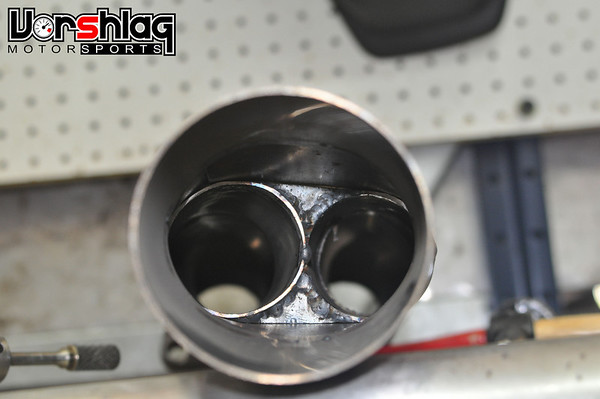

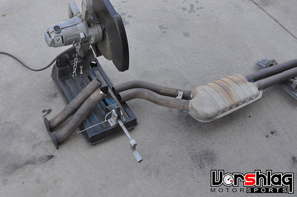

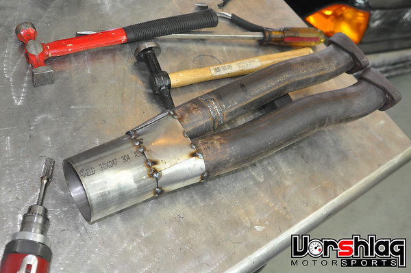

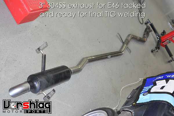

Here is an example
here is the site I got the pics from if anyone is interested

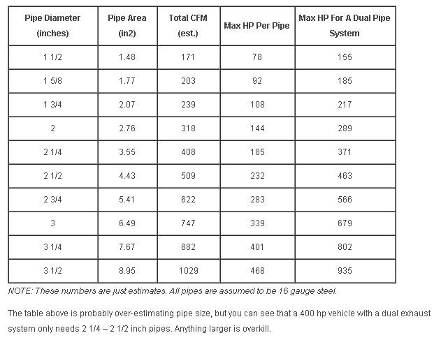

I found this post on the net giving specs for the hp to exhaust sizes
But since I am going to a 3.0l conversion I would like something bigger
