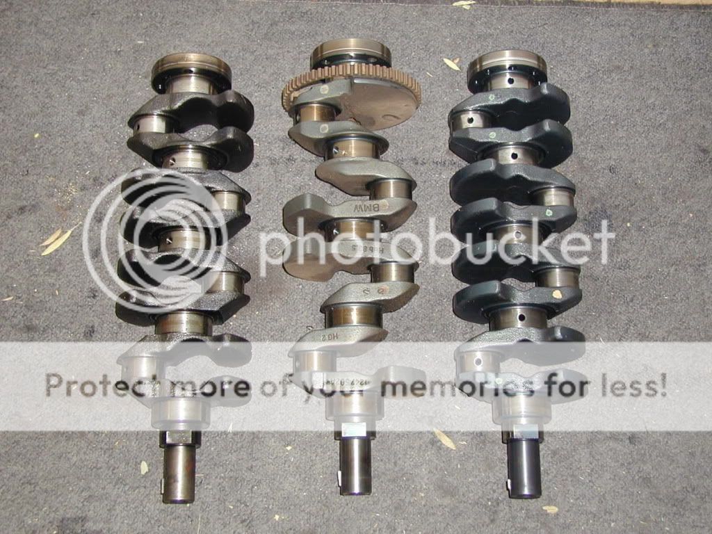

I got this off your thread,the middle is my crank according to this,what gear is that?
Gizmo
Banned
Thats the trigger wheel for the crank sensor, you need the M42 lower timing case with the crank sensor on the front of the crank to make it work on the M44.
Wicked_1
Ah,I understand,thanks,will def be looking into that,but I`ll be getting a second bottom end for the build,maybe a whole motor,so I can keep her on the road as long as possible for the rainy days...
