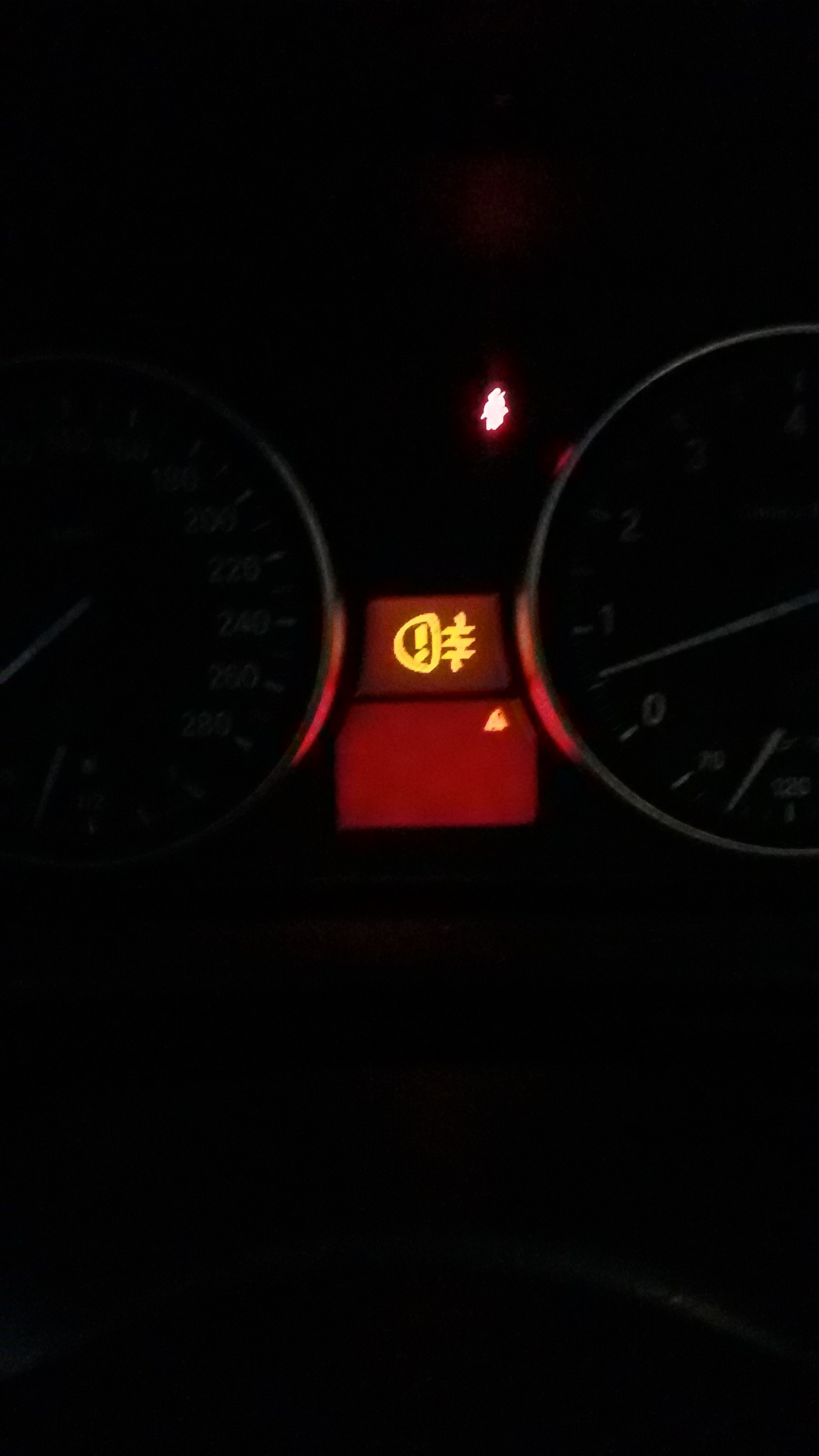

Hi guys,
I received the below error pn the dash yesterday and dont know what it means. I checked all my lights and they seem to be fine unless I missed one.
What does this error mean ?
Spook
I think it has something to do with the auto levelling system on the headlights - I could be wrong.
///GSPEC
I'm not sure if this e92 has auto levelling, When switched on it has never adjusted and i cant find how to adjust the lights, I know my e46 had the adjustments on the side (up and down)
M3KW
That symbol looks like the rear fog light symbol? Maybe a bulb is burnt for your rear fogs?
///GSPEC
Will double check, I think it might be a rear light. It came on yesterday and then went away however today it stayed on. Maybe a loose connection.
M3KW
///GSPEC said:
Possibly a loose connection. I know there is a certain resistance that is needed in order for the computer to register that all is okay. Could be the bulb is not drawing enough current.
///GSPEC
M3KW said:
///GSPEC said:
Thanks,will have a look later. I replaced the number plate lights with LED ones but they had cancellors on.
