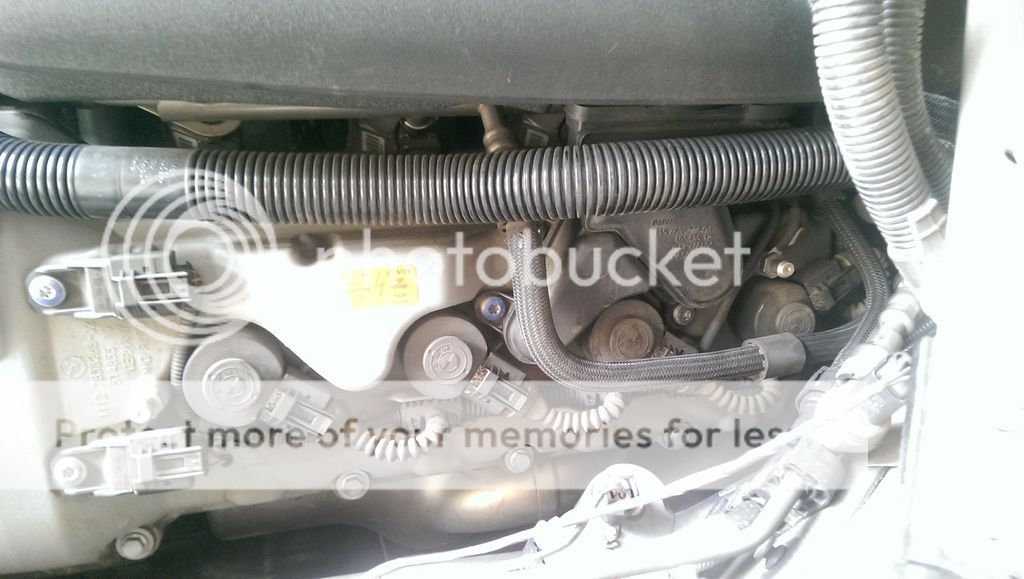

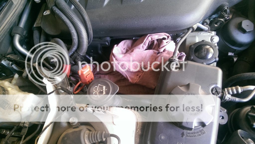

Bank 2 (5,6,7,8) with plug 8 requiring special cursing to extract.
It also requires a good plug socket which is magnetised so that you can extract it.
Bank 1 (1,2,3,4) and somewhere under there is plug 4.
If 8 requires special cuss words 4 requires a sangoma to throw the bones as well as a few chicken sacrifices.
Under all those cables and hoses is plug 4.
Respect to those who have changed their plugs without breaking into a song of profanity and throwing their spanners around the garage in frustration.

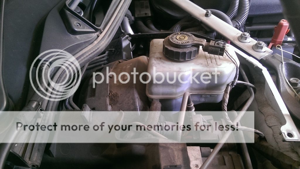

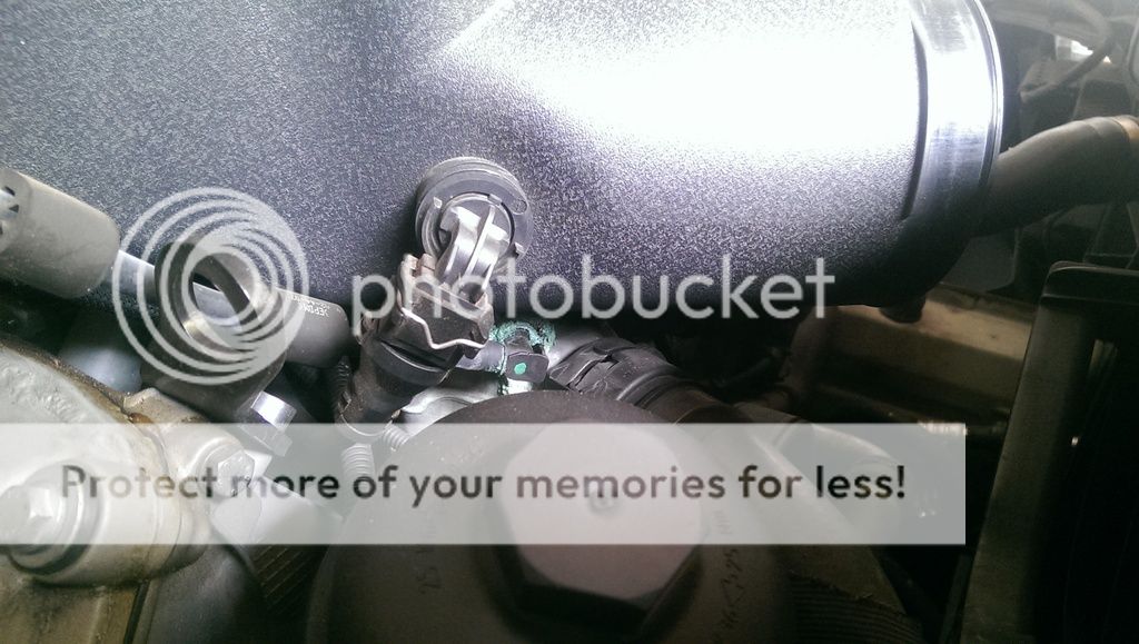

I found this interesting...look how dirty the brake fluid is taking bets that it was charged under mp but as evidenced here whether it was actually done is debatable. I could very well be wrong.
Every v8 I have done has had a leak on the overflow pipe/recirculation pipe.

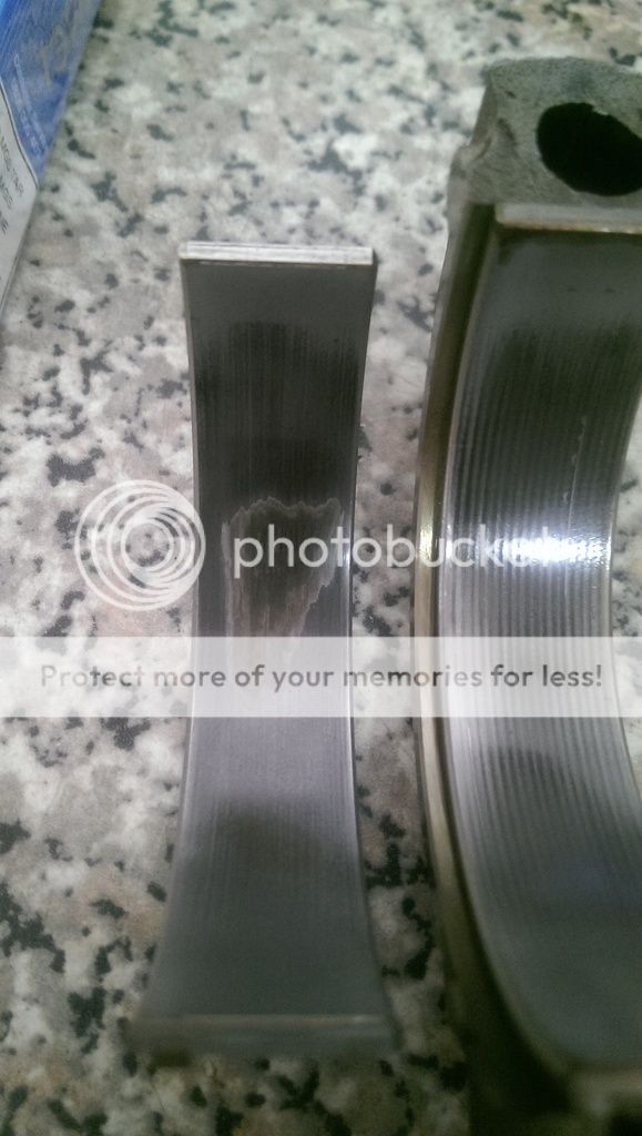

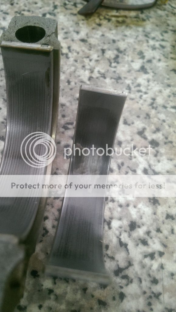

In most cases this is around the 100k km mark. I can add a few random pics of bearing that are in worse condition than this, also in cars with less than 100k km. On one car, the bearings actually broke apart. But I don't want to derail this car's thread.

Below extract from CLEVITE for bearing failure.
In the case of the NA M engines point 4 is the most plausible with the exception of the I6 engines which do suffer from detonation
POSSIBLE CAUSES
1. Overloading (lugging, detonation, or overfueling).
2. Uneven loading
3. Bearing material of inadequate fatigue strength for application.
4. Bearing failure due to surface fatigue can be the result of the normal life span of the bearing being exceeded.
