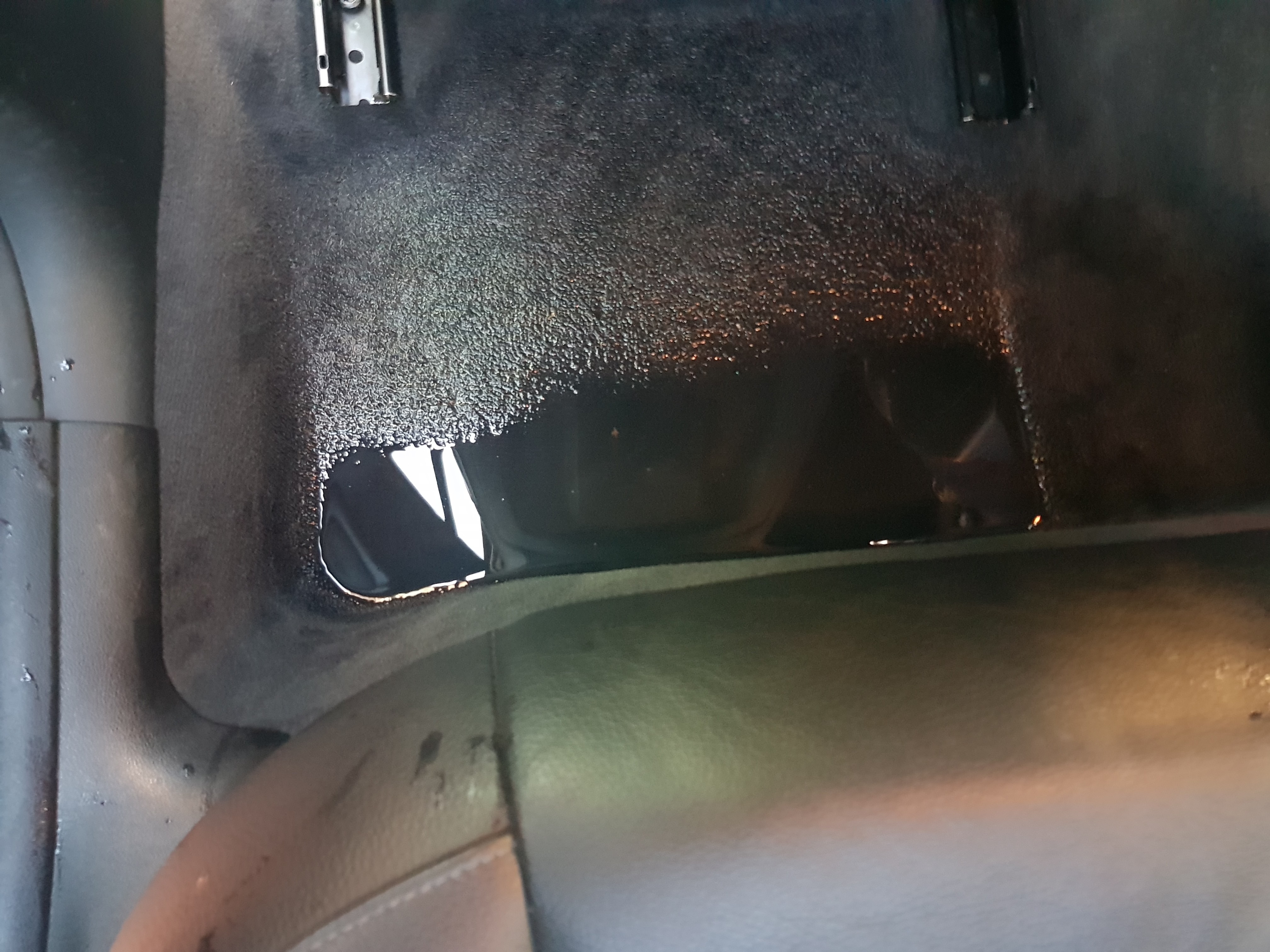

My brothers 2012 E320d developed a leak in the rear passenger side, all doors seals seem fine , but the carper is drenched, anyone experience this?
what can we begin checking?
other forums suggest the seal on the door panel, water coming in from between the window.
Any help will be appreciated.

we inspected again yesterday,
door seals are all dry, it seems as if it coming from the floor, underneath the carpet..

definitley not the doors, as the upper parts of the sides of the carperts are bone dry, had it been doors or sunroof the sides would also been wet.
