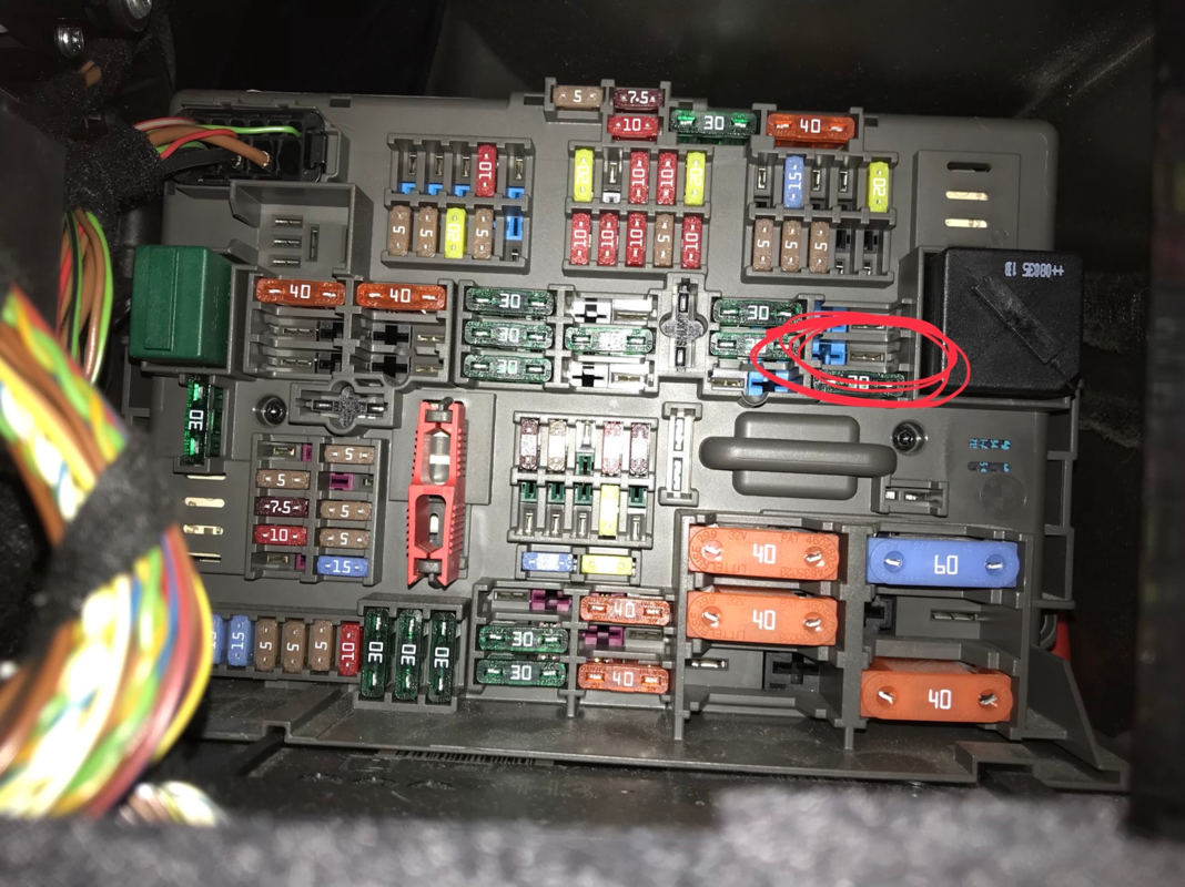

To be honest it was leaking intermittently for a good few months or so….but now the pump does not work 😳 I did have a look at the fuse box that’s situated in the glove compartment & to my surprise there’s no fuse meaning it’s missing. The pump stopped working for about a week now. Strange 🤔
