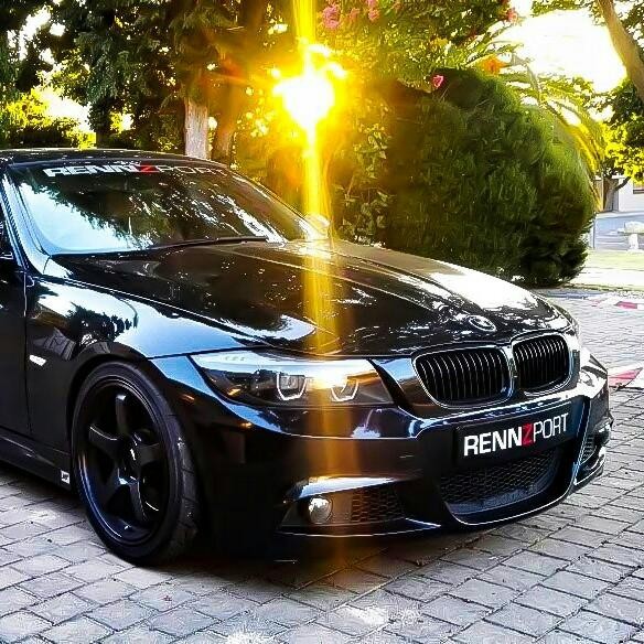

The ray of sunlight is free but the lights will cost you. :smilebounce:
I am running normal phillips halogen pure white bulbs. I was considering a buld that changes colour for low beam beause it looks awesome when the low beam is on...but then again the "park" day light driving are bright during the day and draws enough attention for such an old car.
