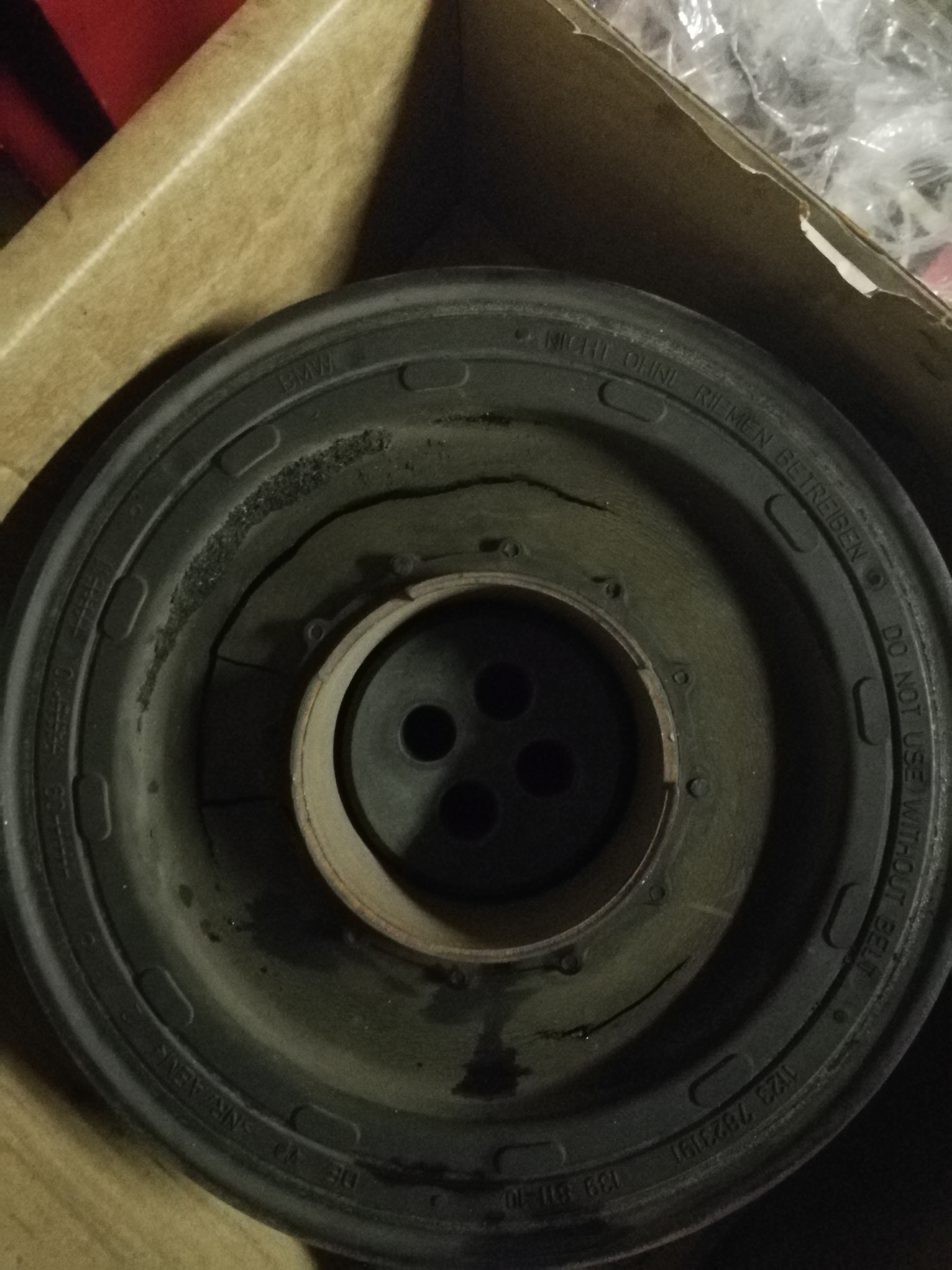

Hi Fanatics,
So I'm going to need to do my damper pulley, this is mine : https://photos.app.goo.gl/jmS1DOi5rGOzsP5o1
So I've read most of the threads on this and there's a few questions I still had :
1. Does the tensioner and idler also need to be replaced or should I assess this on how they running after removing the belt and damper pulley ?
2. Goldwagen Edenvale indicated that they (and BMW) would require the alternator pulley to be changed at the same time in order for the warranty to be held on the damper pulley, has anyone else had to do this? Any idea on the cost? Sales rep at Goldwagen couldn't find it on their system BTW I have the 130kw N47 version of the LCI.
Thanks for the help as, always fanatics
Riaad

Just had this done on my dads x1 2.0d 2 weeks ago,
I was advised just to replace the damper pulley with the four bolts that hold it along with the serpentine belt. First that I am hearing of the alternator pulley, however the vehicle is not under any warranty.
Anyway, sourced a replacement pulley from Goldwagen (half the price of BMW who had no stock and the pulley was cracked much more than the pic above). Got the belt and four bolts from BMW for just under R1100. Labour was R950 to fit...took the guys just over an hour to complete the works...
Hope this helps:thumbs:
DieselFan
I've only ever replace the pulley and the bolts. On every e90 diesel I've owned the pull has given in around 120k to 140k kms
Fuzz123
I did mine 4 weeks ago also with GW pulley, 4 new bolts from BMW and I took the time to replace the tensioner, idler and V-belt while everything was off. No one said anything about changing the aircon pulley.
Not such a bad job you just need a tool to hold the pulley while you torque the bolt.
:thumbs:

on point 1 nope not required but a good time to do it.
On point 2 Tell the guy from Goldwagen and Bmw that there mothers alternator pulleys need to be changed.

I had inspected the engine when it hit 100k kms... First thing i checked was the damper pulley and i noticed two fine cracks... Sourced the parts and had it replaced in the same week... The vehicle was still in use... But was very cautious... By the time it was replaced... The cracks had extended to the outer edge probably would not have lasted another day or two:fencelook:

Mine happened on the road towing my caravan. Aircon stopped working and i thought it might have run low on gas but when i got home noticed the aircon belt lying on the sump guard. Then realized the dampener pulley was shot but still on the crank but wob[/u]bling. Quite a relief to have the aircon back to functioning again after replacing the dampener pulley (this was in Jan last year - car in question 2005 2ld X3 manual - kms was about 170k kms) Must add that before this happened i had been hearing a funny clicking/knocking sound coming from under the hood but i could not determine the origin of the noise.
