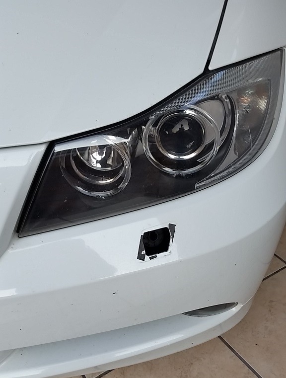

hi guys, so i recently discovered my headlight washer cover has fallen off
upon inspecting the washer nozzle, it seems that there is another piece that attaches to the cover, that has broken off, so i would need to replace the complete washer nozzle and cover.
phoned a few scrapyards but no one seems to have the washer nozzle.
does anyone know where i can find one second hand?
also can anyone advise if the washer nozzle can be replaced without removing the front bumper? any help would be appreciated.
Ratslaaf
You can't replace the washer unit without removing the bumper. Getting the bumper off isn't hard, you simply remove 10334226 screws and it comes right off :)
Those covers don't just fall off though. The cover actually has two legs sticking out that clips over the nozzle assembly and they are firmly clamped to the assembly. Someone must've stolen it to be honest.
Your first step would be to get a white cover from a scrappy. I'm pretty sure it's all that's missing.
