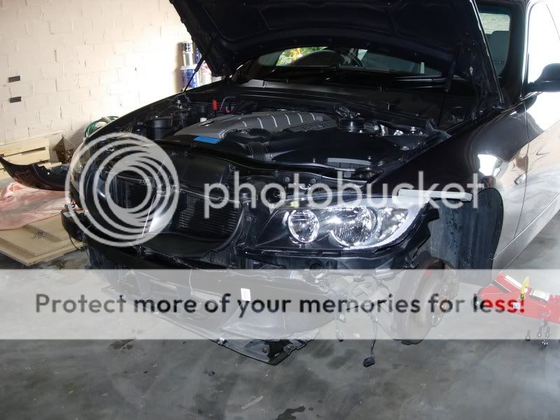

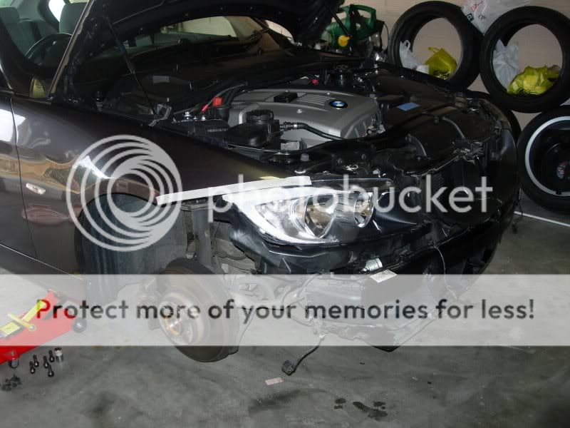

Loosened the various screws holding the front bumper, jacked the car up, removed the forward inner wheel well liners, disconnected the fog lights and outer PDC sensors, and then gently removed the bumper, disconnecting the inner PDC sensors as it came away. Unclipped all of the PDC sensors from the bumper and removed the fog lights and other trim pieces, kidney grills - took the bumper through to Brighton Body & Spray (recommended by Mike) to repair and respray the bumper. Total cost worked out to R2400 which is far less than the repair costs of both the other places! Bumper went in on Wednesday morning and got it back on Friday afternoon!

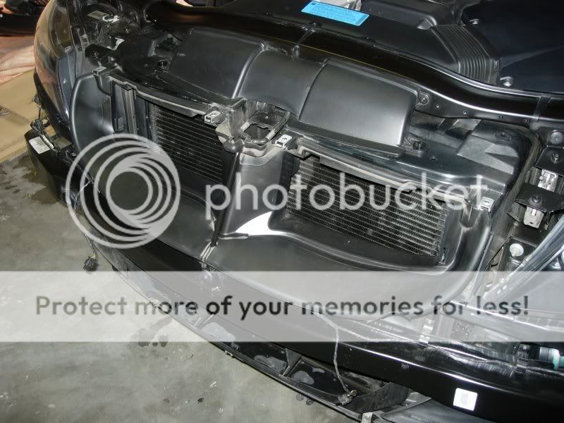

This morning took the forward wheel well liners outside and gave them as good a clean as I could, so they do look better, but will need to spend more time on this, so decided to rather leave that for a later time and clean some other areas on the car before fitting the bumper. Nothing major, just cleaned behind the kidney grills and some of the areas usually covered by the bumper.

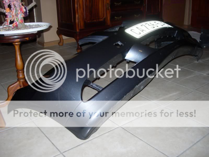

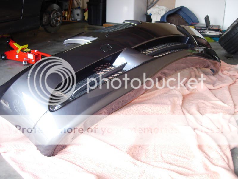

Here is what the bumper looked like before being repaired! Still have no idea how that left corner got hurt!

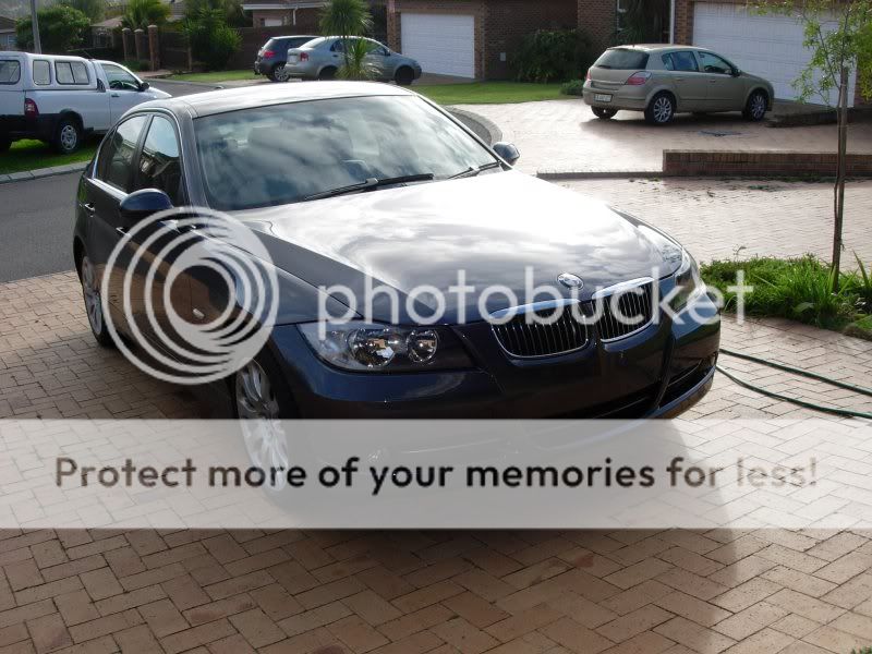

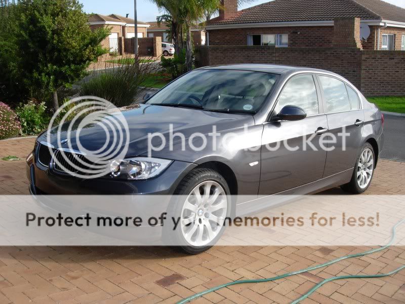

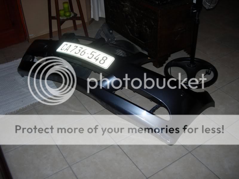

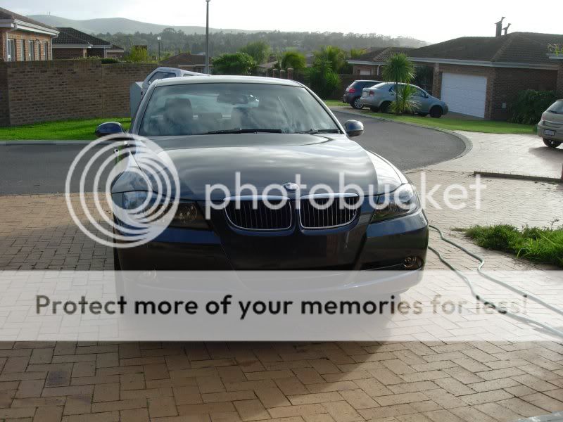

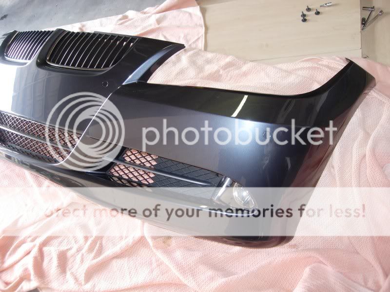

Fixed bumper being fitted - they seem to have been able to match the paint quite well! The tow point cover was was not painted, maybe not the best plan, but thought I would use this to check the paint finish when collecting, so ever so slightly different metallic and shade, but could also be that I need to properly polish the cover and then it's match. But fitted on the car it seems to be spot on!
So very happy with the results! And no errors on the cluster, PDC works properly etc! Just sprayed the car off after fitting - not going to wash for at least a few days. Maybe next month or so is time for some TLC with some of my polishing goodies!
