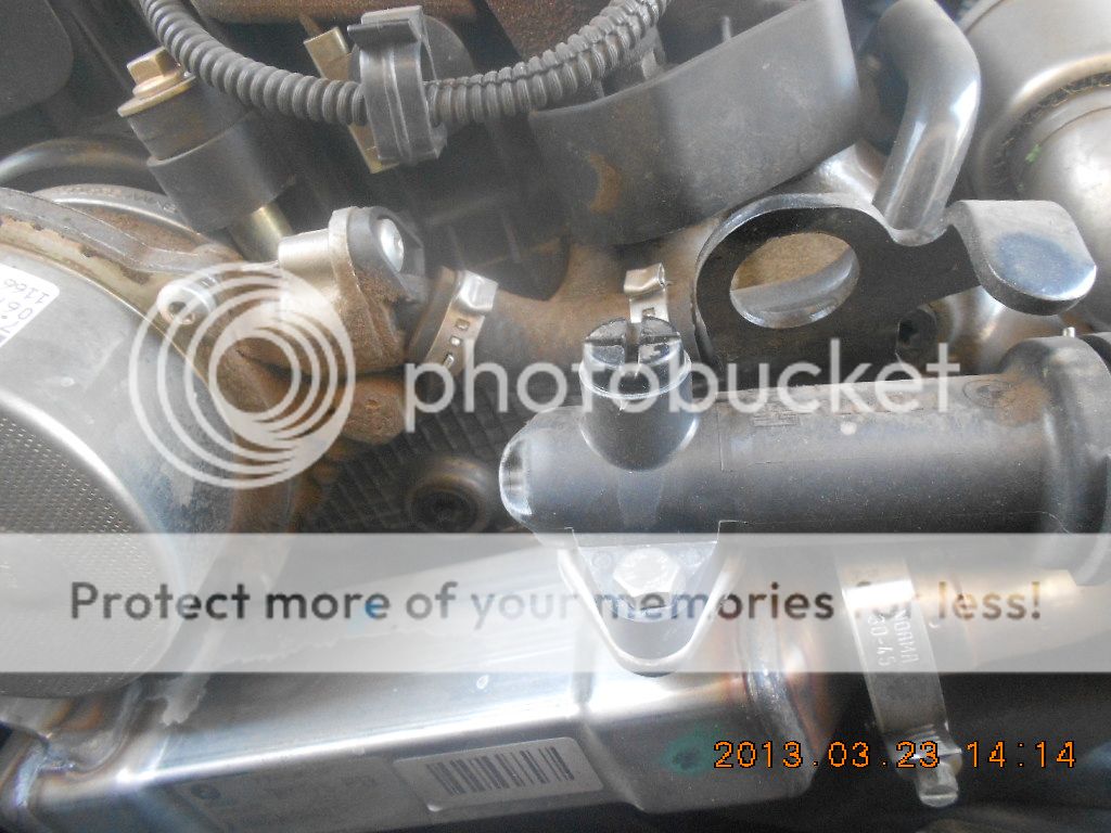

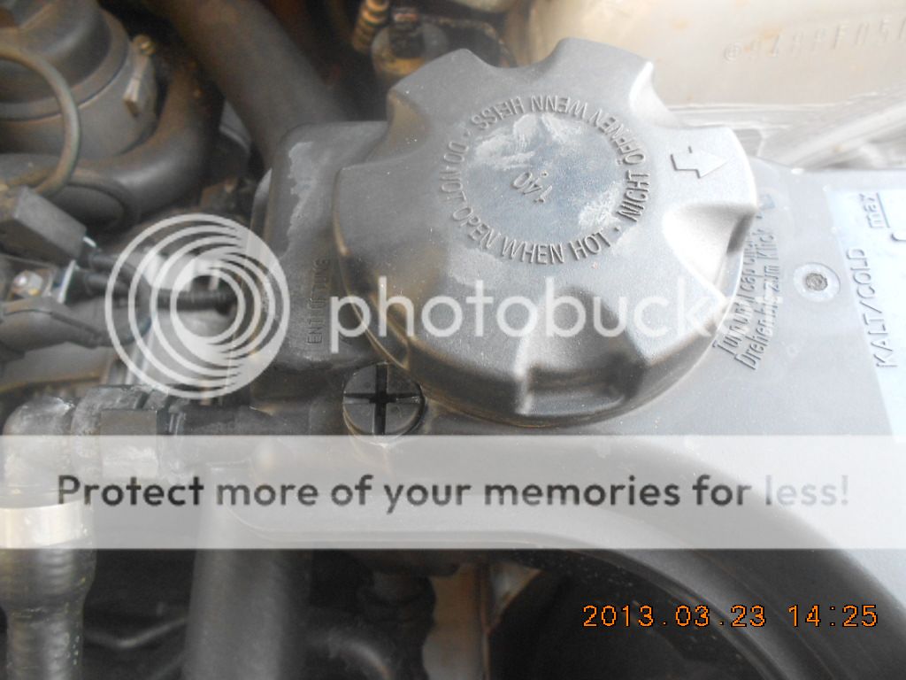

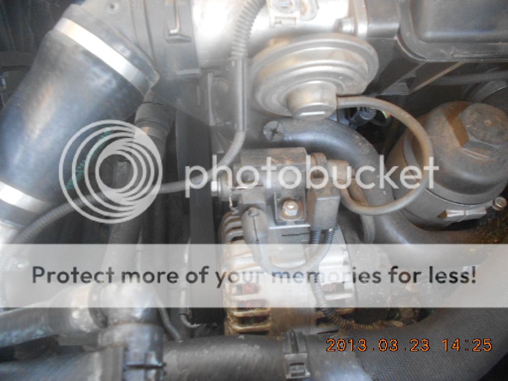

So I filled up the reservoir and bleeded the system inspected all the pipes for any leaks of water. i then noticed another Bleed screw :argh::nonono: ai jai jai so to confirm the E90 320d 2007 has three Bleed screws.
1) situated on the reservoir
2) situated on top of the Thermostat housing
3) one situated on top of a pipe directly above the alternator.
So i Bleeded the system and confirmed no air bubbles out of all three Bleed screws. closed all Bleed screws made sure not to tight as they are plastic and brakes or cracks easily.

So to confirm that the E90 320d has in fact got three bleed screws and not like previously indicated in other threads no Bleed screws.
I will update the thread with pictures later during the day.
