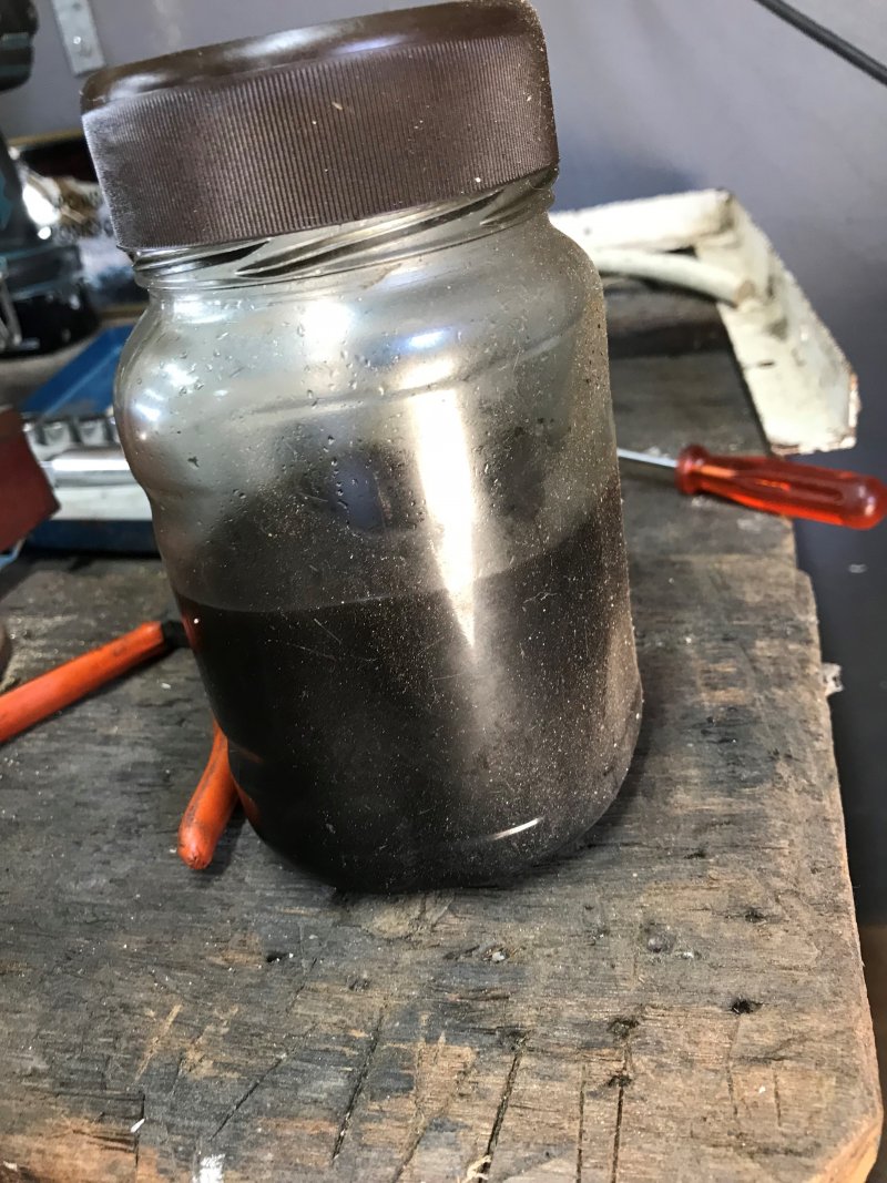

Solo Man
I think that the brake fluid flush is the answer as this is probably the most neglected item on a car that people tend not to think about doing. Have flushed some brakes that look like coke came out of the flush!

Wow, well, I opened the filler bottle and the brake fluid looks like old engine oil, very thick and brown
Thanks for the advice will get the fluid changed and report back
