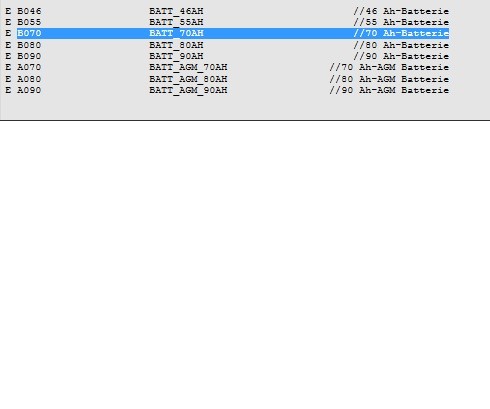

Going to phone Bosch now. I also noticed that my car's vin (coding method :rollsmile:) has the -B070 in it which is for a standard black battery but I have a white OEM battery 80ah 640CCA in my car, so the idiot :RedNo: before me didn't register the battery to the car and made matters worse for me. The vin should read -A080 and not -B070, hope my alternator didn't get damaged during this :tiptoe:
