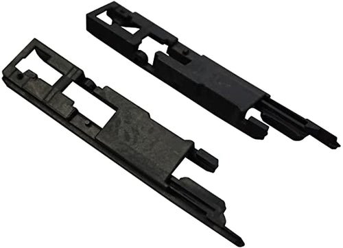

So i am having an issue on my daughter 2009 X3.
The sunshade for the sunroof clips have broken. which has jammed up the rear sun shade.
The clips are called sun shade runner clips. Large black clip. I believe the X5 X3 have the same clips.
So where do i find them at a decent price. I can import them but the review on them is not to good.

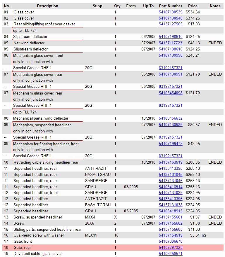

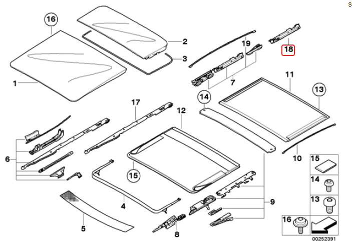

I can see many individual parts for the E83 sunroof mechanism on realoem. Looks like nr 18 are the ones you need? If so, just order from the dealer with the correct part number.

The part i require comes in the no:9 package.
