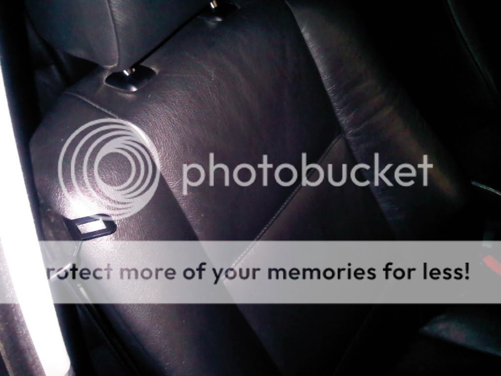

All of the leather is in this condition.

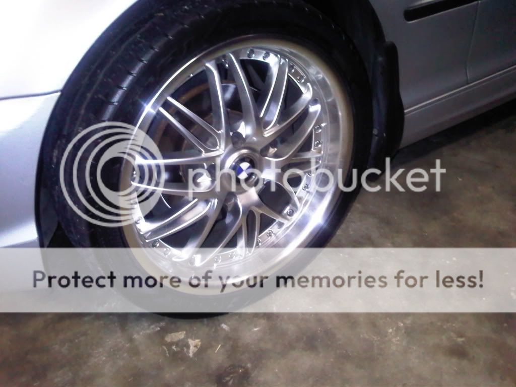

This is not an OEM rim is it ? (18 Inch)

Those wheels are not OEM.

Congrats, looks lovely and very clean:thumbsup: Your wife is a very lucky lady, that e46 will knock the Golf into a cocked hat. Agree, the wheels are not OEM. You clever little boy, get the wife a 318...and yourself a M5!!! Congrats to both of you on your new cars, great choices:clap:
