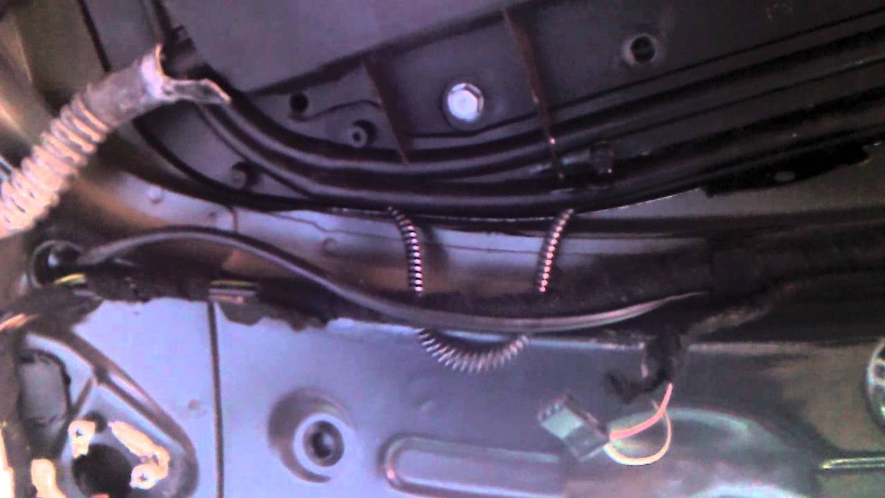

Dewald Basson
Remove your vanity mirror lights if your see threaded cabling stop using the sunroof, and pm me. I will send you some pics of how I fixed mine.
The cable dislodges from it's track like so.
If you hear a clunking grinding noise that is your sunroof motor gear stop, if that strips you must replace the whole motor, 6000 bucks.

Yes but you have strip a hell of lot of parts to get sunroof cassette out. But it is a DIY kinda of a job. I used two bolts to keep the tread in it track.
