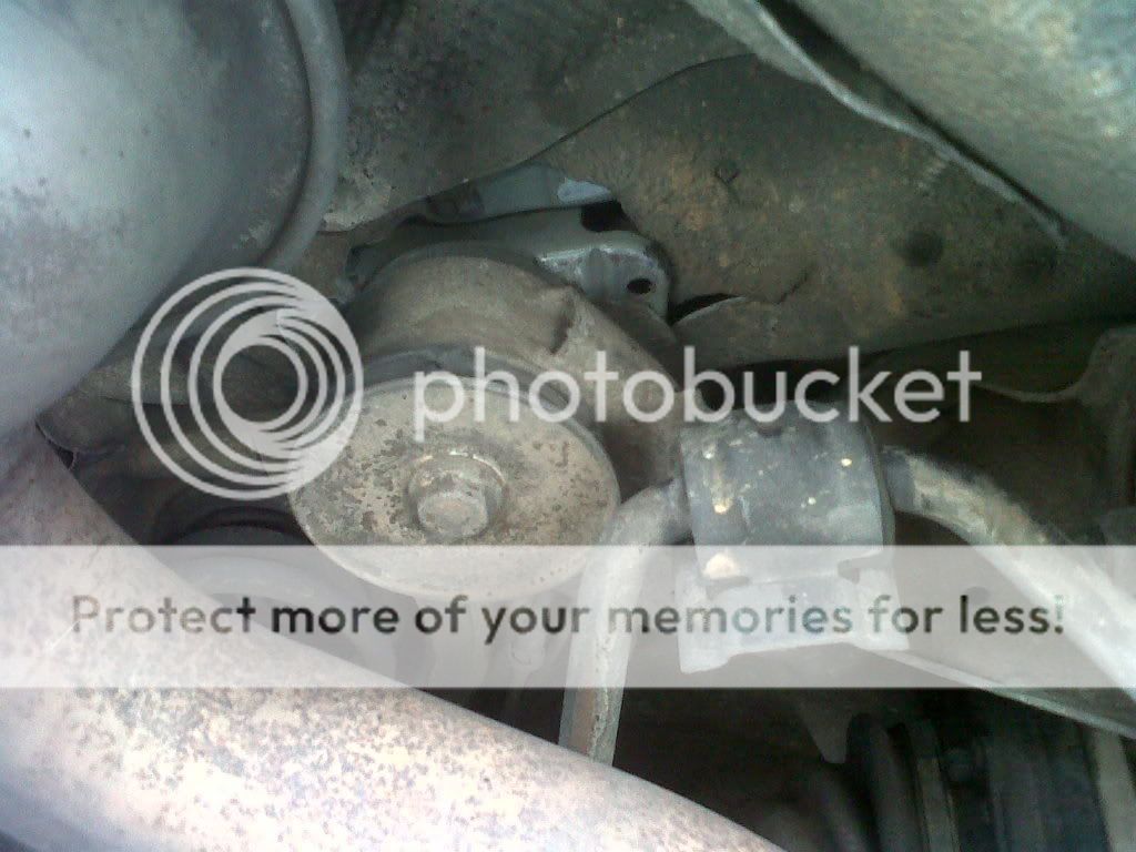

moranor@axis
given enough time im guessing and hard launches Im guessing a 318i will also get cracks seeing as generally someone that buys a 318i wont be interested in doing that i dont think its very common...
this is what the subframe mount look like look for cracks coming from under the rubber mount...

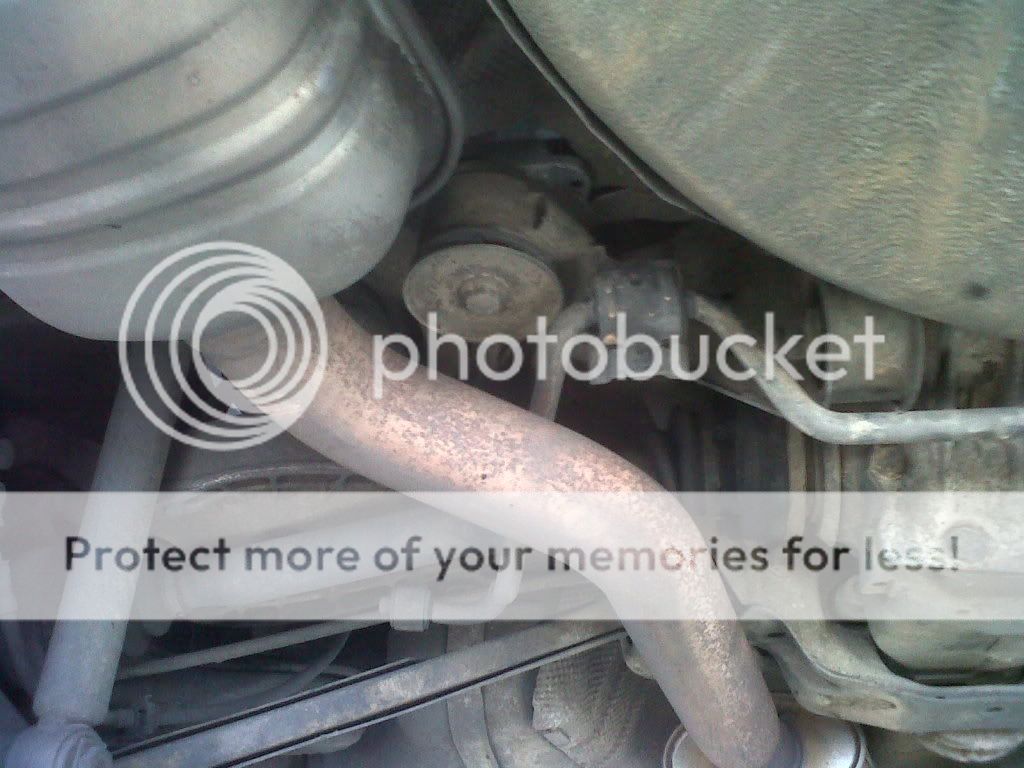

hopefully you dont find this :rollsmile:
images
its really easy to see the cracks with the left side wheel off... you can crawl under the car if you dont want to do that just bring some light with you so you can see whats going on...
