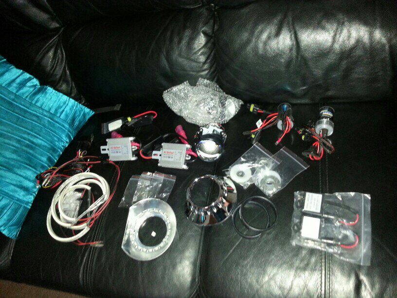

So I have been tempted to fit xenons to the 330 for a while, so last week I ordered the kit vrom vsomai, must say the guy is a real help and stays awake late until I get everything done. Couldn't have done it without his assistance.
Here are the goodies.
So after starting to fit them to the lights I noticed that the shrouds wasn't fitting nicely, somai then nicely offered to do the modding on the shrouds for me, I also decided to go the quad xenon route after I realized the outer are still going to be yellow halogens, he stayed up after 2300 to mod the shrouds for me to send the next day.
While the headlights were apart, I decided to black out all the silver with some of the plastidip I bought from executer.

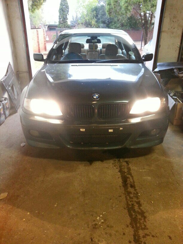

Here is a pic with old lights, when I reversed the car out to take a pic and remove headlights the radiators bleed screw popped out, replaced that the next day.
All that I need to still do is to code the car to xenons, will take some pics tonight of the headlights.

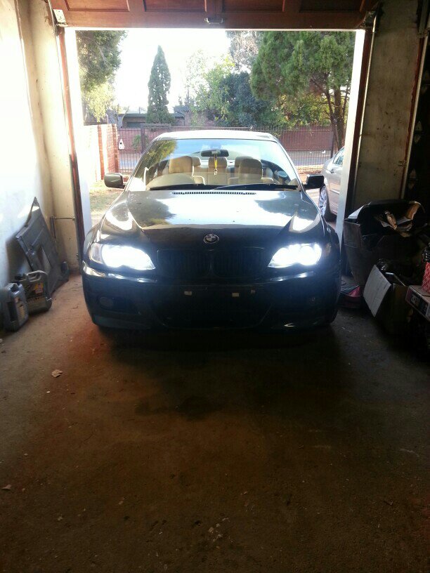

Yeah they are super bright, all 4 act as lowbeam and highbeam. Currently its showing that my headlights are fused, the outers have error cancelling on, but the inners have a harnass that taps into the rhs lowbeam source. So apparently I have to code it that those errors dont appear, plus the inners dont come on all the time, sometimes its both, sometimes one or the other.
Here is some pics
Only angel eyes on

So everything is sorted and coded. Once again vsomai went ouy of his way helping me and really was a great guy to deal with, always available and super helpfull. These lights are beyond amazing, there is no need to even use the highs on the xenons, also the angel eyes looks superb, especially if you unlock the car and they come on at a low beam state. Just looks like you've unwoken a beast :p at the price I recommend this to everyone!!
Will take some more pics of it at night to show cut off
