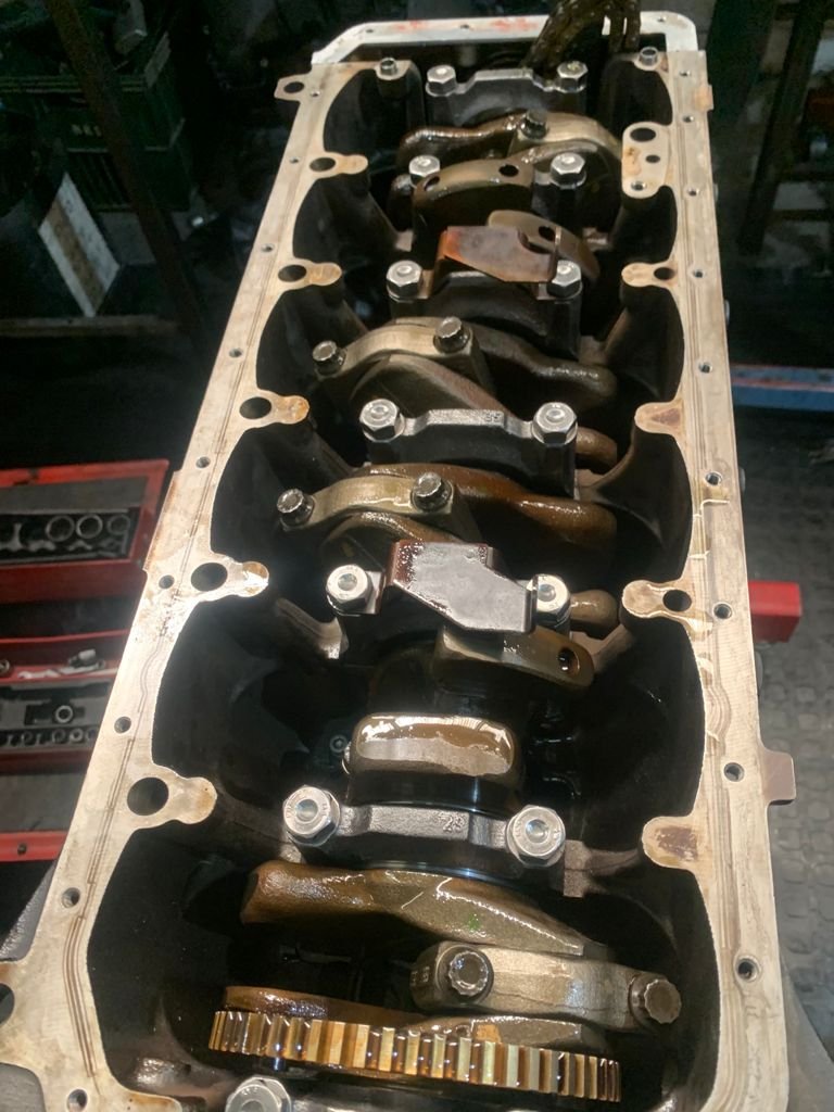

Peter@AEW

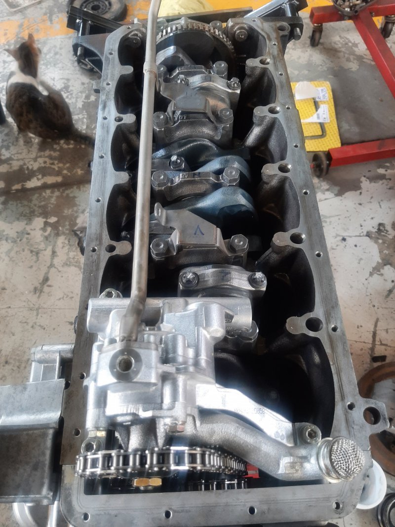

If the engine bolts are not worth cleaning what else has not been cleaned prior to assembly or during assembly?
When building an engine "clean" and "attention to detail" is paramount.
Main caps bolts are being re used and should be new as they are stretch bolts and once used they should not be re used.
Guide rail has been left dirty.

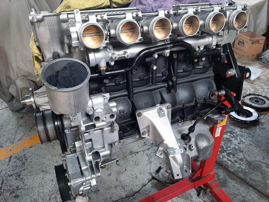

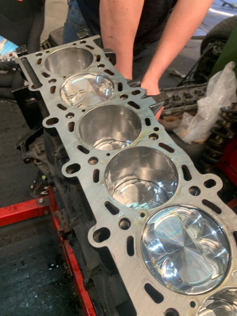

Peter@AEW
Haxor's engine after complete overhaul.

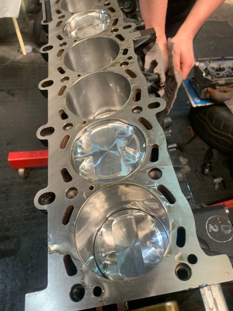

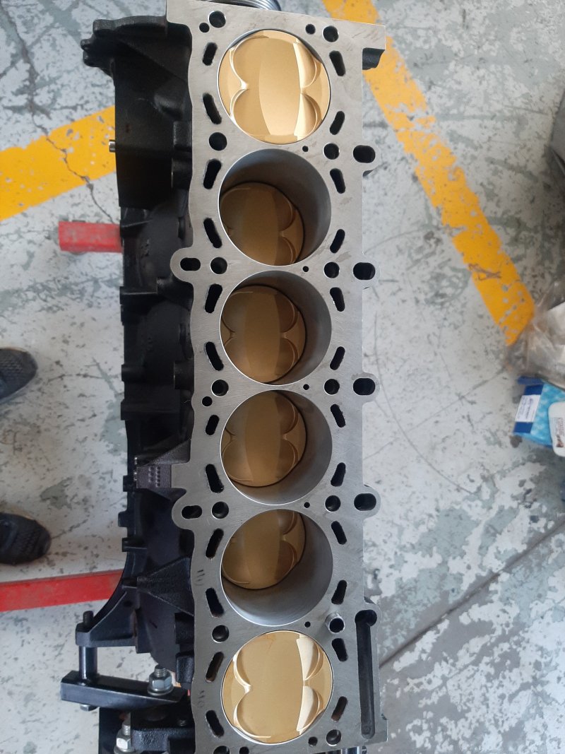

My e46 M3 S54 is rebored to 87.5mm. Vac Motorsports recommends this bore is done with a Torque plate as it ensures perfectly cylindrical cylinder walls as the OEM bores from BMW are mass produced and are said to not be 100% round from factory. Fine for street use, but not for race teams. This is the reason for the overbore. All major race teams that run their S54 engines NA use 87.5mm overbore. For street use it is perfectly safe and drives like stock. You may find a slight increase in low down torque but power numbers are roughly the same. I have ran this bore for over 10 years.
Regarding SAVSPEED, I would never send my car there again after the balls up they did on my engine when it went in for valve clearances and a cam change. A retainer clip was not put back and the car dropped a valve 2 days later, thus resulting in a complete rebuild of my engine. SAVSPEED refused to take responsibility for the work as the camshaft was not sourced by them and instead delivered by me, thus putting blame on the camshaft. Again, a retainer clip was missing when we opened the head.
Furthermore, I still run this camshaft in my car 10 years later, so clearly, it wasn't the camshaft. Do what you will with this information.
